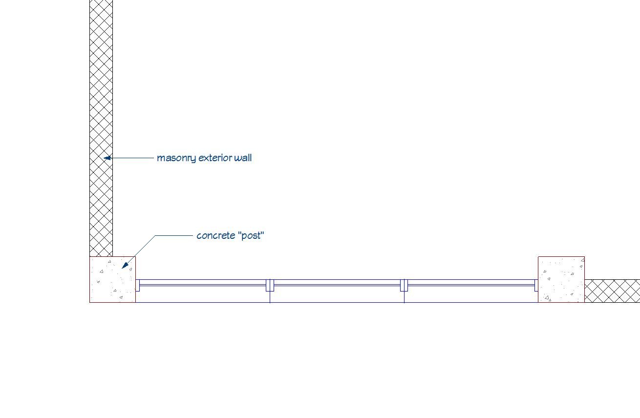

rlackore Posted November 4, 2025 Share Posted November 4, 2025 Chief Architect isn't well suited to RC structures with restrained masonry, so you will have to make some compromises. However, unless you need to show the RC structure and the infill in 3 dimensions, like your attached image, then I suggest setting up your floor and foundation defaults for the horizontal concrete elements, and your exterior wall types (with exterior cladding and interior finish) for the masonry portions. Show the vertical concrete elements in plan view by using concrete "posts" or by using a CAD object, and adjust your building sections, etc., with CAD objects. But, if you HAVE to show the 3D, it can be done by not including the exterior materials in your wall definitions: 2 Link to comment Share on other sites More sharing options...

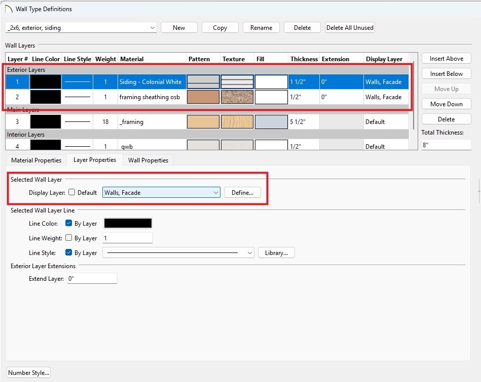

rlackore Posted November 6, 2025 Share Posted November 6, 2025 Another thought. With the new wall definition tools in X17, when you build your wall definitions, assign the "exterior" and "interior" wall layers to unique display layers, like this: Here I assigned the Exterior Layers to Walls, Facade; then is any 3D view simply turn off the Walls, Facade layer and you will see what is underneath, such as the wall framing, or the restrained masonry infill, or whatever. 1 Link to comment Share on other sites More sharing options...
