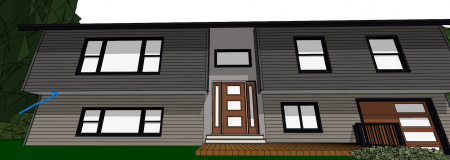

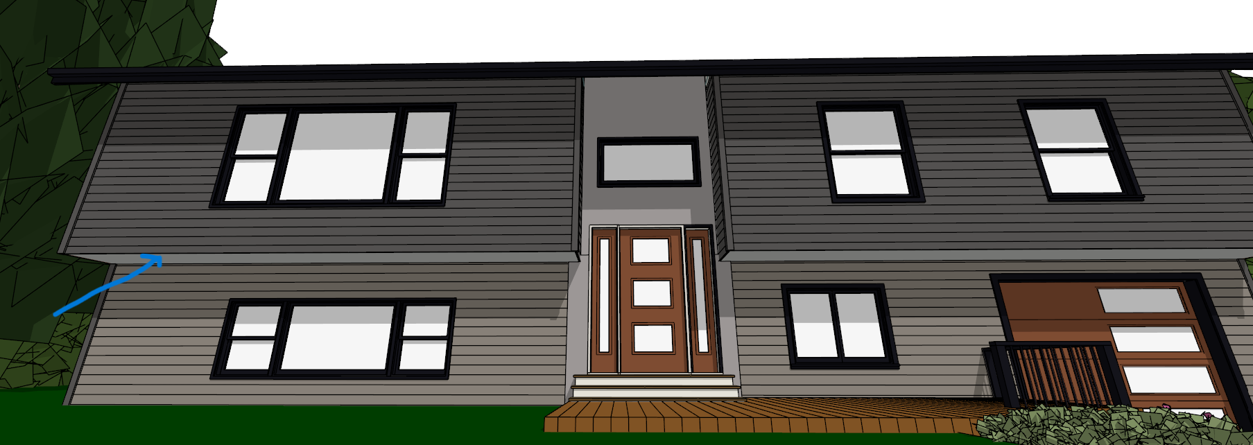

decorators3 Posted October 30, 2025 Share Posted October 30, 2025 Hi I am attaching a vector view of a house I'm working on for new exterior, How can I get recessed lights in the bump overhang because its the underside of the first floor bump out and cant install lights in the floor Cheers Levina Link to comment Share on other sites More sharing options...
DBCooper Posted October 30, 2025 Share Posted October 30, 2025 Try placing them on the ceiling inside a room on the first floor and then dragging them outside under the overhang. You might also need to adjust the height offset so that they sit where you want them. Link to comment Share on other sites More sharing options...
decorators3 Posted October 30, 2025 Author Share Posted October 30, 2025 Thanks! it worked Link to comment Share on other sites More sharing options...
