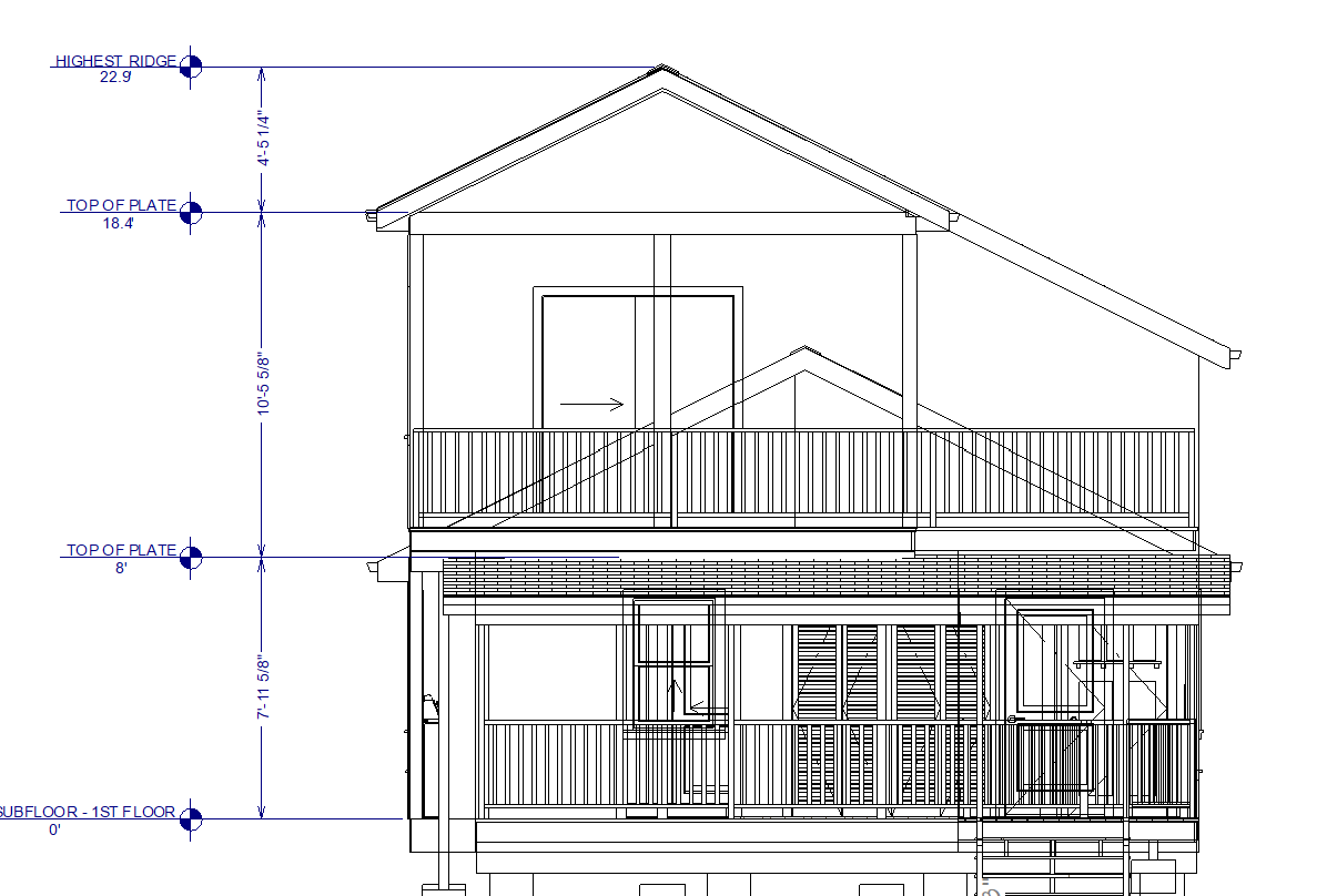

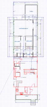

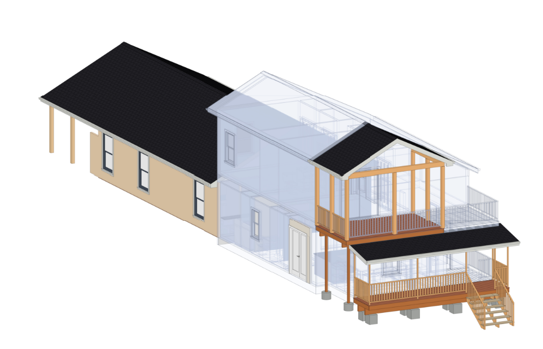

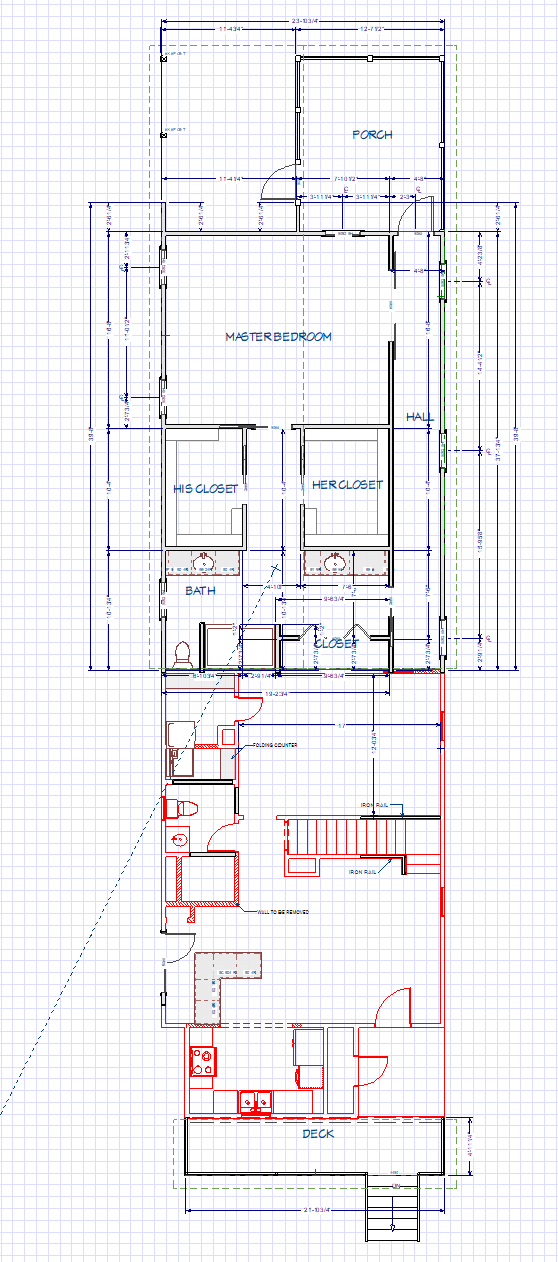

JonHarrah Posted October 29, 2025 Share Posted October 29, 2025 (edited) Hello everyone, I have a question Is there a way to show the as-built reference file in the elevations? I can get them to show in the floor plan and 3-d camera, but not in the section and elevations. Red is the referenced as-built, but not showing in the elevation. Any work around or am I just missing something. Thanks. KNAPSCHAEFER ADDITION.plan Edited October 29, 2025 by JonHarrah ADD PLAN FILE Link to comment Share on other sites More sharing options...

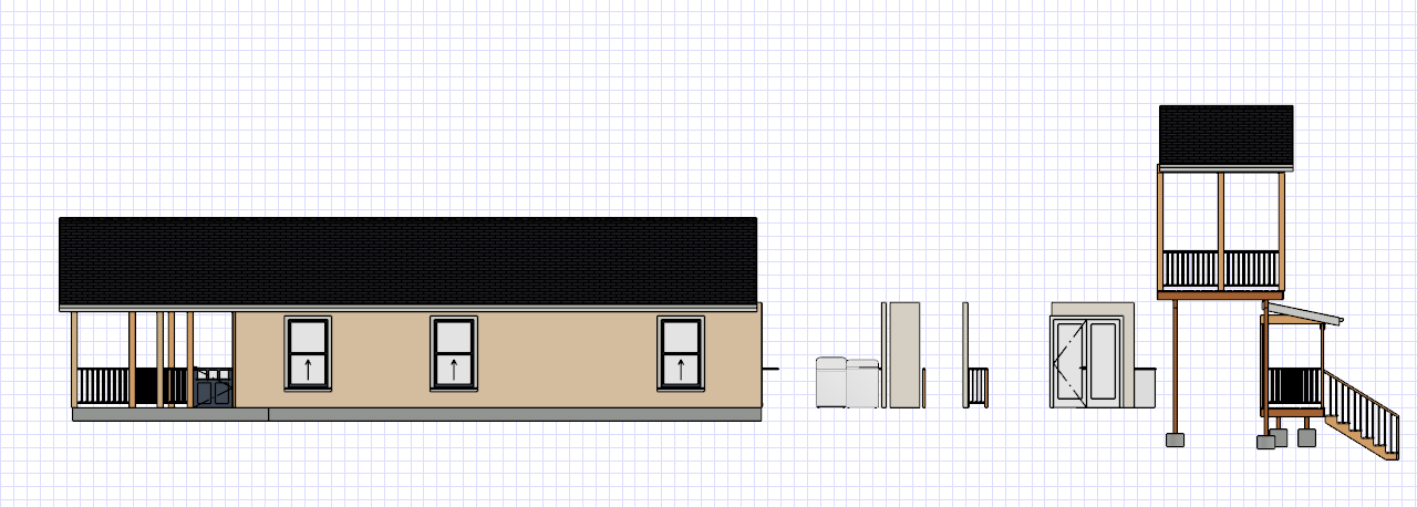

JonHarrah Posted November 2, 2025 Author Share Posted November 2, 2025 So i sent from the as-built and the renovation plan to the layout but they are transparent. How do I work around this. Link to comment Share on other sites More sharing options...
