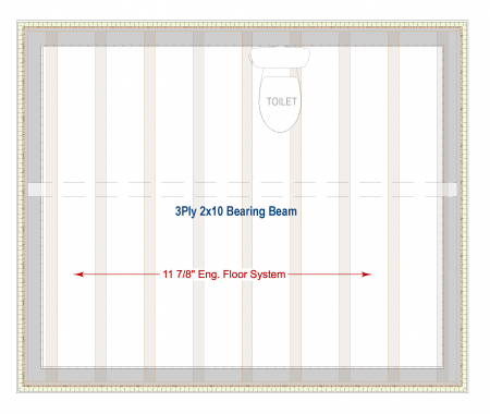

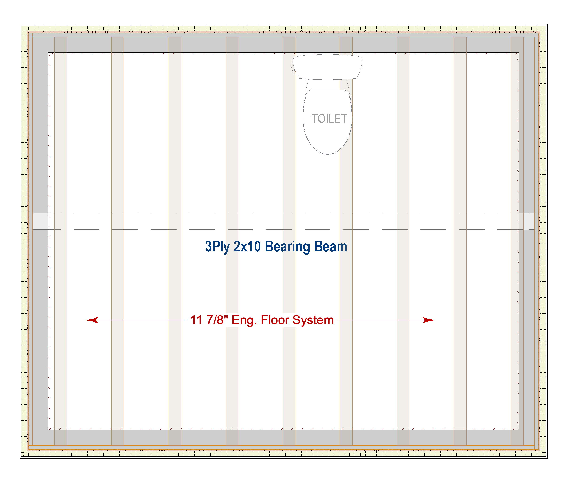

PitMan71 Posted 15 hours ago Share Posted 15 hours ago Try bringing the beam to the same stack level as Joists (17). Link to comment Share on other sites More sharing options...
GeneDavis Posted 8 minutes ago Share Posted 8 minutes ago It's not doable in Chief, so I uncheck label in the beam's DB and write a label manually. For me there aren't that many beams in a floor plan, and I like to add "FLUSH" or "DROPPED" in the label. Link to comment Share on other sites More sharing options...
