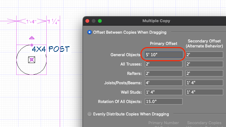

Ringos Posted October 21, 2025 Author Share Posted October 21, 2025 Can you select two objects and copy multiple while dragging over a specified oc? Link to comment Share on other sites More sharing options...
Chrisb222 Posted October 21, 2025 Share Posted October 21, 2025 On 10/20/2025 at 8:59 AM, Ringos said: When I select the footer and post can I place them spread out evenly with multiple copy? Yes. On 10/20/2025 at 8:59 AM, Ringos said: If I place 13 and try to distribute evenly, it separates the post and footer and distributes 26 objects evenly. Before making copies, Block the post and footer together using the Make CAD Block tool. Select both and hit this button in the lower Edit toolbar: Then make your copies and use the Align/Distribute Objects tool to evenly space them. 1 hour ago, Ringos said: Can you select two objects and copy multiple while dragging over a specified oc? Yes, after you hit Multiple Copy, click the Multiple Copy Interval button and enter your interval value: Link to comment Share on other sites More sharing options...
