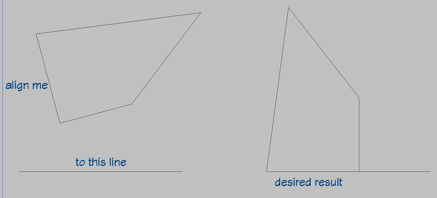

jorgearaya Posted October 9, 2025 Share Posted October 9, 2025 Looking for TIPS on how to align polylines or objects to other objects or angles. Not single objects like "make parallel" but the entire polyline whether it is closed or not. Please and thank you, Link to comment Share on other sites More sharing options...

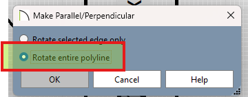

robdyck Posted October 9, 2025 Share Posted October 9, 2025 The 'make parallel' tool is really the simplest option. First rotate the polyline so the desired edge is close to parallel with the intended object. Then, click on the desired edge, then double-click the 'make parallel tool and select this option: Then click on the target object. 1 Link to comment Share on other sites More sharing options...
