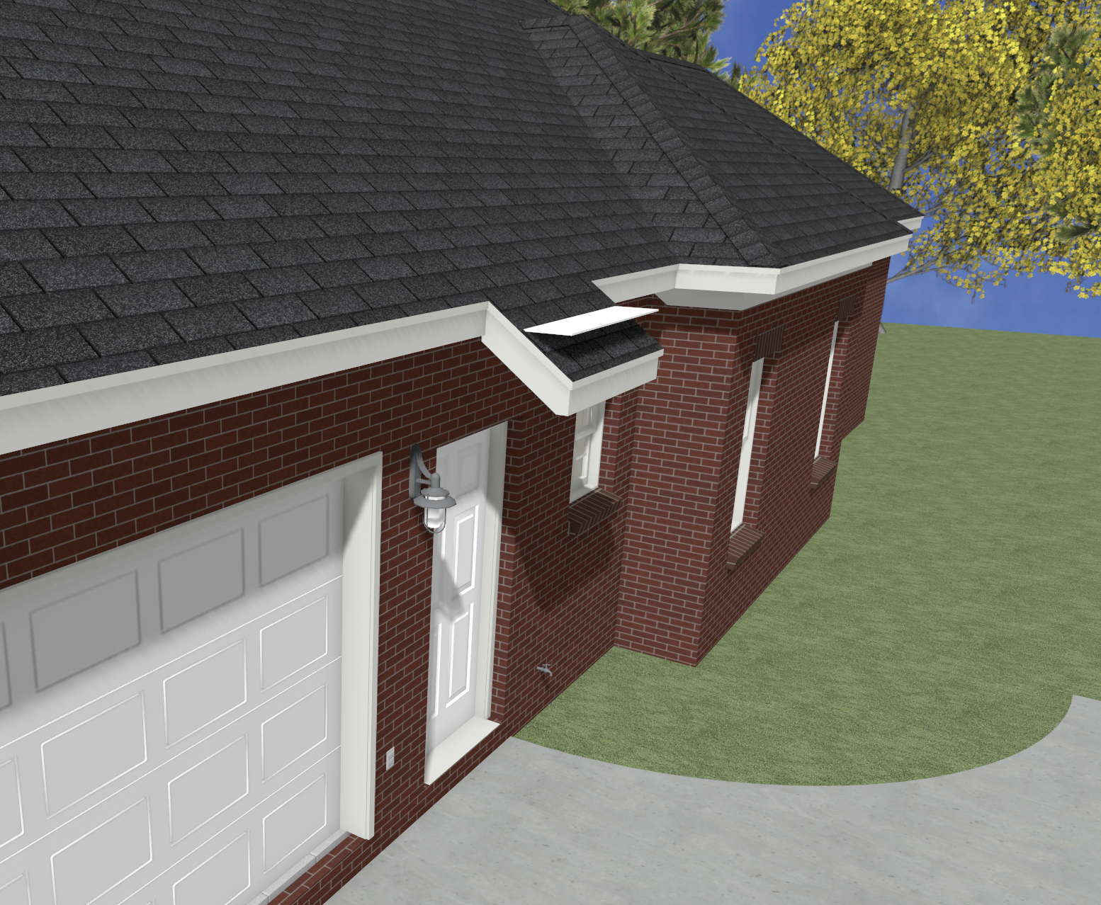

PitMan71 Posted September 30, 2025 Share Posted September 30, 2025 I want to extend my roof overhang over an exit door for partial cover. How can I do that and not have the soffit stick through the sloped roof? See attached for what I am referring to. OR is there a better way to do that rather than extending the roof down? Link to comment Share on other sites More sharing options...

PitMan71 Posted October 8, 2025 Author Share Posted October 8, 2025 I ended up getting this working. I had to select "Higher Eaves Boxed" on the Options panel. Thanks to everyone for chiming in. 1 Link to comment Share on other sites More sharing options...
