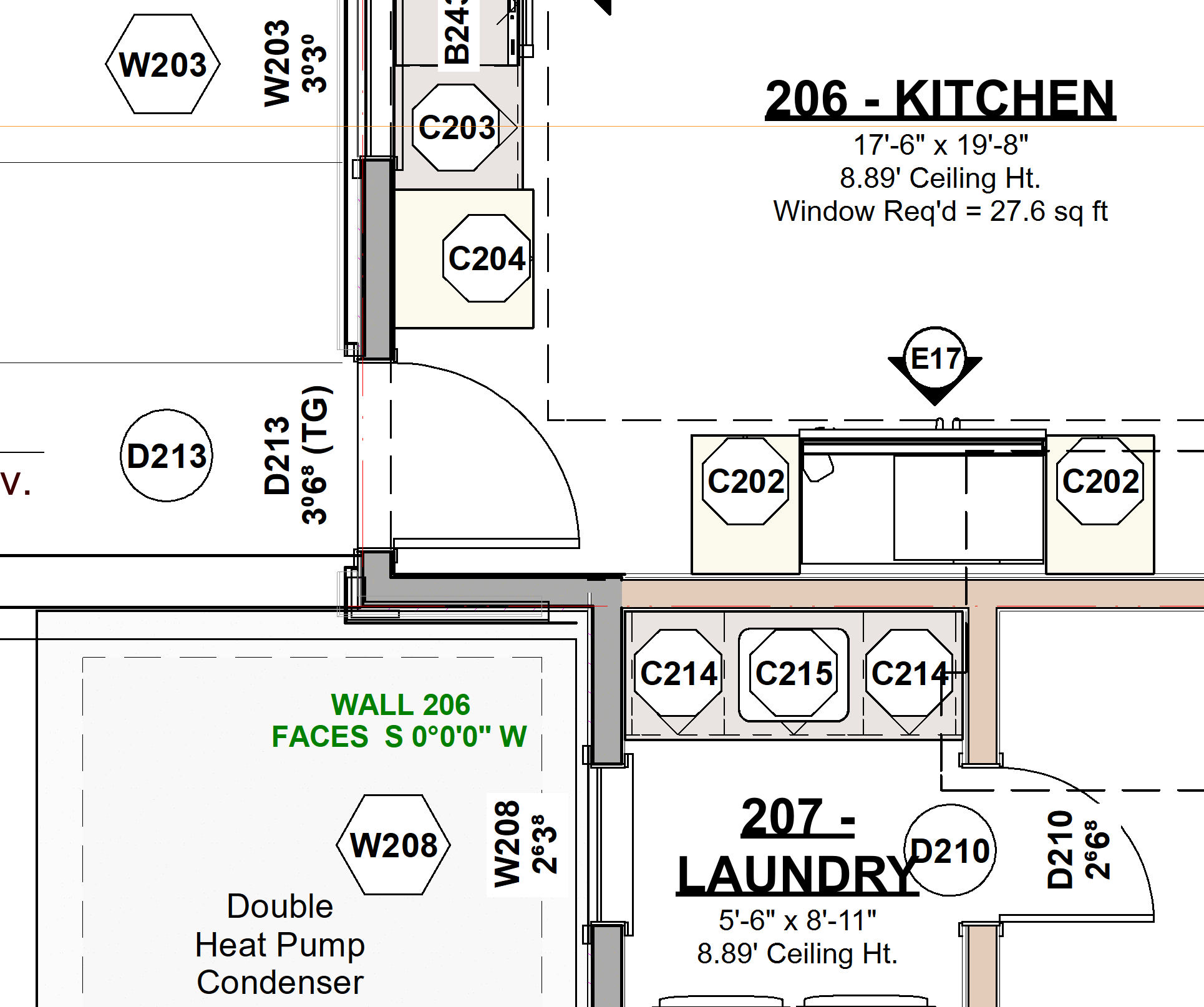

Joe_Carrick Posted September 11, 2025 Share Posted September 11, 2025 (edited) In order to use differnt fonts I simply use different Layersets. OTOH, if you just want to make certain characters like 0-9 as superscript characters you can set up a global like this: $ss = ["\u2070", "\u00B9", "\u00B2", "\u00B3", "\u2074", "\u2075", "\u2076", "\u2077", "\u2078", "\u2079"] Then a superscript character "4" would be $ss[4] which can then be used in other macros to display widths and heights in feet and inches such as 3⁰6⁸ 2⁶6⁸ etc I have several macros that cover all such opening labels. My default labels for openings differintiate base on the object type and layerset (view_type which unfortunately is not an NVP). Here's an example using both Callouts and Labels. Edited September 11, 2025 by Joe_Carrick Link to comment Share on other sites More sharing options...

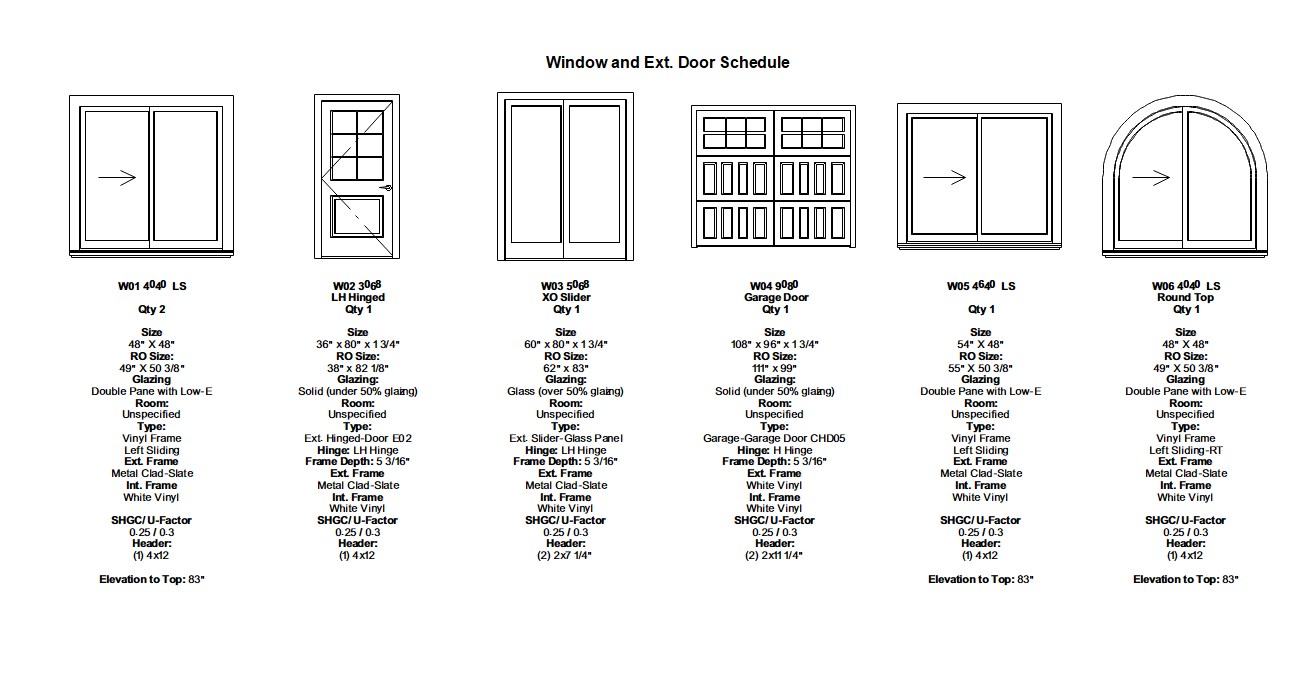

Renerabbitt Posted September 11, 2025 Author Share Posted September 11, 2025 7 hours ago, Joe_Carrick said: I have several macros that cover all such opening labels. I'm doing it a bit differently Joe. I am actually remapping for full height superscript and rich-text like outputs: Link to comment Share on other sites More sharing options...
Joe_Carrick Posted September 12, 2025 Share Posted September 12, 2025 (edited) Pretty cool, but for me that takes too much room on a Layout. I'm essentially providing all the same information but in Door and Window Schedules. I don't usually show the elevations but OTOH, I do provide the number of King Studs and Trimmers. It's no unusual for me to have up to 20 different Doors and a simila number of different Windows. Edited September 12, 2025 by Joe_Carrick Link to comment Share on other sites More sharing options...
Renerabbitt Posted September 12, 2025 Author Share Posted September 12, 2025 4 minutes ago, Joe_Carrick said: Pretty cool, but for me that takes too much room on a Layout People can always remove the 3d column... This was more for illustrating the font remapping Link to comment Share on other sites More sharing options...
