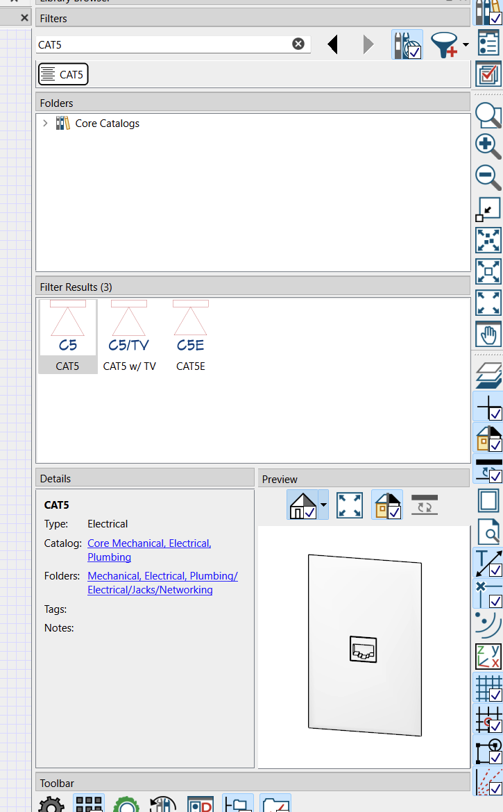

winterdd Posted September 5, 2025 Share Posted September 5, 2025 (edited) Doing an office renovation and cannot for the life of me find an electrical symbol for an ethernet outlet. Do we have anything in CA? I see some in Sketchup 3D warehouse but the models aren't that good and come in distorted and out of shape OR multiple ones at once. Confused why this isn't a standard electrical item in CA. Edited September 5, 2025 by winterdd typo Link to comment Share on other sites More sharing options...
ChiefTylerL Posted September 5, 2025 Share Posted September 5, 2025 Hello @winterdd, Various networking ports can be found in the Core Catalogs by going to Core Catalogs> Mechanical, Electrical, Plumbing> Electrical> Jacks> Networking. I hope this helps! 1 Link to comment Share on other sites More sharing options...
JKEdmo Posted September 5, 2025 Share Posted September 5, 2025 9 minutes ago, winterdd said: Doing an office renovation and cannot for the life of me find an electrical symbol for an ethernet outlet. Do we have anything in CA? I see some in Sketchup 3D warehouse but the models aren't that good and come in distorted and out of shape OR multiple ones at once. Confused why this isn't a standard electrical item in CA. Try searching for "Cat5" Link to comment Share on other sites More sharing options...
winterdd Posted September 5, 2025 Author Share Posted September 5, 2025 10 minutes ago, ChiefTylerL said: Hello @winterdd, Various networking ports can be found in the Core Catalogs by going to Core Catalogs> Mechanical, Electrical, Plumbing> Electrical> Jacks> Networking. I hope this helps! Yeah, I looked there and the assortment but didnt see any. Link to comment Share on other sites More sharing options...
winterdd Posted September 5, 2025 Author Share Posted September 5, 2025 16 minutes ago, JKEdmo said: Try searching for "Cat5" Is that the same? I mean I guess I could rename the symbol. Thanks. Link to comment Share on other sites More sharing options...
JKEdmo Posted September 5, 2025 Share Posted September 5, 2025 1 minute ago, winterdd said: Is that the same? I mean I guess I could rename the symbol. Thanks. Yes, CAT 5 just refers to the type of Ethernet cable, Category 5. https://en.wikipedia.org/wiki/Category_5_cable 1 Link to comment Share on other sites More sharing options...
winterdd Posted September 5, 2025 Author Share Posted September 5, 2025 2 hours ago, JKEdmo said: Yes, CAT 5 just refers to the type of Ethernet cable, Category 5. https://en.wikipedia.org/wiki/Category_5_cable Learned something new today, thanks...... Link to comment Share on other sites More sharing options...
PitMan71 Posted September 5, 2025 Share Posted September 5, 2025 RJ45 is the proper designation for the actual jack. 1 Link to comment Share on other sites More sharing options...
