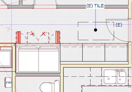

JKEdmo Posted September 5, 2025 Share Posted September 5, 2025 Good morning, Is it possible to do a double bifold cabinet door? I'm doing a recessed full-height cabinet as a laundry center. I'd like the doors to be bifold. This laundry cabinet is to match the adjacent full-height storage cabs. Thanks again, Jim Link to comment Share on other sites More sharing options...
MarkMc Posted September 5, 2025 Share Posted September 5, 2025 Room divider, place bifold doors (custom door symbol needed?). Cabinet has no bottom, no bottom separation, no toe kick - front is opening with no shelves. I moved the appliances away using transform replicate XXX" before setting cabinet or doors. Adjust the doors in elevation, move appliances back XXX" Link to comment Share on other sites More sharing options...
JKEdmo Posted September 5, 2025 Author Share Posted September 5, 2025 1 hour ago, MarkMc said: Room divider, place bifold doors (custom door symbol needed?). Cabinet has no bottom, no bottom separation, no toe kick - front is opening with no shelves. I moved the appliances away using transform replicate XXX" before setting cabinet or doors. Adjust the doors in elevation, move appliances back XXX" Mark, Thanks for helping me with this. I'll give it a try. Jim Link to comment Share on other sites More sharing options...
