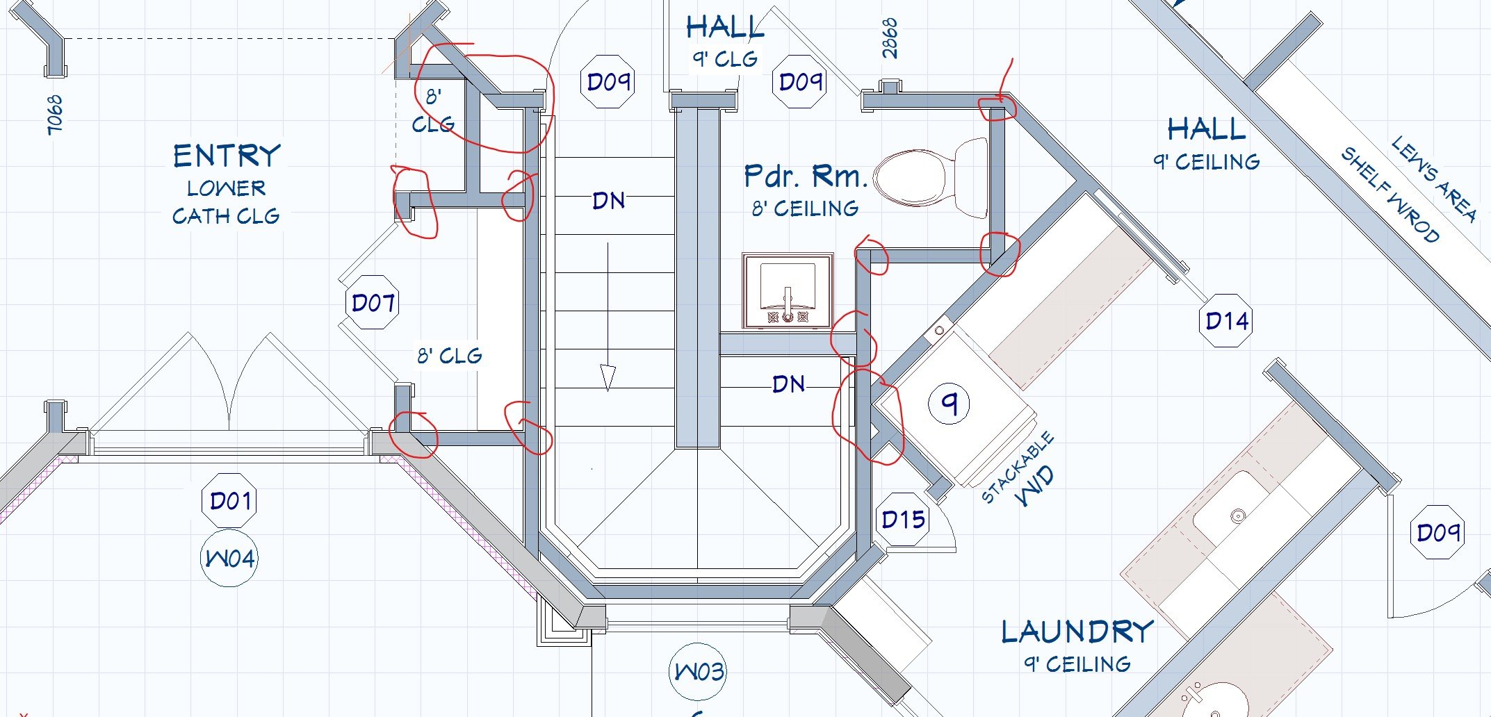

Larry_Sweeney Posted August 7, 2025 Share Posted August 7, 2025 Opened up a plan and I realize that almost (not all) every wall intersection to another wall has a line. I know it wasn't that way when I had closed out the plan yesterday. Just to be sure, I closed the plan and then reopened it and the lines were still there. Am i missing something. Having a "senior moment" or is CA having fun with me? Any suggestions will be greatly appreciated Link to comment Share on other sites More sharing options...

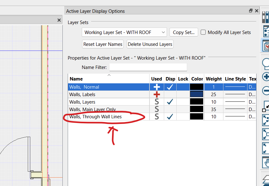

Solution JKEdmo Posted August 7, 2025 Solution Share Posted August 7, 2025 2 hours ago, Larry_Sweeney said: Opened up a plan and I realize that almost (not all) every wall intersection to another wall has a line. I know it wasn't that way when I had closed out the plan yesterday. Just to be sure, I closed the plan and then reopened it and the lines were still there. Am i missing something. Having a "senior moment" or is CA having fun with me? Any suggestions will be greatly appreciated Larry, Check this layer: 1 Link to comment Share on other sites More sharing options...
Larry_Sweeney Posted August 7, 2025 Author Share Posted August 7, 2025 Jim...................Yes , that was it! Thank you. Like I mentioned in my thread, when I shut down for the day everything is fine, and then when I opened the plan back up, before I did anything, the intersection lines were showing. CA was having fun again. Link to comment Share on other sites More sharing options...
JKEdmo Posted August 7, 2025 Share Posted August 7, 2025 1 hour ago, Larry_Sweeney said: Jim...................Yes , that was it! Thank you. Like I mentioned in my thread, when I shut down for the day everything is fine, and then when I opened the plan back up, before I did anything, the intersection lines were showing. CA was having fun again. No problem Larry. Now, I just wonder what the purpose of that layer is? Is it to represent in plan the wall cleanup? Jim Link to comment Share on other sites More sharing options...
