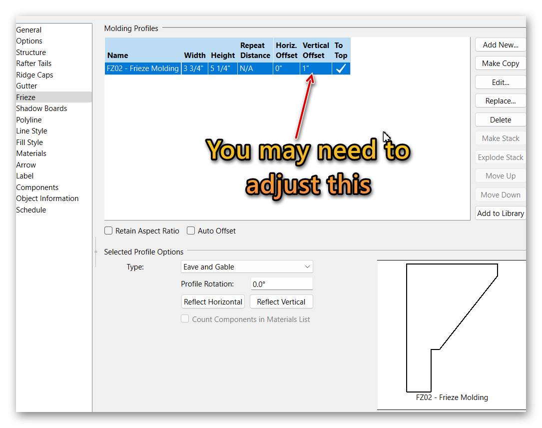

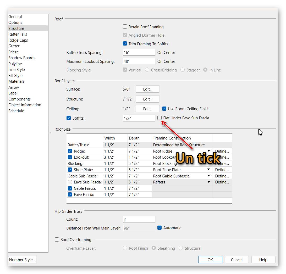

capitaldesigns Posted July 26, 2025 Share Posted July 26, 2025 I am working on a detached garage with a gable roof. I am adding freeze boards under the eaves. The freeze boards are not connecting around the corners of the building. Does anyone know how to get the freeze boards to connect at the corners ? I attached my plan file. Thanks, MikeBrian.planBrian.plan Brian.zip Brian.zip Link to comment Share on other sites More sharing options...
Mark3D Posted July 28, 2025 Share Posted July 28, 2025 Try these settings Link to comment Share on other sites More sharing options...
