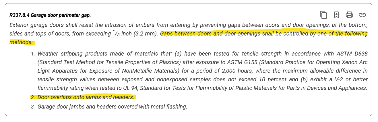

jorgearaya Posted July 22 Share Posted July 22 Hi Alan, hit them back with R337.8.4 "Shall be controlled by "one" of the following methods" and use either 2 or 3. Done. Link to comment Share on other sites More sharing options...

JKEdmo Posted Tuesday at 01:37 AM Share Posted Tuesday at 01:37 AM 4 hours ago, jorgearaya said: Most garage door bottom rubber gaskets already comply with this requirement. Wouldn't an overlap at jambs and headers (item 2) by itself fulfill the requirement? Don't need to worry about weatherstripping or flashing at all if I read this correctly. I'd think this would be easiest option as overlap is pretty common on sectional doors. Link to comment Share on other sites More sharing options...
jorgearaya Posted Thursday at 09:33 PM Share Posted Thursday at 09:33 PM Isn't that what I suggested? I was replying to @lukeanthony12 Link to comment Share on other sites More sharing options...
JKEdmo Posted 5 hours ago Share Posted 5 hours ago On 8/7/2025 at 2:33 PM, jorgearaya said: Isn't that what I suggested? I was replying to @lukeanthony12 Yes, you're right. Missed that. Link to comment Share on other sites More sharing options...
