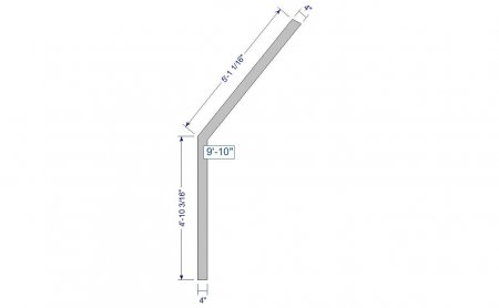

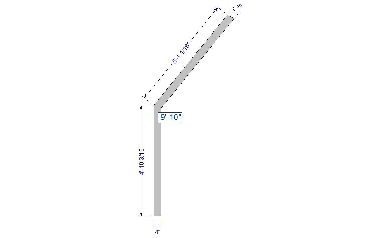

Solution Alaskan_Son Posted July 12, 2025 Solution Share Posted July 12, 2025 If you're using a closed polyline, then %length% will not be an option. As @DBCooperalready stated though, you can use %perimeter%. The problem though is that you're going to get the entire perimeter of the polyline and not necessarily the length of the pipe that the polyline is supposed to be representing. Assuming though that your "pipe" is a specific width and that and that its a pretty consistent width closed on both ends, then you should be able to use something like the following: %((perimeter.round-8.in)/2).to_s("\'-\"")% ...where the number 8 is just double the width of the "pipe"... NOTE: I rounded the perimeter value just to avoid a more complex fractional inch value macro but this should work for a basic length. Just make sure to replace the number to reflect the actual width of your pipe. If you need anything more complex or need things tweaked further, please feel feel to reach out. I do offer consultation services for this exact type of thing. 1 1 Link to comment Share on other sites More sharing options...
