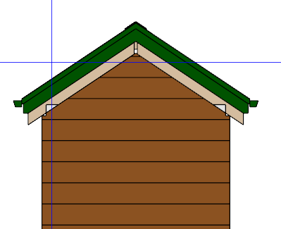

Ed_Orum Posted June 24 Share Posted June 24 Here is a screenshot showing an elevation view of the gable end of this building. The siding does not cover the rafters or extend to the roof. The rafters align with the exterior of the framed wall. I must have a setting set incorrectly somewhere, but I don't know which one it would be. My next question is whether Layer Sets can be exported from one plan to another. Thanks, Lane Link to comment Share on other sites More sharing options...

Chrisb222 Posted June 24 Share Posted June 24 3 hours ago, Ed_Orum said: The siding does not cover the rafters or extend to the roof. You have "Soffits" unchecked in the Roof Plane dialog, causing the program to clip the siding at the rafter level. I got it to build siding to near the roof: Before: After: Turn Soffits back on and set to 1/2", then go into Materials and set Soffits to "Insulation Air Gap: Link to comment Share on other sites More sharing options...
Ed_Orum Posted June 24 Author Share Posted June 24 Chris, I don't want soffits. The roof decking should be visible from below. Chief must be programmed to look for soffits even when they don't exist? Link to comment Share on other sites More sharing options...
Solution Chrisb222 Posted June 24 Solution Share Posted June 24 1 hour ago, Ed_Orum said: don't want soffits. The roof decking should be visible from below. I know, that's why you set the material to something invisible like insulation air gap. Then the roof decking is visible. 1 Link to comment Share on other sites More sharing options...

Ed_Orum Posted June 25 Author Share Posted June 25 20 hours ago, Chrisb222 said: I know, that's why you set the material to something invisible like insulation air gap. Then the roof decking is visible. Ah, another work around. My workaround book is getting so full, the solutions should be made part of the program. Thanks! Link to comment Share on other sites More sharing options...
