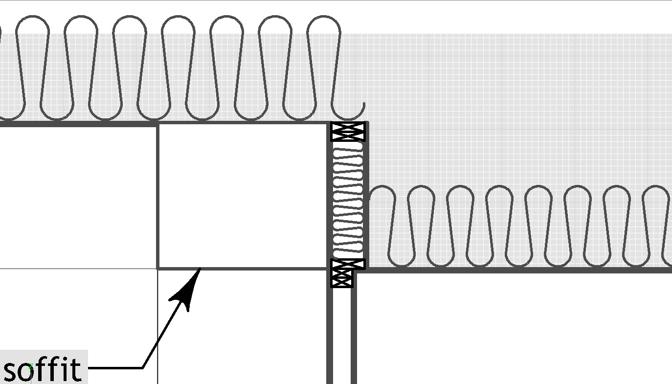

robdyck Posted June 5, 2025 Share Posted June 5, 2025 If I'm not mistaken there was a time when an interior wall would frame to the lower of 2 varying ceiling heights. Currently, these walls now default frame up to the higher ceiling. In the iamge below, I have 1 room where the ceiling has been raised by 24". I'd prefer the wall to frame to the 9' height, NOT 11'. And I'd prefer not to use a pony wall to accomplish this, althouhg that's probably what I'll do. Have I forgotten a simple setting somehwere? Link to comment Share on other sites More sharing options...

robdyck Posted June 5, 2025 Author Share Posted June 5, 2025 Thanks for the suggestion @javatom. Unfortunately that doesn't change anything. In fact, I can't think of any instance where that setting has had any noticeable effect. I will resort to using a pony wall or some other method! This is what I'd prefer: a 2x6 insulation wall over the 2x4 wall at the 9' ceiling level. And I'd just prefer to draw this 2x6 wall on the attic level. Using a pony wall on the main floor can have some unwanted display issues with wall connections and with room measurements that I'd rather avoid. Link to comment Share on other sites More sharing options...
