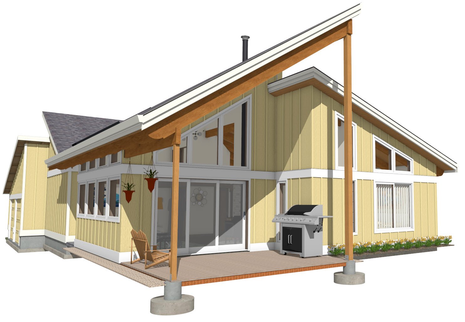

amddrafting Posted May 8 Share Posted May 8 Not sure this is how @Renerabbitt did it but it inspired me to create something in a wall type and this was the end result, for a quick 3D rendering it works great. Gables would take a little of clean up but it's quick and simple, create two layers of siding and make the outer one the depth of the siding you want. Set it to have framing and set up the width and spacing you want. Then set your top and bottom plates if you want them and voila... Windows and doors will create issues as the framing will be automatic around them but you can delete and edit as needed I guess. 1 Link to comment Share on other sites More sharing options...
Renerabbitt Posted May 9 Share Posted May 9 3 hours ago, amddrafting said: Not sure this is how @Renerabbitt did it but it inspired me to create something in a wall type and this was the end result, for a quick 3D rendering it works great. Gables would take a little of clean up but it's quick and simple, create two layers of siding and make the outer one the depth of the siding you want. Set it to have framing and set up the width and spacing you want. Then set your top and bottom plates if you want them and voila... Windows and doors will create issues as the framing will be automatic around them but you can delete and edit as needed I guess. What you show is how Yoda does it. Mine is a combo of wall types, custom materials and wall coverings and it has no issue with windows and doors and does not affect framing 250508 (3).mp4 Link to comment Share on other sites More sharing options...
