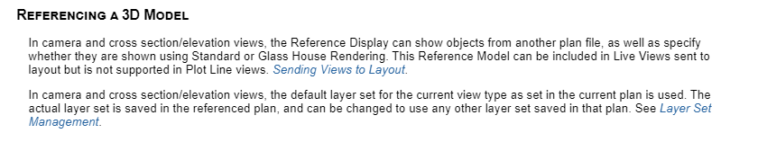

JKEdmo Posted April 23, 2025 Share Posted April 23, 2025 Good morning, I've created a site plan with various tiny house units populating my site terrain model using the reference display (they are all separate PLAN files): I then created a site section and sent this section view to a layout sheet. My problem -- the units do not show up in the section view. The Camera View Option is set to Plot Lines. However, when I set the Camera to Live View, the units show up: I prefer Plot Lines. Is Chief unable to generate any lines from Reference Display object? Your insight appreciated. Thanks, Jim Link to comment Share on other sites More sharing options...
JKEdmo Posted April 24, 2025 Author Share Posted April 24, 2025 Reposting with the hope somebody has some insight into this. Thanks, Jim Link to comment Share on other sites More sharing options...
Solution DBCooper Posted April 24, 2025 Solution Share Posted April 24, 2025 According to the help documentation, it isn't supported. Looks like you might need to submit a feature request. Link to comment Share on other sites More sharing options...
JKEdmo Posted April 24, 2025 Author Share Posted April 24, 2025 29 minutes ago, DBCooper said: According to the help documentation, it isn't supported. Looks like you might need to submit a feature request. Well dangnabbit! Thanks for doing the research. I appreciate it. Jim Link to comment Share on other sites More sharing options...
