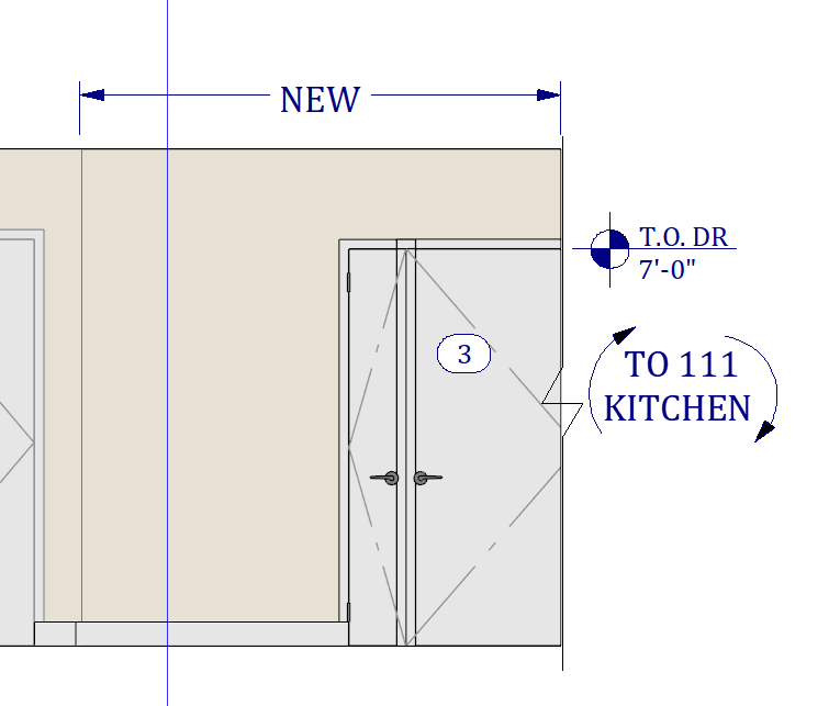

DenisonDrywall Posted April 22, 2025 Share Posted April 22, 2025 Is there a way to make the pair of doors with each door a different size? so it looks like this But it looks wrong in elevation because i had to use 2 doors of 2 different sizes and draw a box over the jambs to hide them in plan. do i have to make a custom door somehow? Thanks, Jennifer Link to comment Share on other sites More sharing options...
GaryOhmer Posted April 22, 2025 Share Posted April 22, 2025 draw the two doors the size you need - slide them together - now control select both and group together Link to comment Share on other sites More sharing options...
DenisonDrywall Posted April 22, 2025 Author Share Posted April 22, 2025 that worked. thanks. Link to comment Share on other sites More sharing options...
