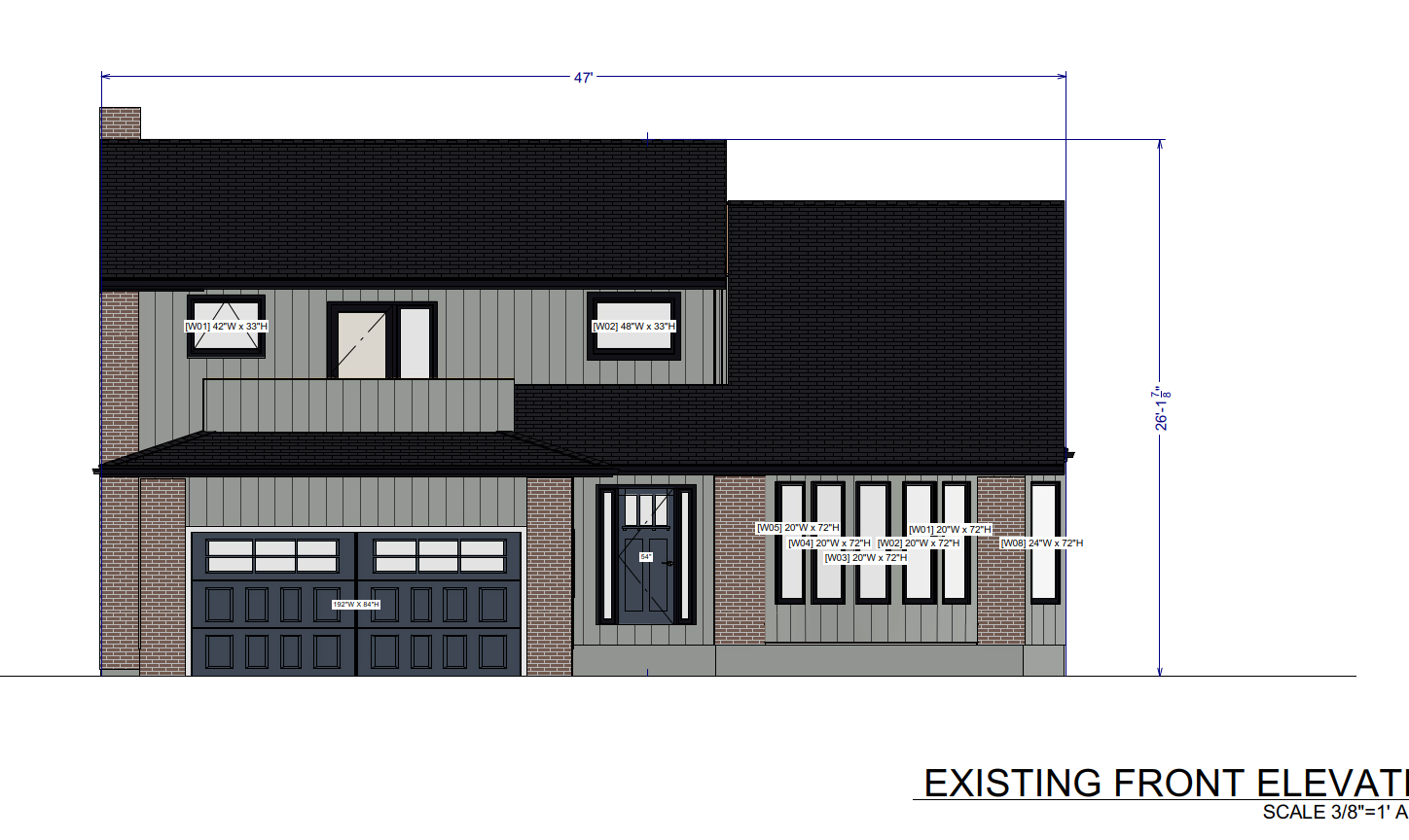

SHCanada2 Posted August 13 Share Posted August 13 (edited) anyone seen this behaviour? Updating the layout causes window labels to show then not show Screen Recording 2026-08-13 150124.mp4 he layout boxes seems to cause different window/door lables to appear, but never all of them at the same time Edited August 13 by SHCanada2 Link to comment Share on other sites More sharing options...

SHCanada2 Posted August 16 Author Share Posted August 16 (edited) hmmm, still doesn't print correctly. it's weired because it is not the same window(s) every time Edited August 16 by SHCanada2 Link to comment Share on other sites More sharing options...

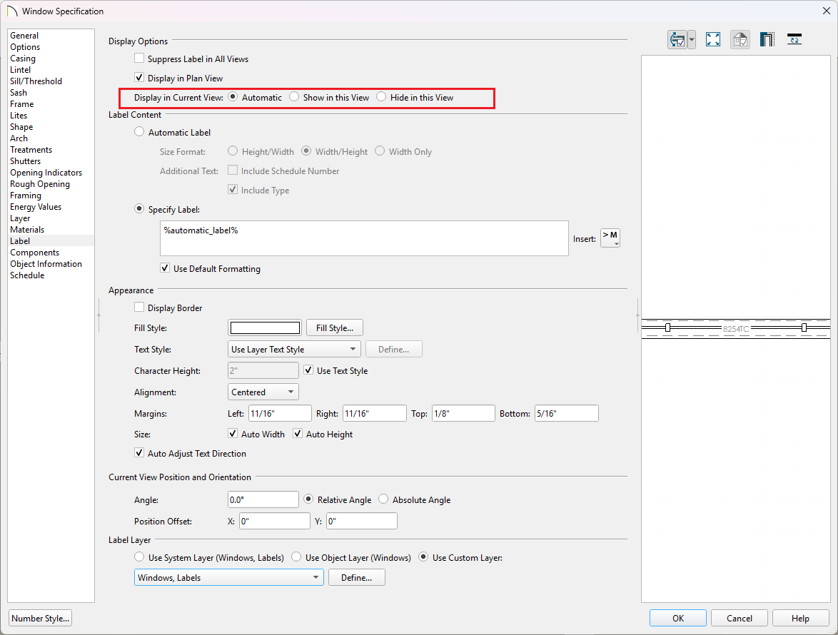

DBCooper Posted August 21 Share Posted August 21 Quote We have those set to show, but they randomly disappear then reappear with no real rhyme or reason. Yeah, I have noticed some funky behavior that seems to be related to camera angles. My guess is that you don't really have them set to "show" and you are still using "automatic". In camera views, labels can be set to "show", "hide", or "automatic". When they are set to automatic, they will sometimes show and sometimes not. If they are showing and you don't want them to, then just force them to hide. If they are not showing and you want them to, then just force them to show. When you use the edit toolbar button, I think it will either force them to show or hide and it should turn off the automatic behavior. If they are not doing what you want when you have them set to automatic, you still might want to send this to Chief and "suggest" that they make the automatic behavior work better. Link to comment Share on other sites More sharing options...
SHCanada2 Posted August 21 Author Share Posted August 21 2 hours ago, DBCooper said: If they are not doing what you want when you have them set to automatic, you still might want to send this to Chief and "suggest" that they make the automatic behavior work better they appear and don't appear simply by updating the view. sound like a bug vs an intended design needing an improvement suggestion Link to comment Share on other sites More sharing options...
