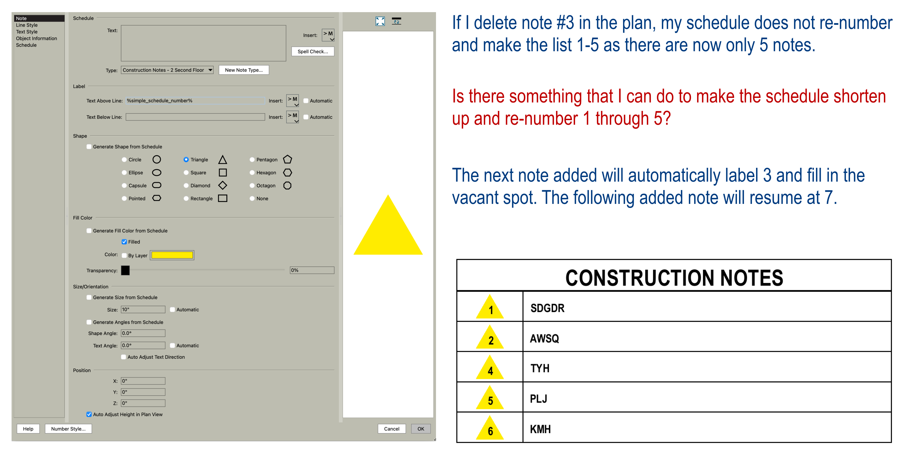

ValleyGuy Posted 12 hours ago Share Posted 12 hours ago I'm hoping someone has an idea.... Is there a way to have the call out number sequence for a plan note adjust when a note is deleted? The notes are %simple schedule number% when placed on the plan, and also appear in sequence in a note schedule. However, should a note be deleted from the plan, the notes numbered after the deleted one do not appear in sequence in the schedule. Link to comment Share on other sites More sharing options...

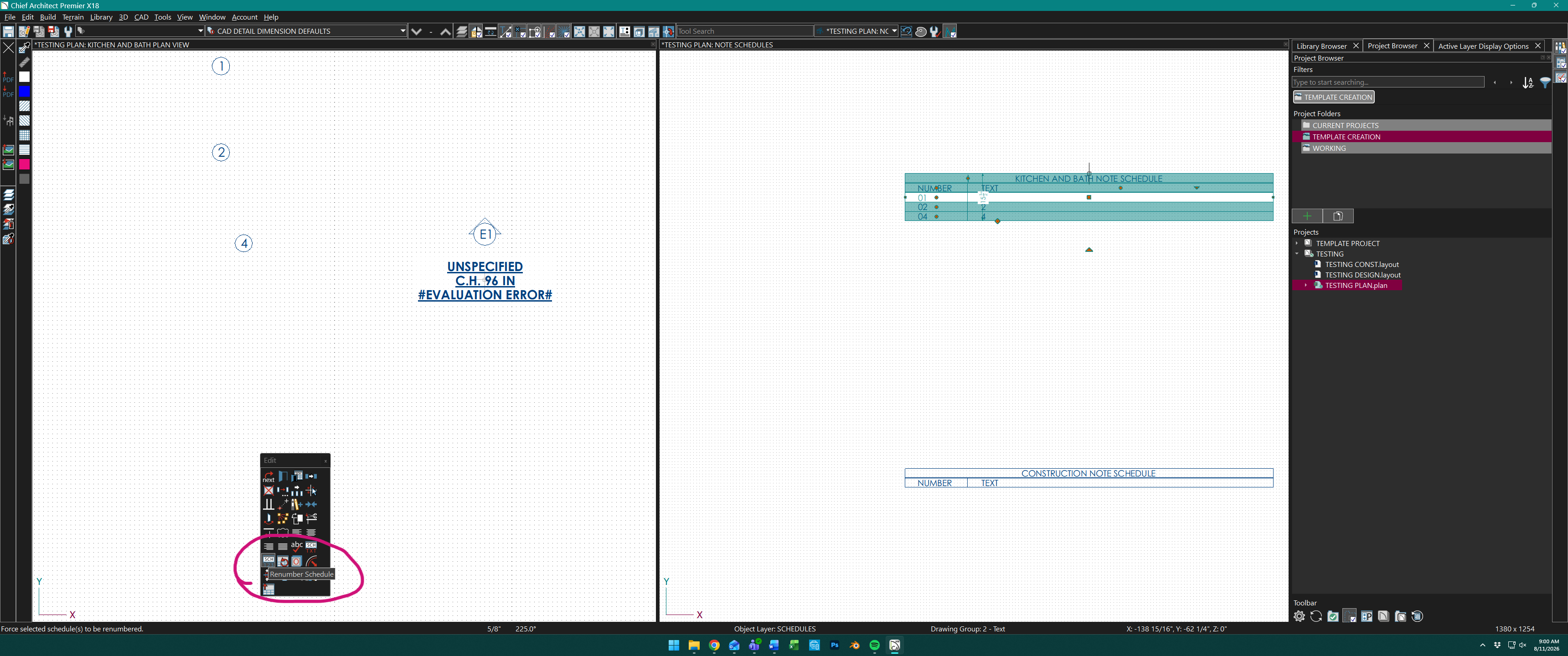

Solution MollyNDG Posted 10 hours ago Solution Share Posted 10 hours ago There is a tool called "Renumber Schedule", see image. Just select your note schedule and it will pop up in your lower toolbar. 1 Link to comment Share on other sites More sharing options...
ValleyGuy Posted 9 hours ago Author Share Posted 9 hours ago 1 hour ago, MollyNDG said: There is a tool called "Renumber Schedule", see image. Just select your note schedule and it will pop up in your lower toolbar. That did the trick, thank you so much. Link to comment Share on other sites More sharing options...
