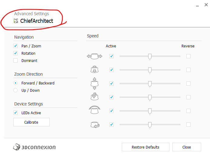

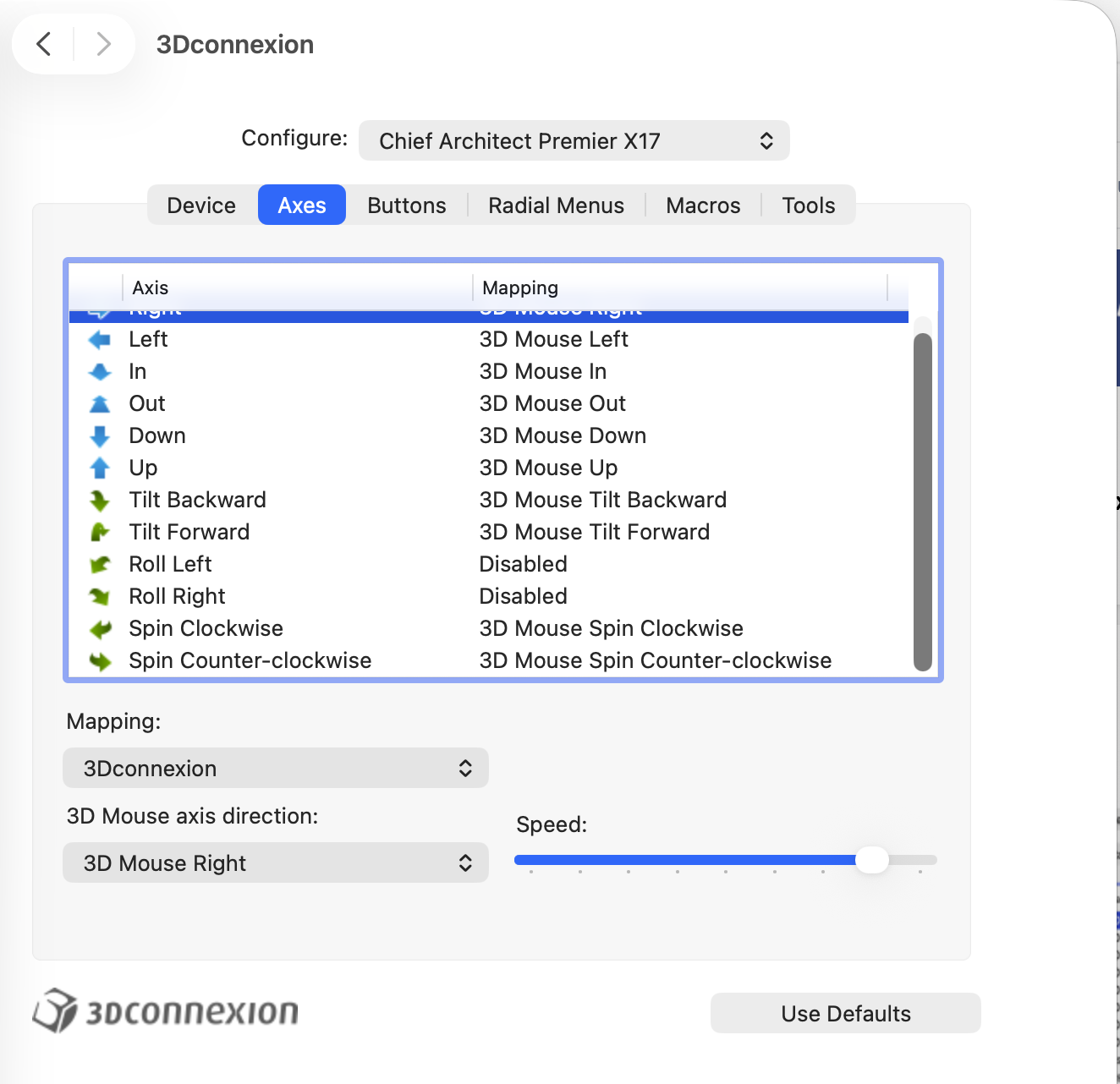

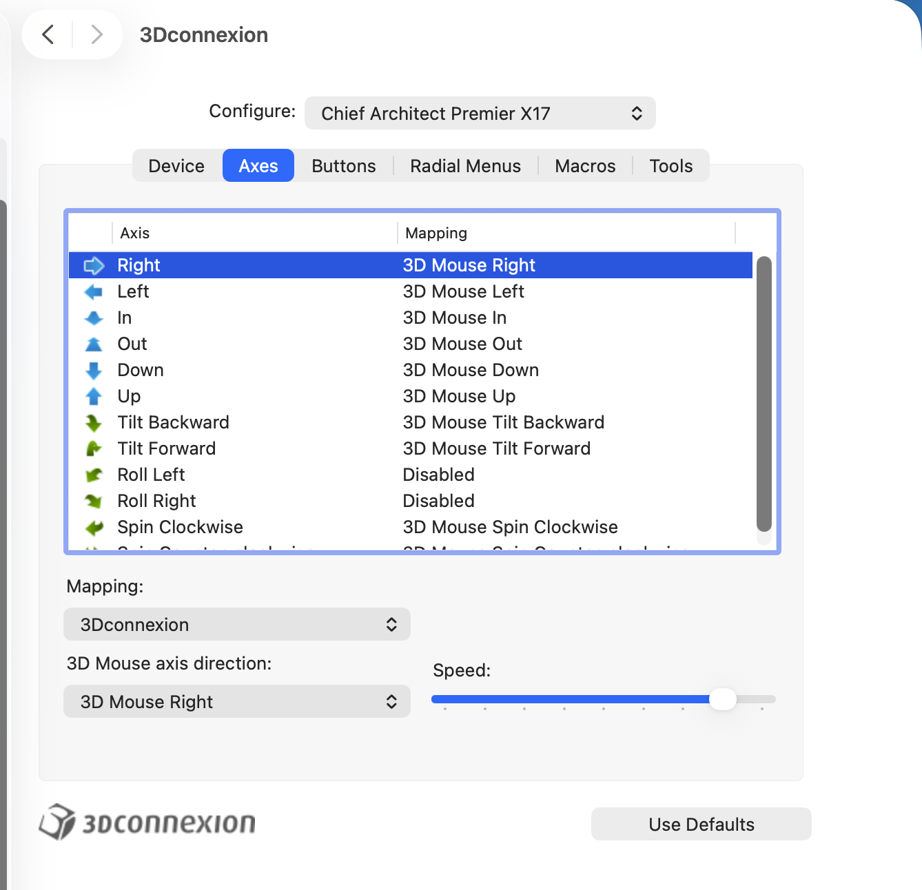

Renerabbitt Posted Friday at 02:04 AM Share Posted Friday at 02:04 AM 1 minute ago, HaneyDrafting said: It stays connected now, but there is no Spin, tilt, or roll feedback. Someone said that the roll function is not available on Chief regardless of OS. screenshot your 3d connexion settings with chief as your active window, is spin and tilt toggled on? Also is Chief being seen as the program in focus? Link to comment Share on other sites More sharing options...
HaneyDrafting Posted Friday at 02:24 AM Author Share Posted Friday at 02:24 AM (edited) yes, I am in chief working. Edited Friday at 02:26 AM by HaneyDrafting Link to comment Share on other sites More sharing options...
Renerabbitt Posted Friday at 03:12 AM Share Posted Friday at 03:12 AM 47 minutes ago, HaneyDrafting said: yes, I am in chief working. Device tab Turn off Rotation Lock Turn off Dominant Leave Horizon Lock on Ignore Roll being disabled, because that appears intentional Link to comment Share on other sites More sharing options...

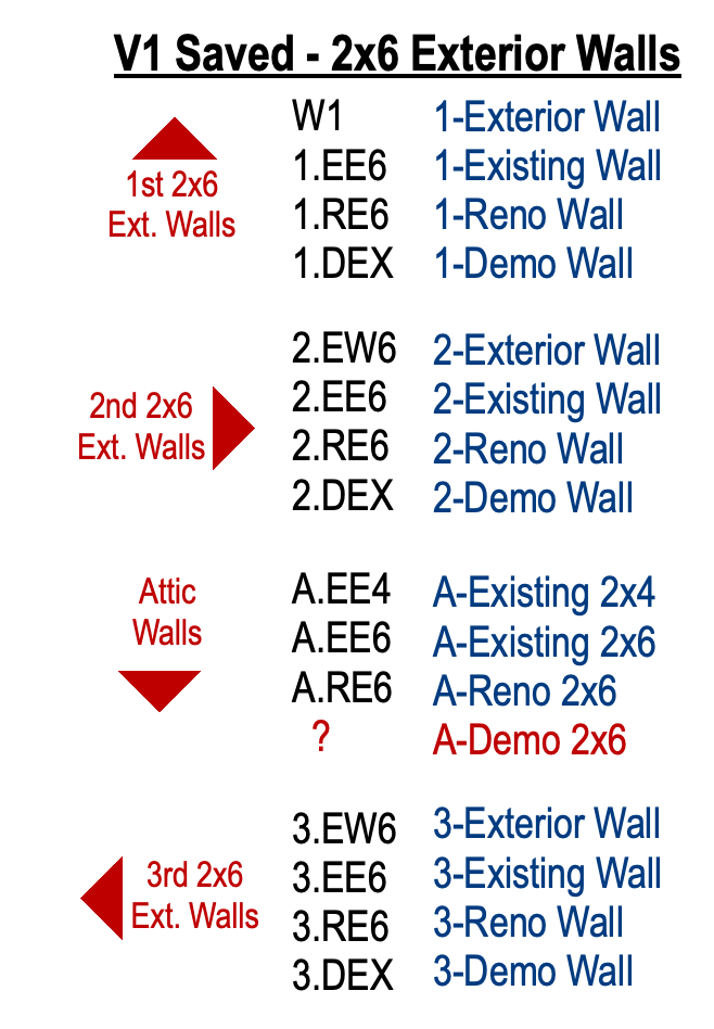

ValleyGuy Posted Friday at 03:30 AM Share Posted Friday at 03:30 AM I don't have a laptop so hopefully Rene can help you get going on that end. As far as not be as robust, it is correct about Mac only getting 4 radial dial options per button, but it is still pretty efficient. I have played around with different techniques and am currently using the two click approach, and it seems to be working very well once I got into the mind set and rhythm. The first button push brings up only four options on a radial dial, each one of these will bring up an additional four items on the next radial dial. Which means that with two clicks there are 16 items per button. I have the Enterprise model and use 31 buttons for radial menus, so that is about 496 tools and library items all within 2 clicks. I find that having the first layer working as a direction path to the group of 16 helps keep similar things grouped together nicely. Example: I have exterior walls for 1st, 2nd, 3rd floors, and the attic. Each of these have a regular default new wall, existing wall, reno wall, and a demo wall. Everyone will find what works best for them, this may just give one more option to look at. I hope that you get things figured out before you lose patience. I almost was at the point to 'Hit Any Key' ... really, really hard.... with a hammer when I first bought mine too. Link to comment Share on other sites More sharing options...
