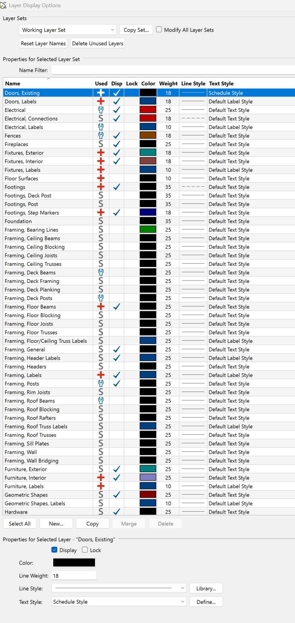

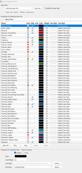

I am wanting to exclude walls, doors, windows from the Material List calculation. I have seen older post to say put them on a different layer, then go into | Tools, Display, Layer Display Options and Uncheck Material List. These were post from 2020. I am V15 and that option is not shown. Did the method change or am I missing something?

Try using the "edit active view" tool while you are in a material list.  This should let you turn things on and off.  And if you always want your material lists to be this way, change your material list defaults in the "default settings" dialog.
