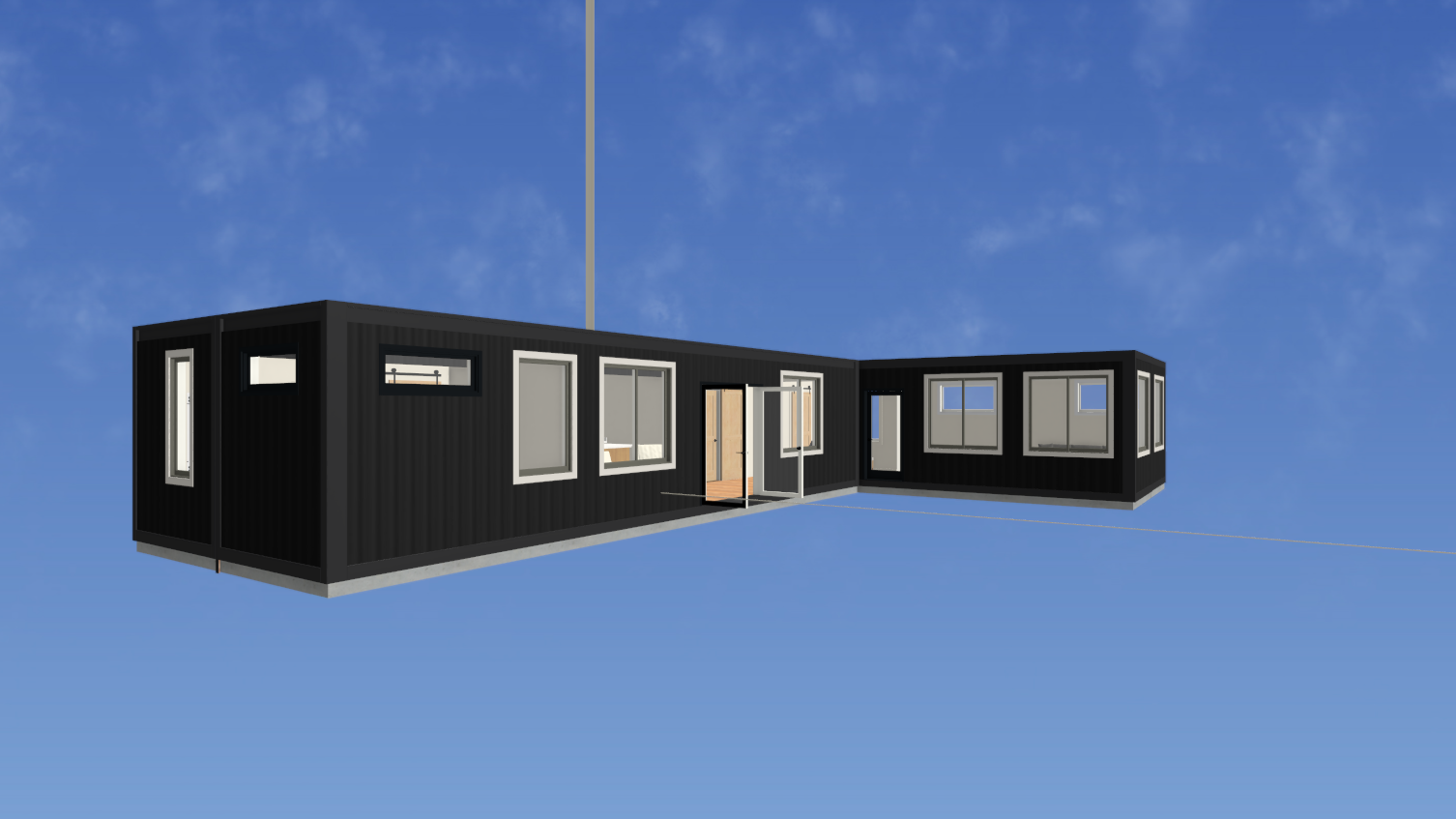

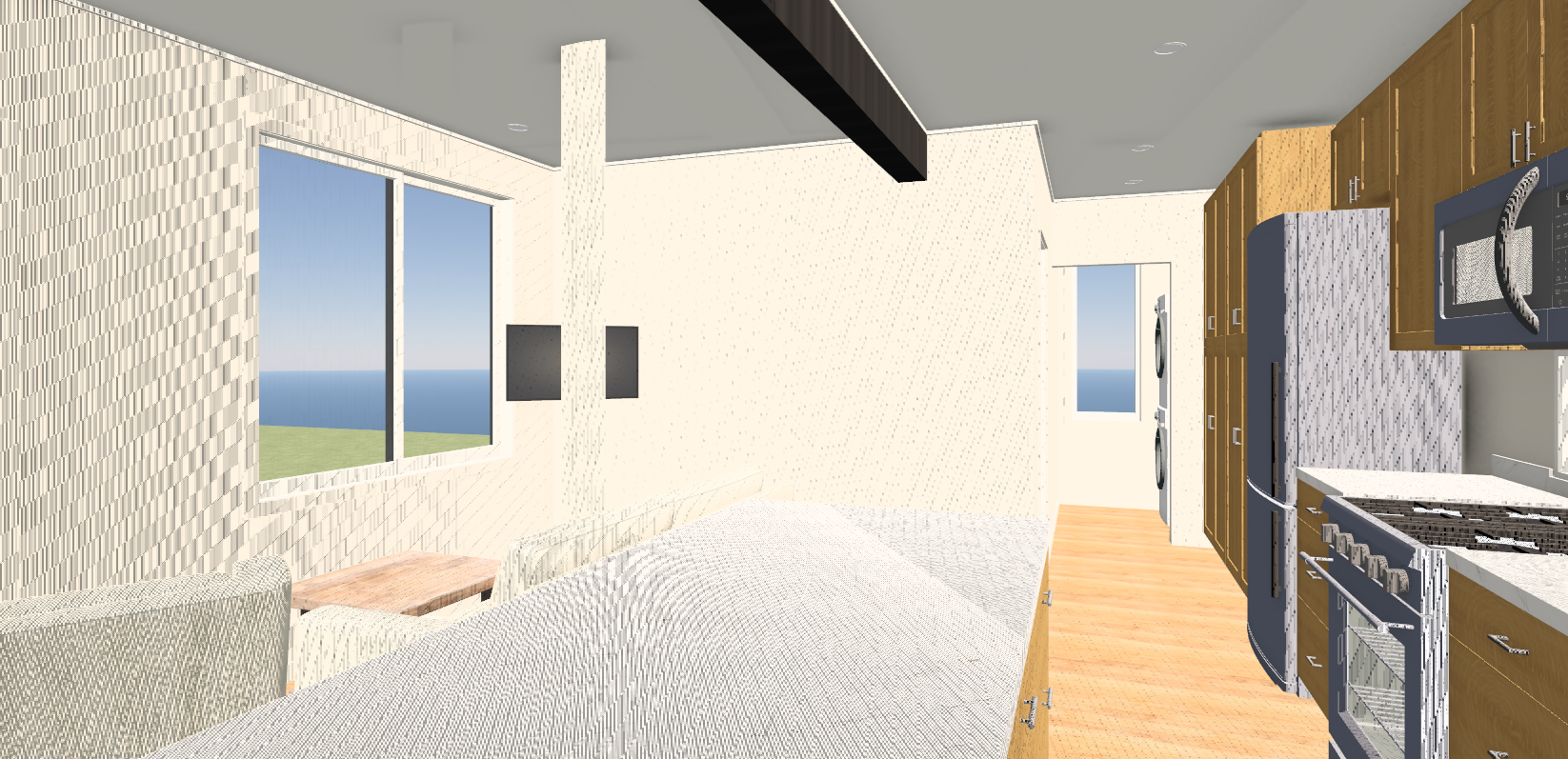

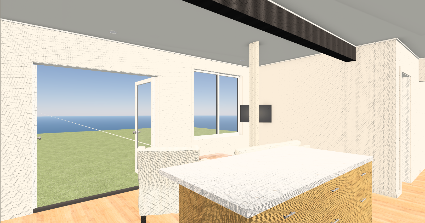

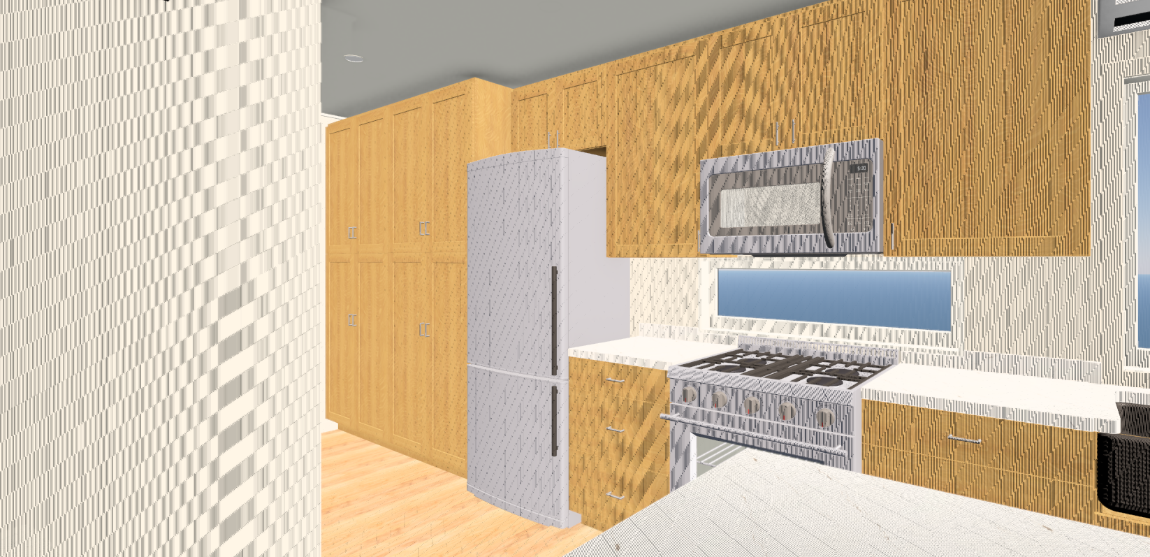

BackCountry Posted July 22 Share Posted July 22 Hello, opened up a file today to work on it and it has gone the way of the loon. Totally weird pixelation, stripes etc. As I rotate around the room it sometimes disappears in some shots but then comes back. Using Standard Camera View and others and its the same (except Glass House, or Hand Drawn Lines. Also there is a goofy post that appeared in the drawing and goes up to the heavens and has a line going out sideways that i can't select or layer or anything to delete. Running a new MacBook Pro with serious capability and graphics card X17 Premier Our workflow at our office is to store files on a Network Attached Storage Device so myself and others can access the files. Wondering if the NAS is corrupting the files? Link to comment Share on other sites More sharing options...

ChiefTylerL Posted July 22 Share Posted July 22 @BackCountryBased off of your screenshots I think you may be very far from the origin (0,0) which can cause strange behavior in the 3D camera views. My recommendation would be to use Edit Area (All Floors) and the Transform Replicate tool to move your design back to 0,0. Here is a Knowledge Base article that outlines this process: https://www.chiefarchitect.com/support/article/KB-00107/troubleshooting-why-materials-appear-to-flicker-when-a-camera-view-is-rotated.html Additionally you may have objects that are far away from the rest of your model, which can also cause strange issues like the ones you're seeing. This Knowledge Base article will outline how to find far away objects and move them back: https://www.chiefarchitect.com/support/article/KB-00021/troubleshooting-small-or-blank-camera-overviews.html If neither of these seem to resolve the issue I would recommend contacting Technical Support through the Technical Support Center: https://www.chiefarchitect.com/support/article/KB-00717/using-the-technical-support-center.html I hope this helps! Link to comment Share on other sites More sharing options...
BackCountry Posted July 22 Author Share Posted July 22 Tyler, I moved the drawing to the 0 / 0 coordinates and the issue is still present. Link to comment Share on other sites More sharing options...
Renerabbitt Posted July 22 Share Posted July 22 25 minutes ago, BackCountry said: Tyler, I moved the drawing to the 0 / 0 coordinates and the issue is still present. If you use the Edit area tool and select everything that's visible with a large marquee selection and then use copy paste and paste this into a brand new empty plan Are the issues still there? Link to comment Share on other sites More sharing options...
BackCountry Posted July 22 Author Share Posted July 22 Renerabbitt, Copied to new plan as suggested, at first there were no weird glitches, but it had roof planes all over the place so I manually deleted the roof planes for now and the glitch lines are back. Link to comment Share on other sites More sharing options...

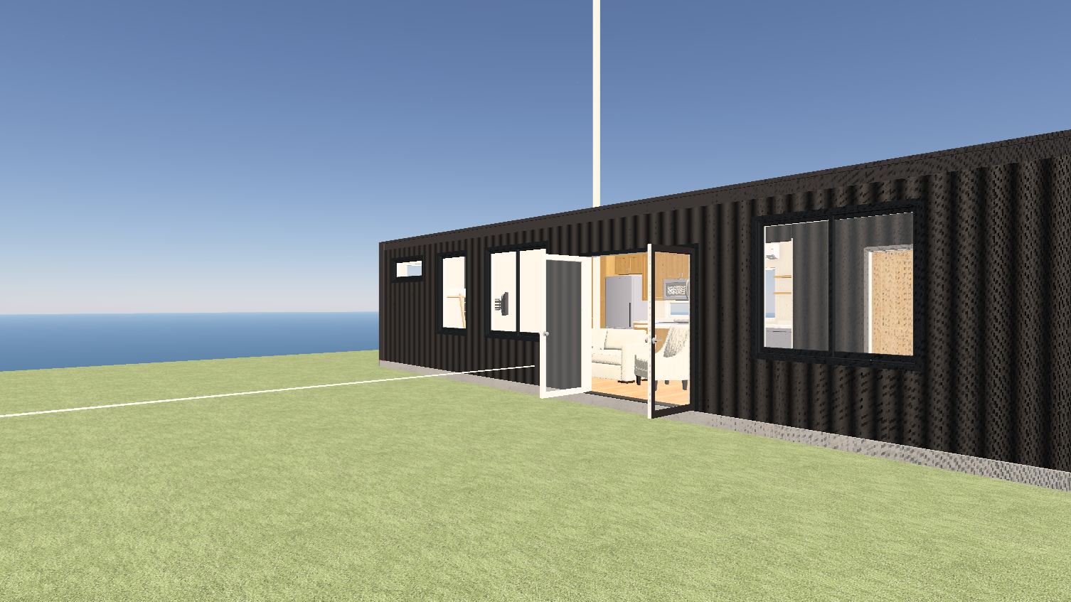

BackCountry Posted July 22 Author Share Posted July 22 Anyone got ideas to the two items sticking out of the structure straight up and straight sideways? Cant select, click, edit, nothing... Link to comment Share on other sites More sharing options...
Renerabbitt Posted July 22 Share Posted July 22 5 minutes ago, BackCountry said: Anyone got ideas to the two items sticking out of the structure straight up and straight sideways? Cant select, click, edit, nothing... Please share your project file. You can use free services like we transfer if you don't have a cloud service Link to comment Share on other sites More sharing options...
