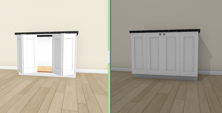

Drew-PRH Posted Friday at 10:11 PM Share Posted Friday at 10:11 PM Good day, Might there be an option to have a bi-parting cabinet door? Trying to accommodate a 4-door desktop unit which has two doors fold in the center and move to the right, and two doors fold in the center and move to the left. In a way you may say an appliance garage for a desk Any help would be appreciated - Thank you!! ** Also, on a side note - there appears to be not an option for a pair of cabinet doors to pull out and slide in on each side, left and right...hmmm. - Drew Link to comment Share on other sites More sharing options...

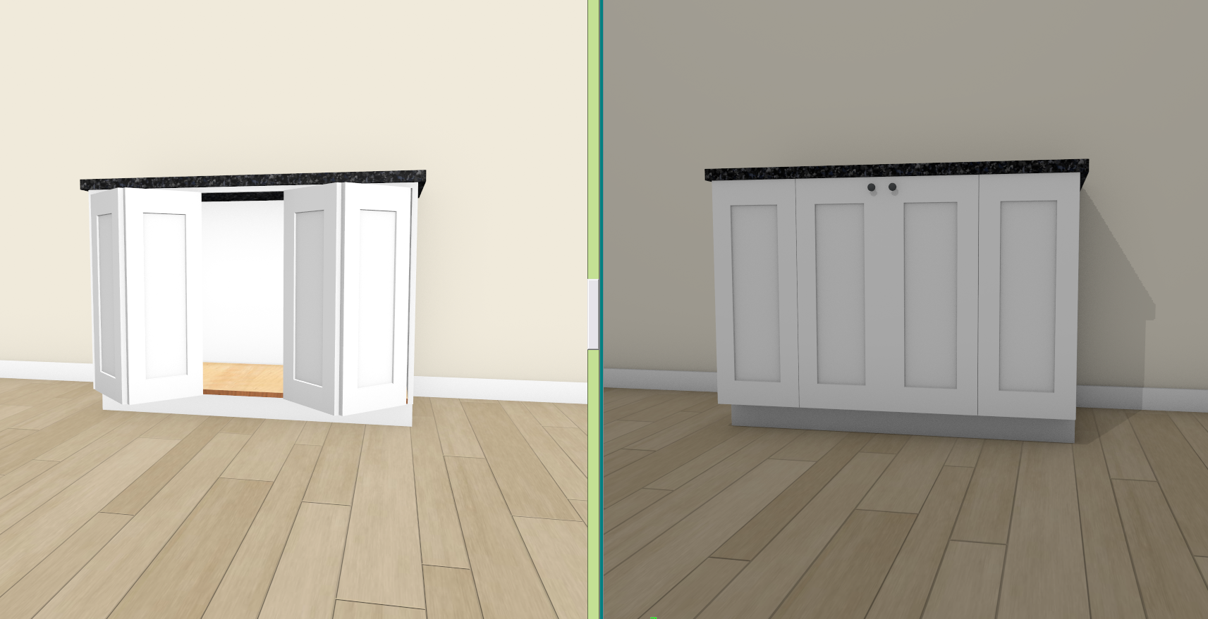

MarkMc Posted Saturday at 01:49 AM Share Posted Saturday at 01:49 AM 3 hours ago, Drew-PRH said: two doors fold in the center and move to the right, and two doors fold in the center and move to the left. Need to hack that with custom symbols. You can show open as attached. IF you also want to show it closed you will need to set up a second layer for this cabinet (and a layerset) then force a closed cabinet directly over it using a second layerset. Open in one layerset, a second layerset to show the closed cabinet. You have to also put the folded doors on a special layer to be able to turn them off. I just turned off the fixtures interior for this. Folding pocket doors can be done the in a similar way but more complicated Bifold door.plan 2 Link to comment Share on other sites More sharing options...
