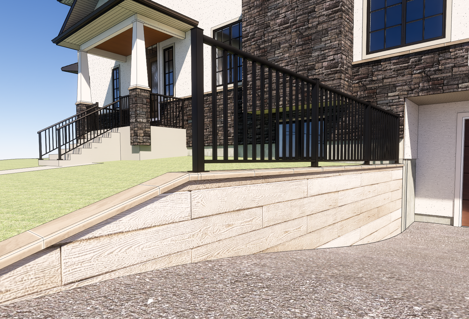

robdyck Posted June 24 Share Posted June 24 (edited) A texture assigned to a solid wall works well. Techo-Bloc has a large library of textures. https://www.techo-bloc.com/shop/garden-and-retaining-walls/borealis-wall/curb-double-side-hazelnut-brandy?parent=6c3b02b2-7af6-4630-ba38-b94137227099 https://www.techo-bloc.com/support/resources/technical-resources/designers-toolbox Edited June 24 by robdyck 2 Link to comment Share on other sites More sharing options...
KarenMM Posted June 24 Author Share Posted June 24 Thanks @robdyck i will check these out! 1 Link to comment Share on other sites More sharing options...
robdyck Posted June 24 Share Posted June 24 (edited) I found the website before I found my own files! Hope that helps! Edited June 24 by robdyck 1 Link to comment Share on other sites More sharing options...
robdyck Posted June 24 Share Posted June 24 1 Link to comment Share on other sites More sharing options...
