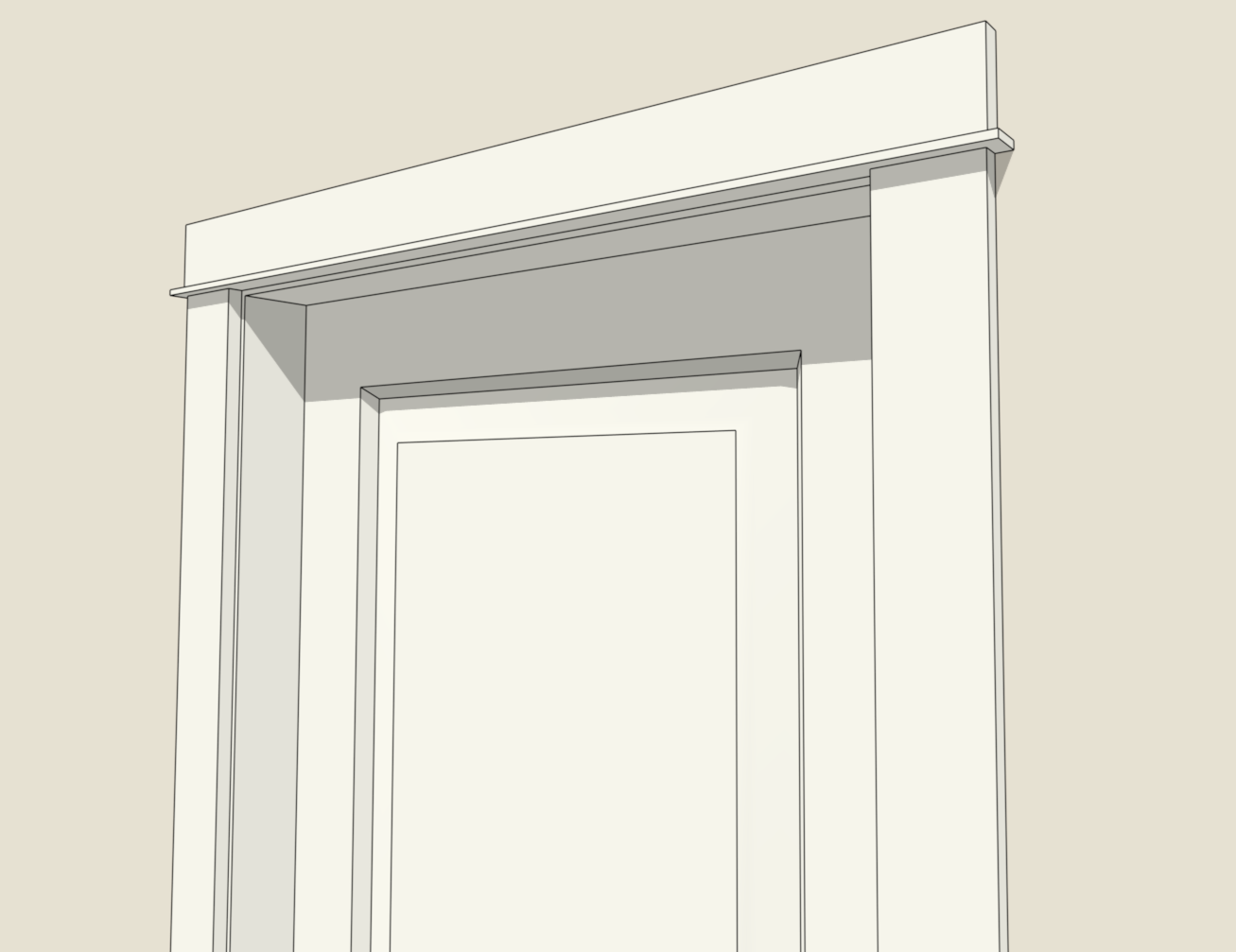

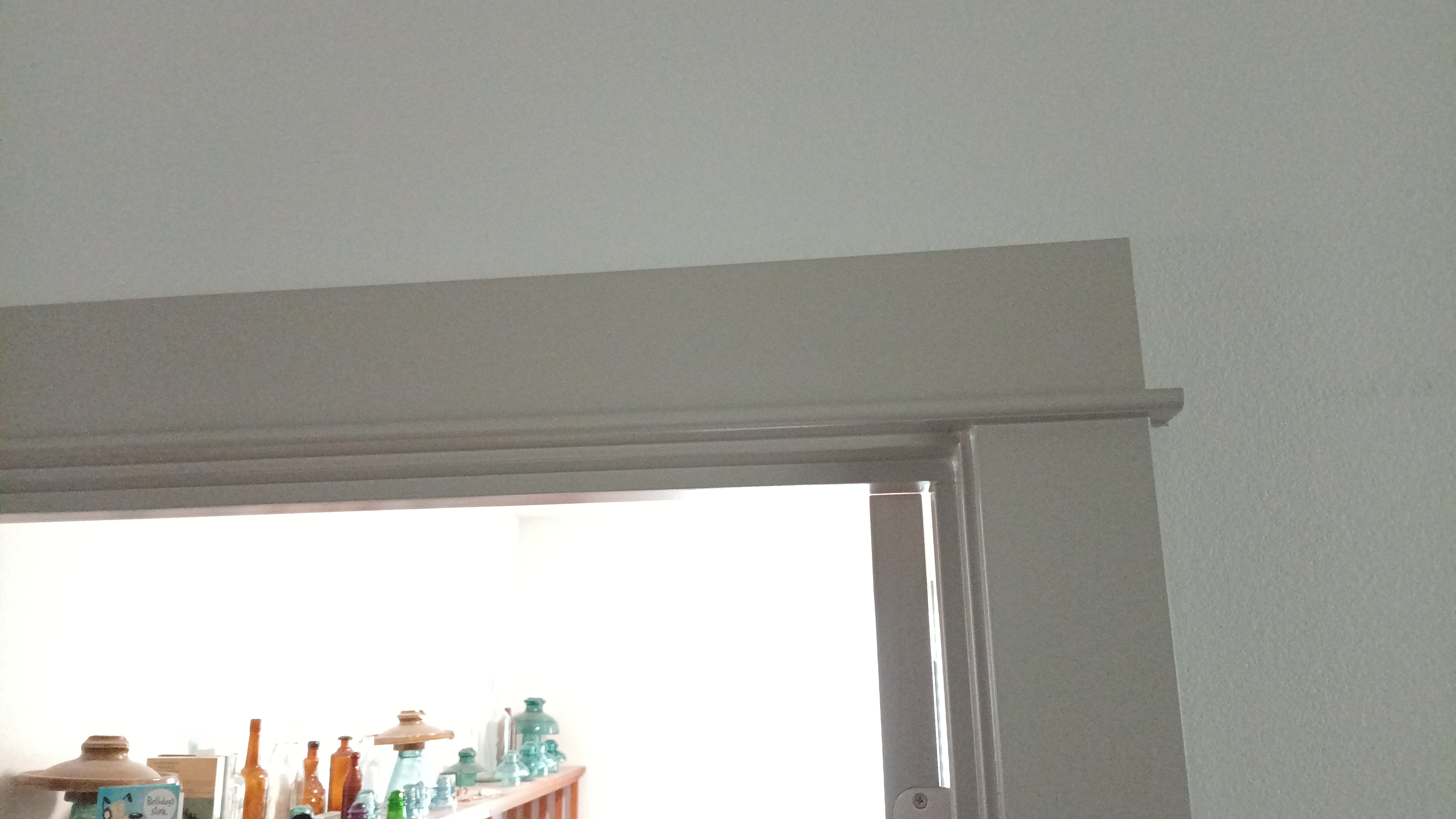

Drew-PRH Posted Saturday at 01:38 AM Share Posted Saturday at 01:38 AM Good day, I was looking to replicate the existing interior door trim for a client addition. I have not had the opportunity to do this as yet, and can not find in the Interior door Defaults / Casing (or Lintel) where I can add another molding. Looking to add a piece of stop (WM 954) just below the head casing, resting atop the door legs. Might there be a way to accomplish this for a door? Much appreciated - thank you!! - Drew Link to comment Share on other sites More sharing options...
DBCooper Posted Saturday at 04:21 AM Share Posted Saturday at 04:21 AM You should be able to create a custom molding profile to do that. Just create a profile that represents both pieces and then use it as your lintel. Will probably need to turn on "wrap" to make it look right. 1 Link to comment Share on other sites More sharing options...
