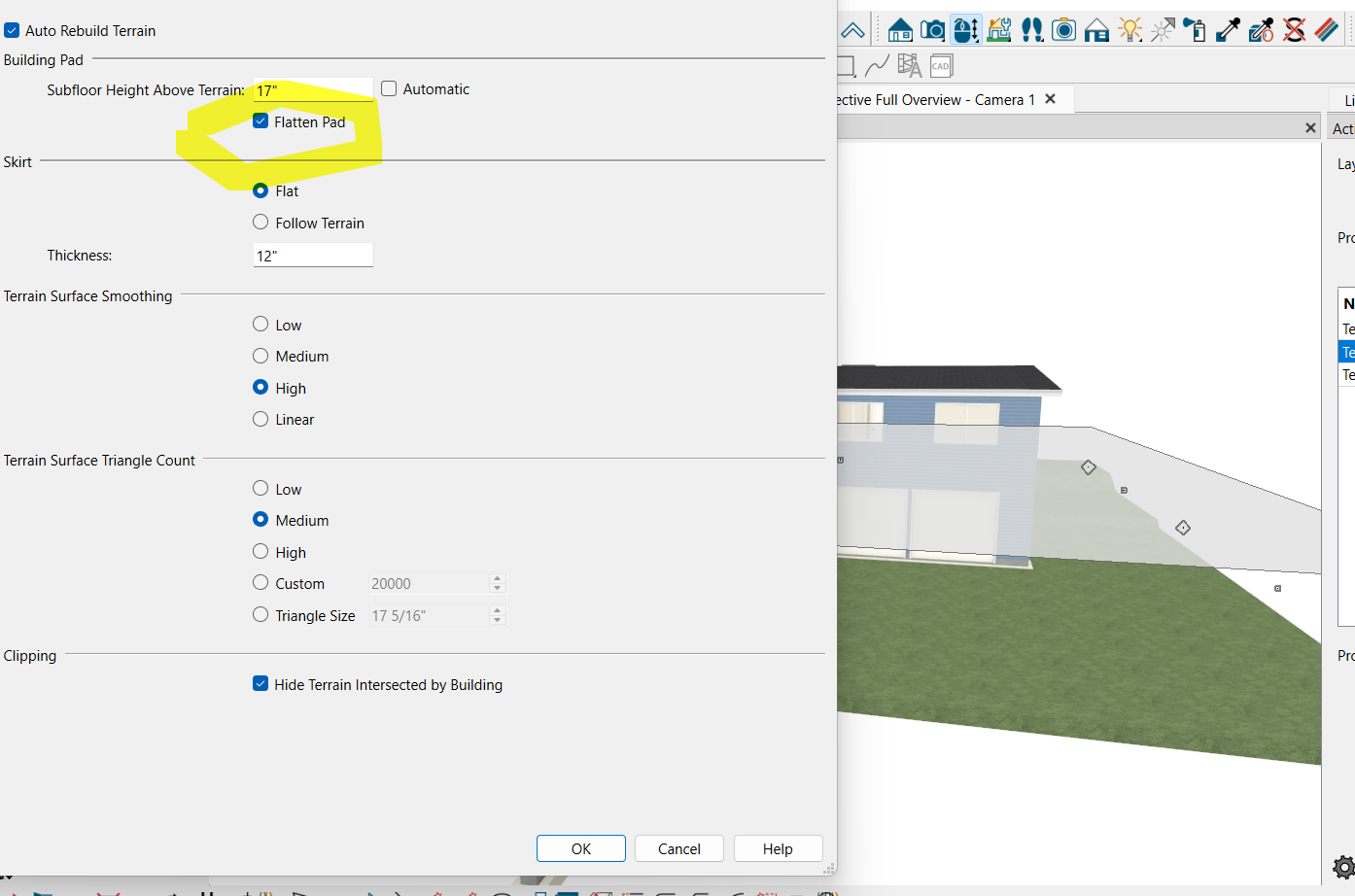

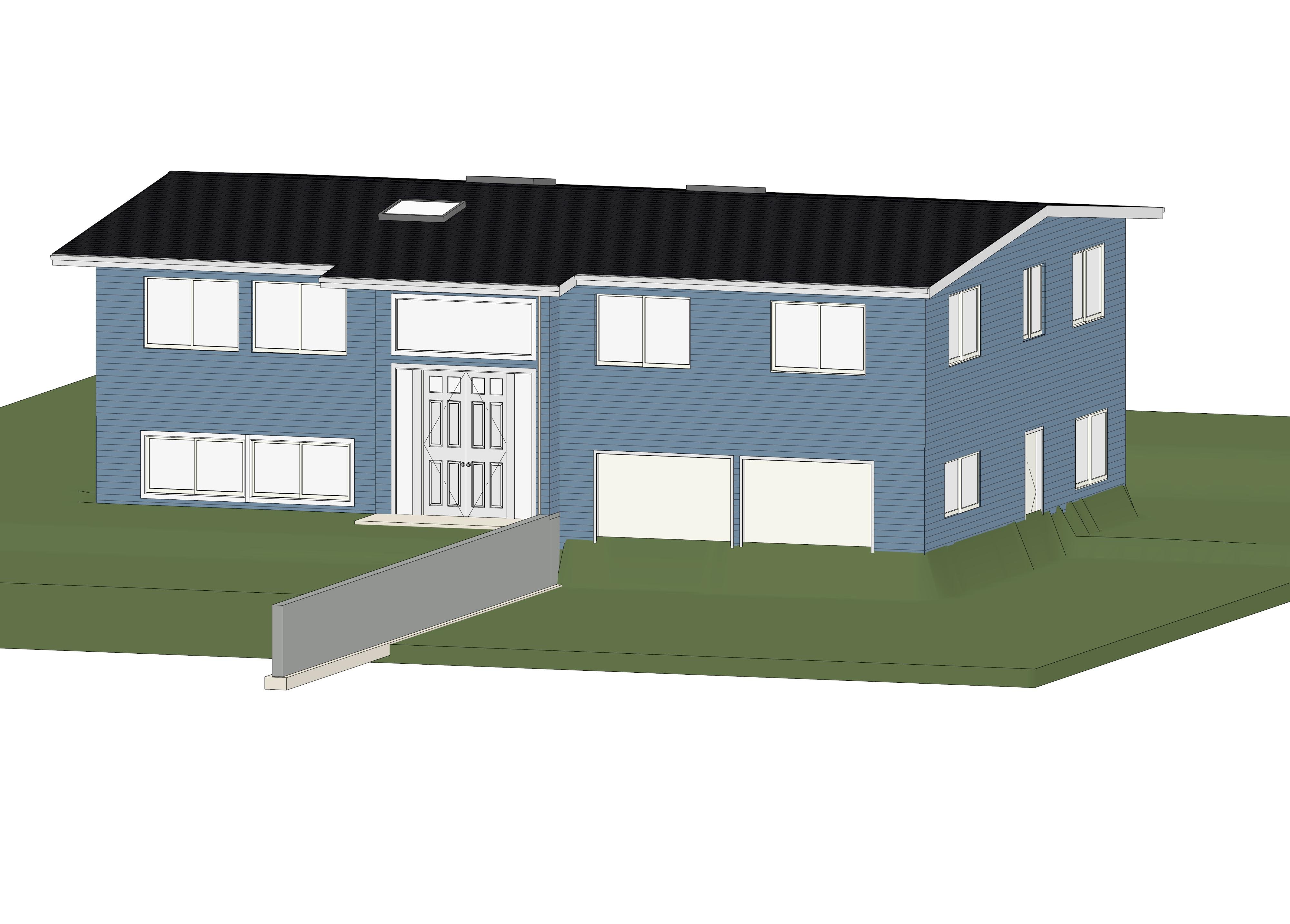

msmith964 Posted June 11 Share Posted June 11 For some reason the terrain regions I created aren't working properly where they meet the house. The elevation jumps up to the terrain perimeter height when it meets the house. Any suggestions? I have attached pic and the plan. Thanks! Michelle Pro 16 Henderson.zip Link to comment Share on other sites More sharing options...
Mark3D Posted June 11 Share Posted June 11 Untick flatten building pad Link to comment Share on other sites More sharing options...
