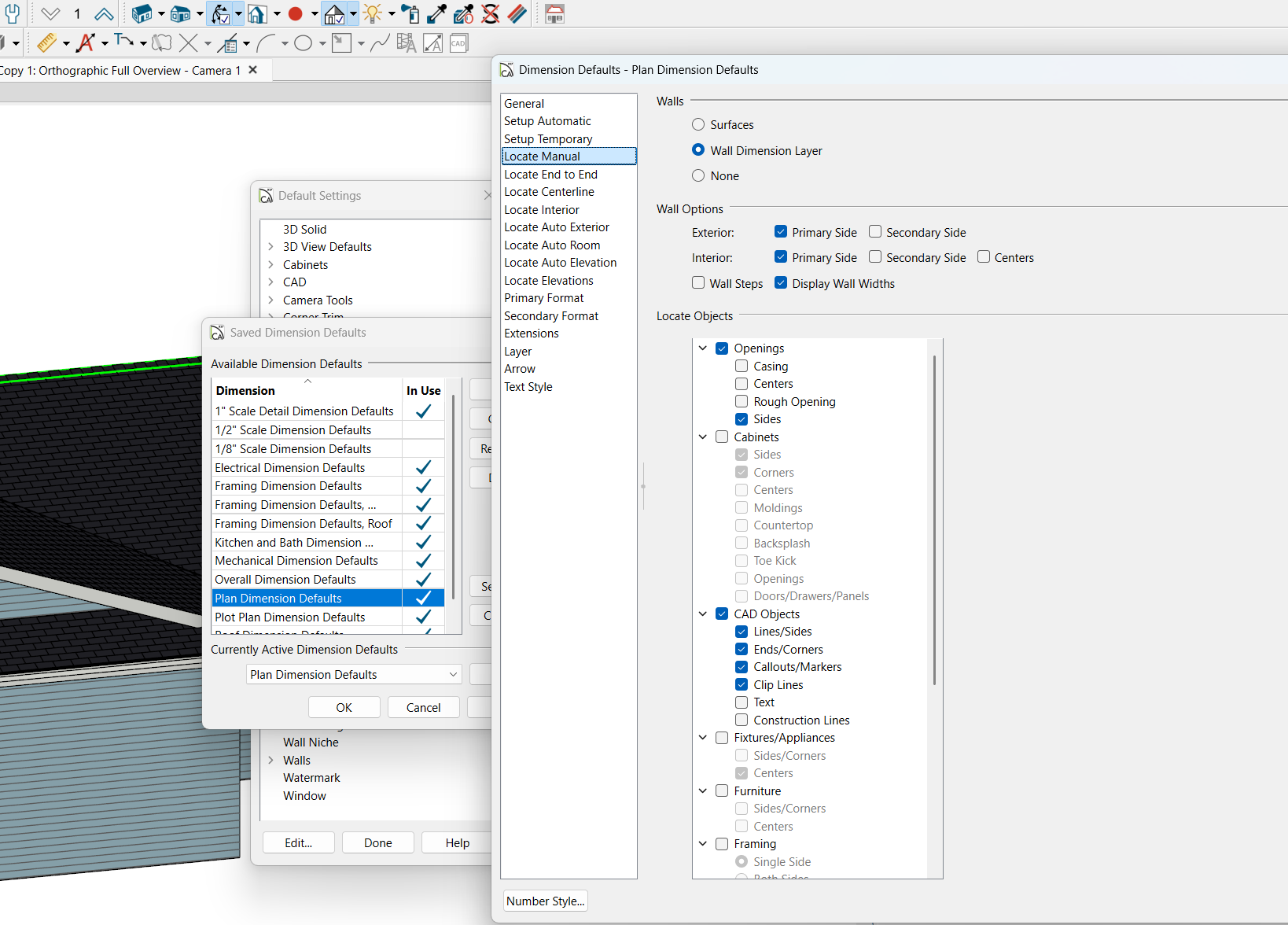

newfoundland1 Posted Saturday at 11:15 PM Share Posted Saturday at 11:15 PM i just migrated from X7 to X17, quite the change, after reviewing almost all of the training videos in the past 3 weeks, i am having trouble setting the defaults for locating the dimension lines to show from the sheathing of exterior walls to center of interior walls. Had no problem with getting dimensions set to center of windows and doors. Have tried several times with the defaults settings. It is a simple thing, what am i doing wrong. Link to comment Share on other sites More sharing options...

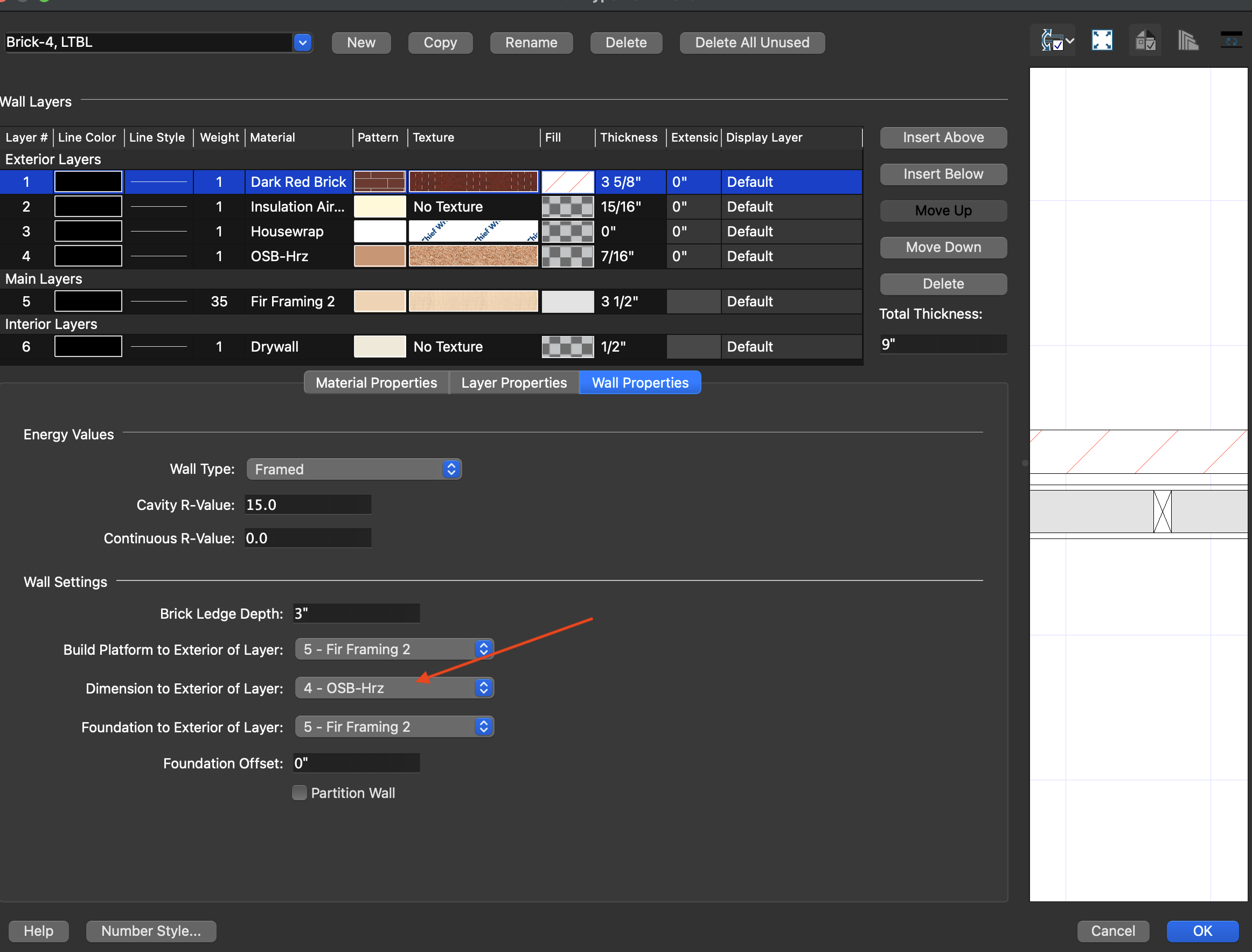

PitMan71 Posted yesterday at 03:22 AM Share Posted yesterday at 03:22 AM Check your wall definition settings under wall properties tab. Link to comment Share on other sites More sharing options...
SHCanada2 Posted 16 hours ago Share Posted 16 hours ago centers on this dialog? Link to comment Share on other sites More sharing options...
