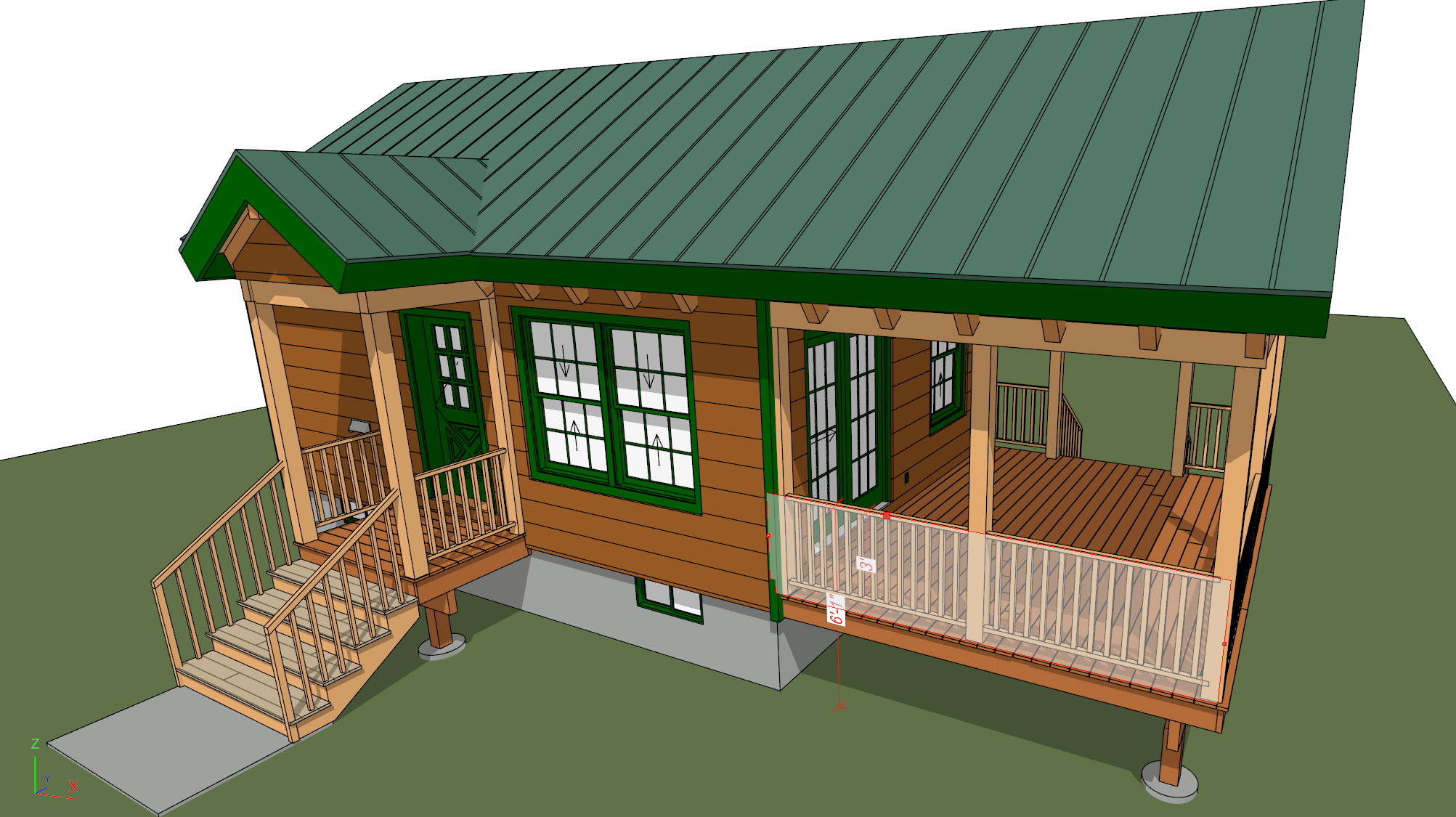

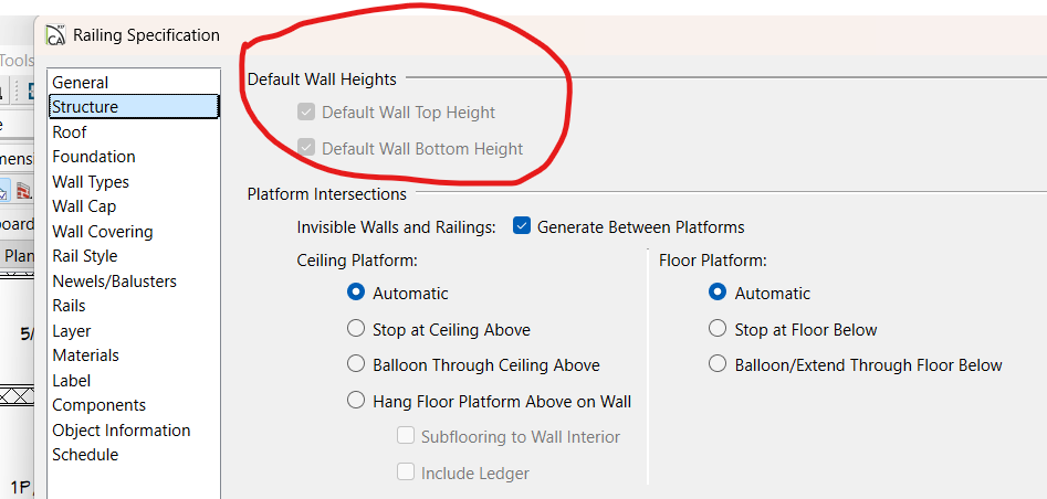

Ed_Orum Posted April 28 Share Posted April 28 I want to change the height of the Porch Railings. Currently they are 31" above the Deck Surface. The Deck Surface is 5" below the Sub-Floor. It appears the deck railings are referencing the Sub-Floor instead of the Deck Surface. In the dialog box, the "Default Height" is checked and grayed out so I can't make a change. Screenshot attached as well as the plan file. How can I change the height of the Porch Railings? Thanks, Lane Cozy Cabin Plan File.zip Link to comment Share on other sites More sharing options...

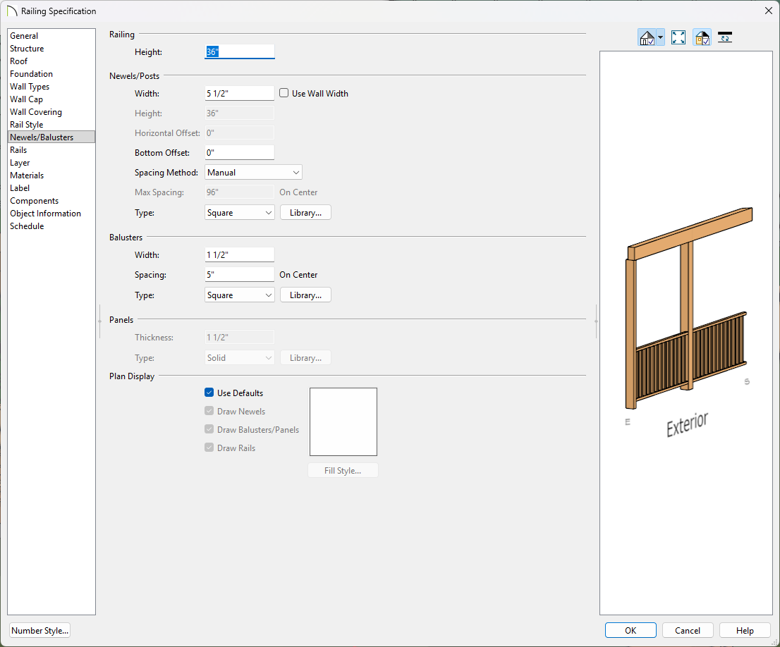

DBCooper Posted April 28 Share Posted April 28 The default wall heights will only be available if you have manually changed the wall top or bottom height in a camera view. Normally, you wouldn't do this for a railing wall though. It looks like your railings are currently 36" above the deck surface: If you want to change the railing height, you can do that on the newel/baluster page: Also, I had to rebuild the deck framing for the stair landing to show. Link to comment Share on other sites More sharing options...
