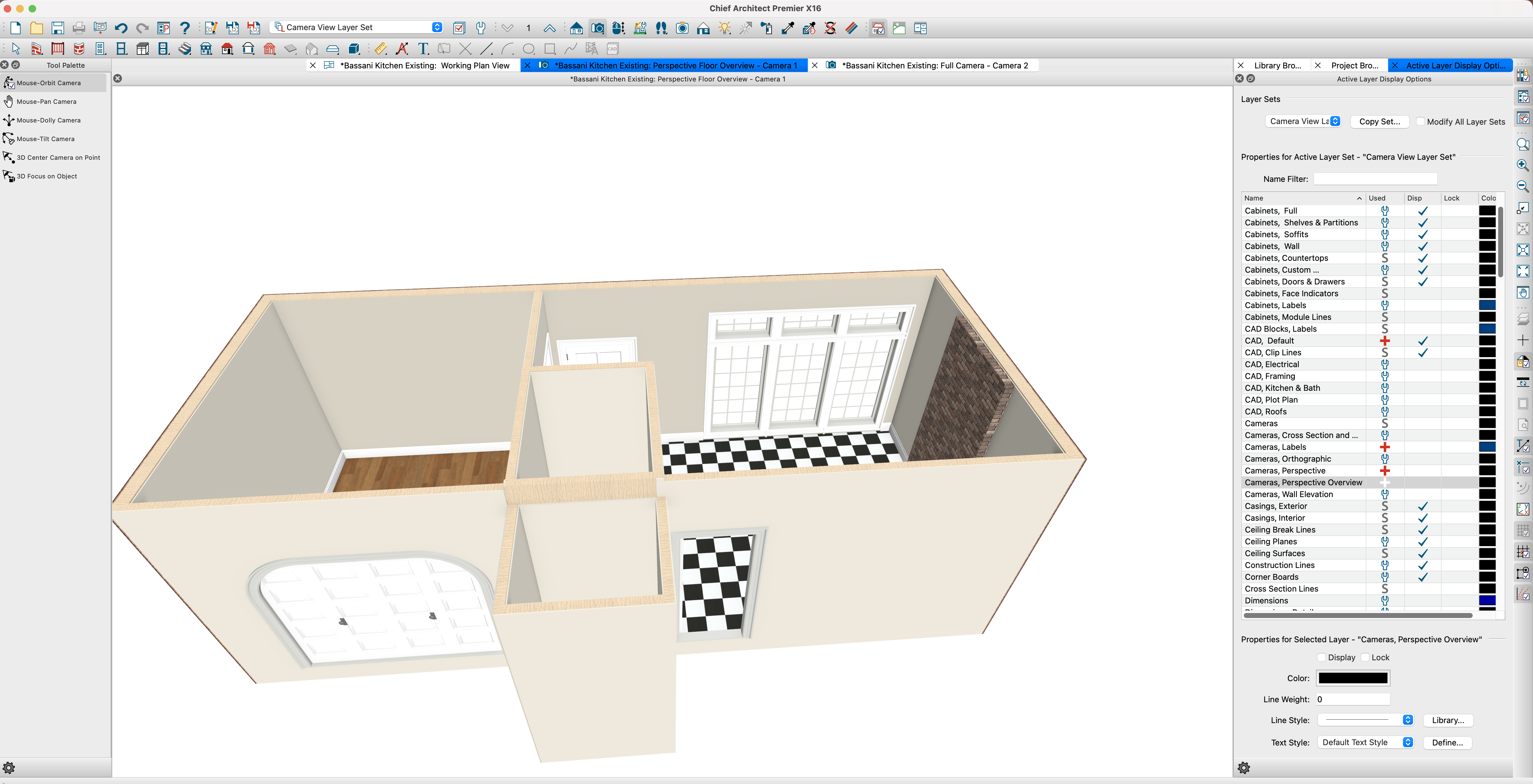

TravisKetron Posted April 28 Share Posted April 28 (edited) Hello. I am struggling to change the backdrop from white. I have tried in the settings (camera tools -> Perspective Floor Overview -> backdrop) to change backdrop, use generated sky, spherical panoramic backdrop and background color but none of these have changed the view. TIA! Answered my own question- Somehow my backdrop was cleared (even though i had added one). No need for assistance anymore thanks! Edited April 28 by TravisKetron answered my own question 1 Link to comment Share on other sites More sharing options...
Solution DBCooper Posted April 28 Solution Share Posted April 28 (edited) Just an fyi, this will depend on what rendering technique you are using. The rendering technique can be setup to use the backdrop or not. The key thing is that the background color is only used when the backdrop is not used. Also, you can change this for any particular camera view using the "edit active view" tool or you can change it in your camera defaults if you always want your new views to look the same. On a side note, not sure why you were downvoted but maybe it's because your picture is missing? Edited yesterday at 04:29 PM by DBCooper 1 Link to comment Share on other sites More sharing options...
