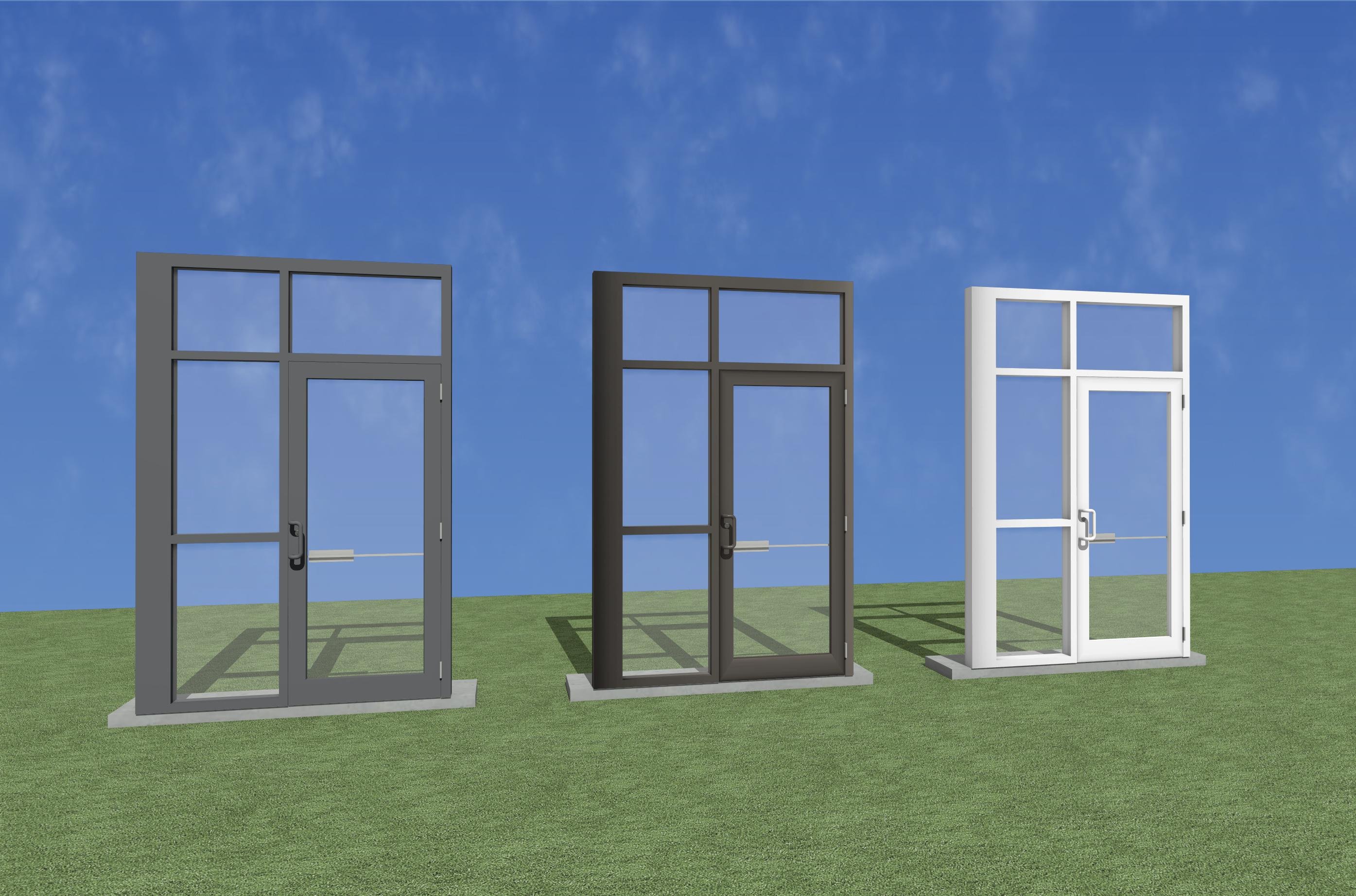

RobDesLLC Posted April 29 Share Posted April 29 I made a wall type to create the frame, then a frameless window to create glass openings, and then an appropriate matching door. I then saved this wall assembly in my library in three different finishes - white powdercoat, dark bronze powdercoat, and aluminum. 3 Link to comment Share on other sites More sharing options...
NRST8TRKR Posted May 5 Share Posted May 5 Nice, could you post the symbol. Have a Great Day,Ken 1 2 Link to comment Share on other sites More sharing options...
RobDesLLC Posted May 7 Share Posted May 7 On 5/5/2026 at 4:03 PM, NRST8TRKR said: Nice, could you post the symbol. Have a Great Day,Ken Here you go Storefront Glass.zip 2 1 Link to comment Share on other sites More sharing options...
