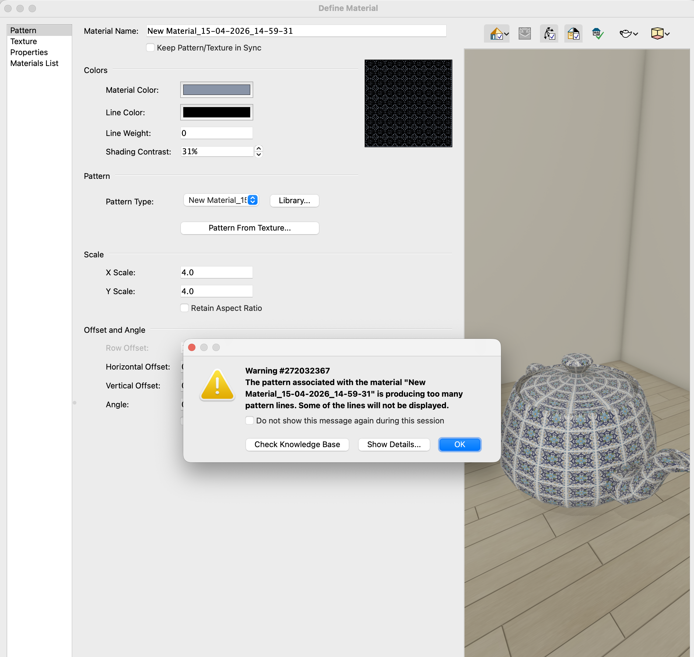

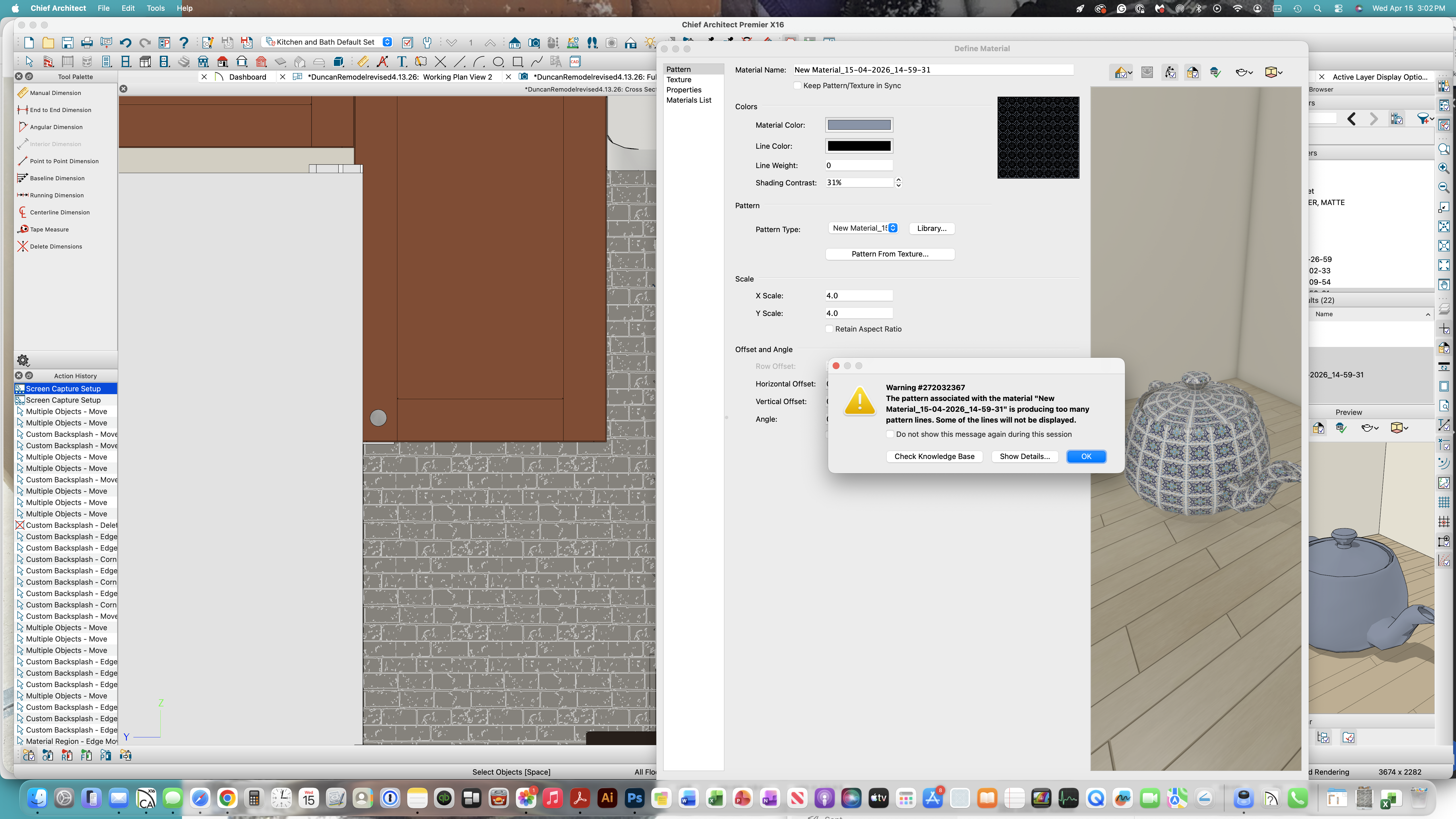

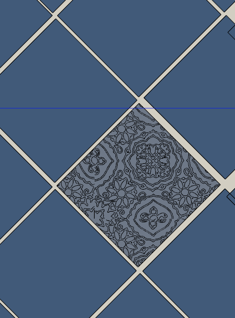

creatrix Posted April 15 Share Posted April 15 I'm befuddled by how to get a Talavera tile into my Library Browser so I can use it in a backsplash accent. Showing screenshots from what happens in trying to get it in the library. If anyone can help, I'd be most grateful. I need to show a client so we can order tile ASAP! I've followed the video tutorial with no success. Can I get no better than what is shown in the last screenshot? maddening . . . Link to comment Share on other sites More sharing options...
scottharris Posted April 16 Share Posted April 16 When you imported the tile, the pattern (vector view) is set to be ‘pattern from texture’. Since it’s a very busy texture, the pattern has too many lines to be displayed in vector views (and other line drawing views). You might change that to be a more simple pattern; and/or show your client a standard render view that uses your texture image. Link to comment Share on other sites More sharing options...
creatrix Posted Friday at 12:58 AM Author Share Posted Friday at 12:58 AM Thanks Scott. Roy helped today by telling me to use stretch to fit and not use the Pattern from texture. Design is till not coming out correct for a tile, which is a drag. But one tile is good. Link to comment Share on other sites More sharing options...
