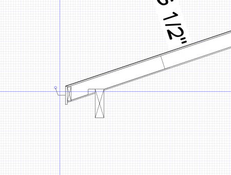

SAWConstruction Posted Thursday at 08:23 PM Share Posted Thursday at 08:23 PM I know the wall placement will move the birds-mouth cut horizontally, but what is the software referencing for the width of the cut? I did not have the software automatically generate the roof framing; I built homes for over 30 years and just don't like how it places some things and it is easy for me to job place what I want and where. I know it isn't based on the wall width; maybe I will just make a rafter end and cut it down to 3.5 and ignore the difference? thanks in advance... Rob Link to comment Share on other sites More sharing options...
evergreen Posted Thursday at 09:55 PM Share Posted Thursday at 09:55 PM In general, build framing should correct that, but best to post plan. Link to comment Share on other sites More sharing options...
glennw Posted yesterday at 12:18 AM Share Posted yesterday at 12:18 AM 3 hours ago, SAWConstruction said: I know it isn't based on the wall width I think it is the wall definition. The horizontal width of the birds mouth cut is dictated by the width of the main layers in the wall definition. Link to comment Share on other sites More sharing options...
SAWConstruction Posted 17 hours ago Author Share Posted 17 hours ago I have an idea that it might be in the overhang of the roof that is stretching it... I will post if that was it. Link to comment Share on other sites More sharing options...

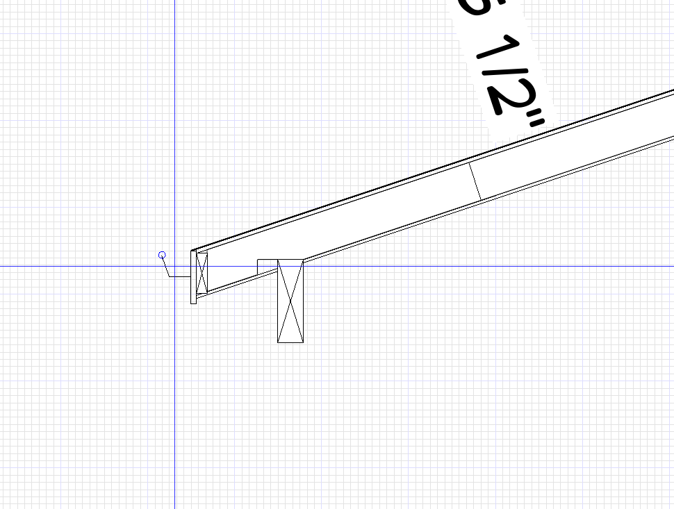

SAWConstruction Posted 16 hours ago Author Share Posted 16 hours ago (edited) I figured out what was going on; I built the roofs manually and I had to open up the roof properties and change it from trusses to rafters, which changed the birds mouth to 0" and displays just fine. Edited 15 hours ago by SAWConstruction Link to comment Share on other sites More sharing options...
