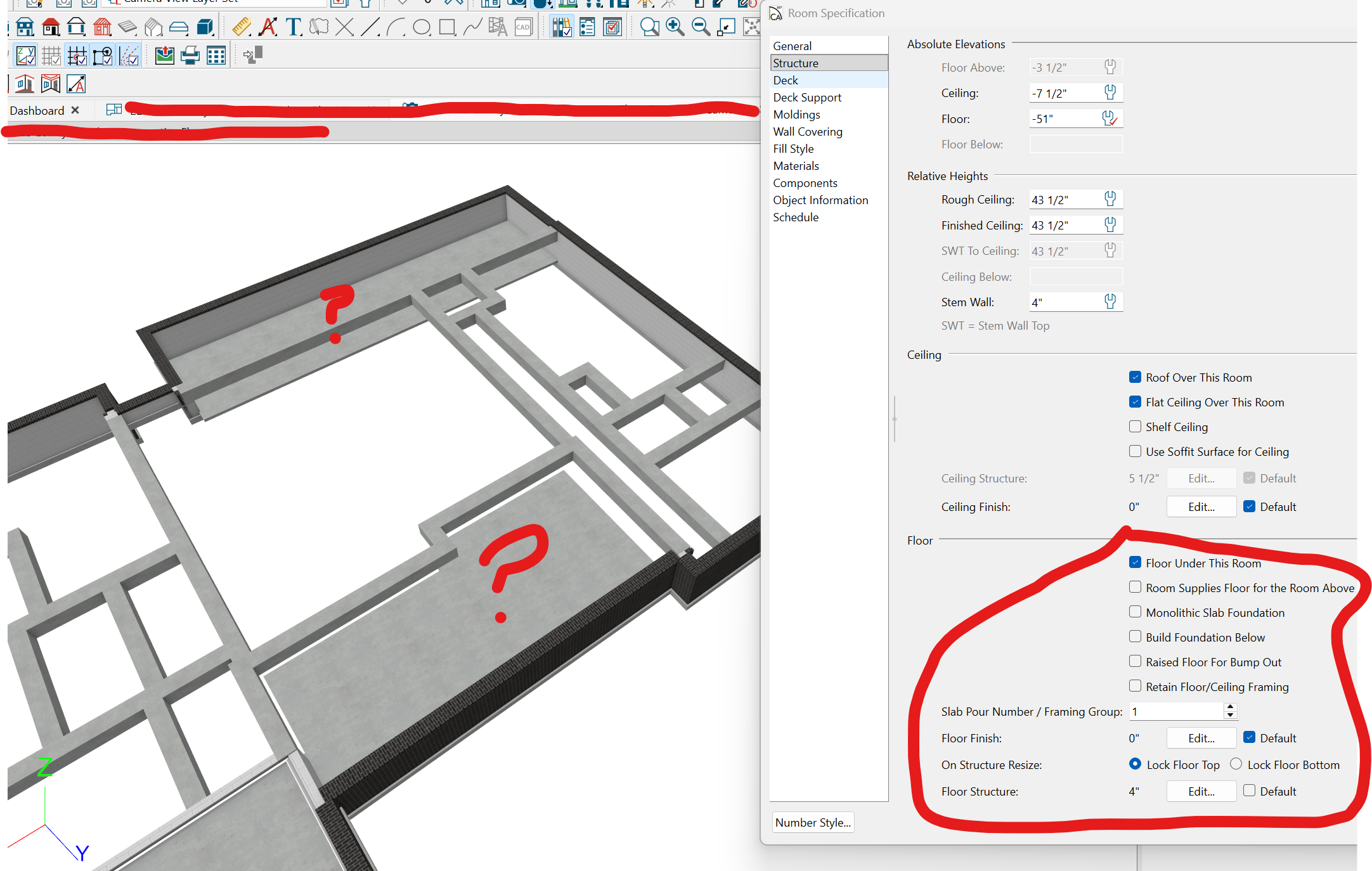

winterdd Posted April 7 Share Posted April 7 (edited) Hey guys, this gets me every now and then. I don't know how it happens, but how do I get rid of the concrete below the main slab? Edited April 7 by winterdd wrong pic Link to comment Share on other sites More sharing options...
Michael_Gia Posted April 7 Share Posted April 7 43 minutes ago, winterdd said: how do I get rid of the concrete below the main slab? Delete that 4” slab in the “floor structure” Link to comment Share on other sites More sharing options...
winterdd Posted April 7 Author Share Posted April 7 7 minutes ago, Michael_Gia said: Delete that 4” slab in the “floor structure” I checked "build fdn below" and it went away but will keep your idea in mind for the next time I have to troubleshoot. Link to comment Share on other sites More sharing options...
