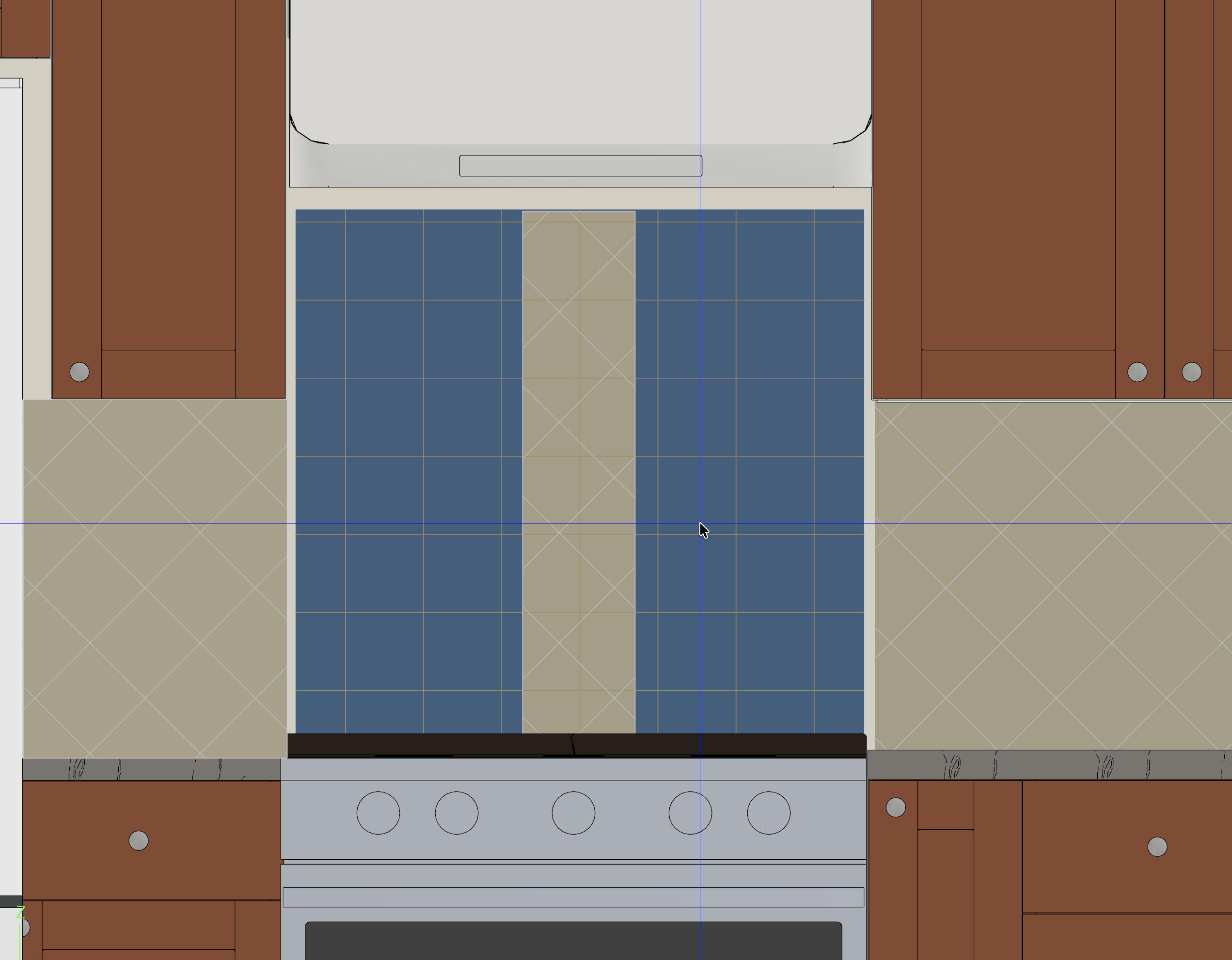

creatrix Posted Tuesday at 01:54 AM Share Posted Tuesday at 01:54 AM Can anyone tell me how to center the diagonal tile within the tan strip in the blue tile area? I’ve adjusted the material region so it contains one full diagonal tile with half tiles on each side, but when I center the region in the blue tile area, the pattern doesn’t stay aligned. Link to comment Share on other sites More sharing options...

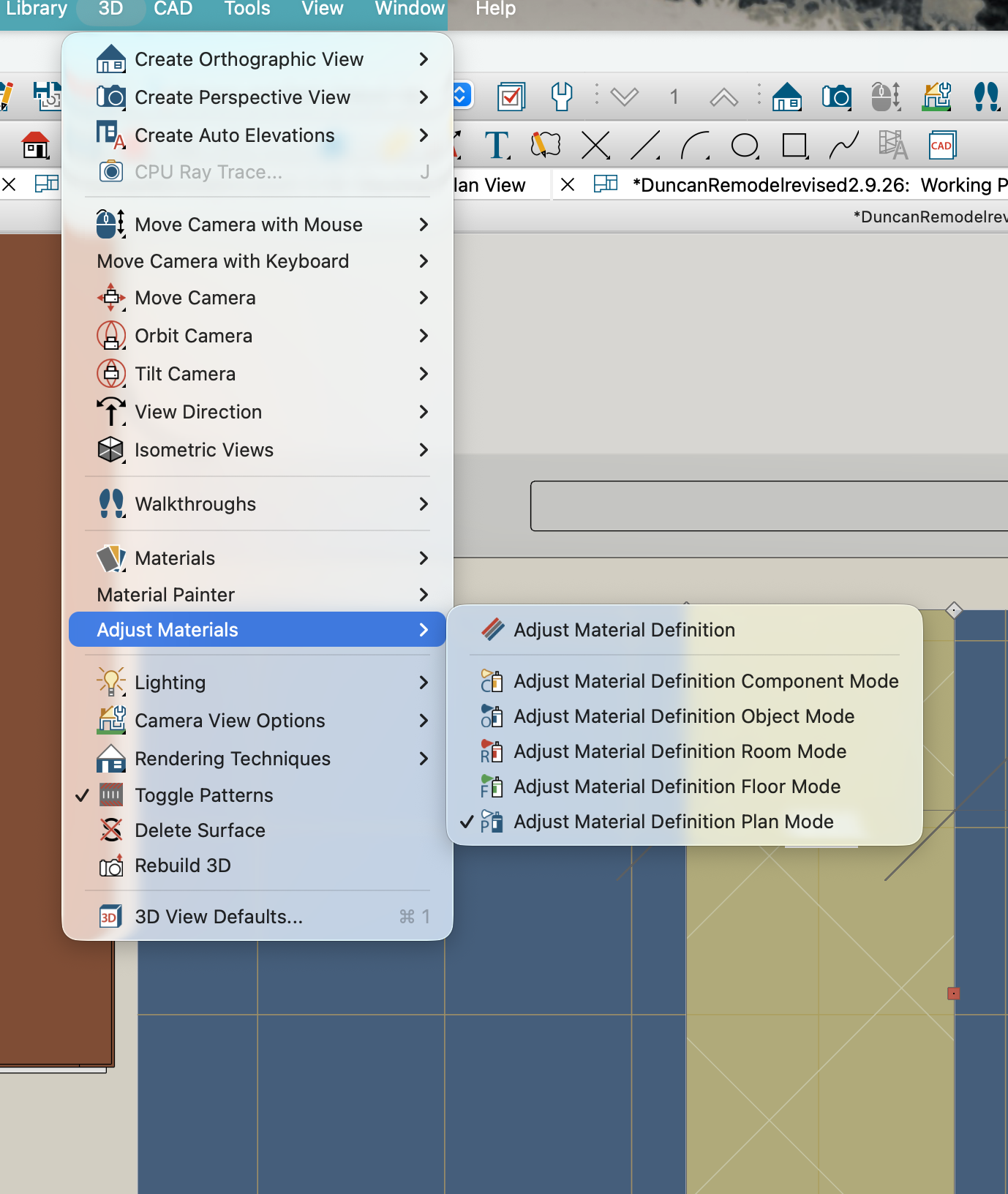

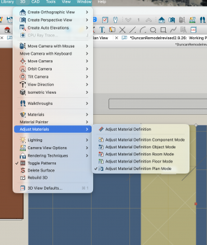

creatrix Posted Tuesday at 03:23 AM Author Share Posted Tuesday at 03:23 AM Mark, what am I not doing to get Interactive material Editor? Link to comment Share on other sites More sharing options...
Mark3D Posted Tuesday at 03:26 AM Share Posted Tuesday at 03:26 AM It is x17 only but x16 this should work Link to comment Share on other sites More sharing options...
creatrix Posted Tuesday at 03:46 AM Author Share Posted Tuesday at 03:46 AM Oh jeez, I can't really tell, with the fuzziness, what you've done. It kind of looks like a 6 but I tried that and it didn't work. Link to comment Share on other sites More sharing options...
