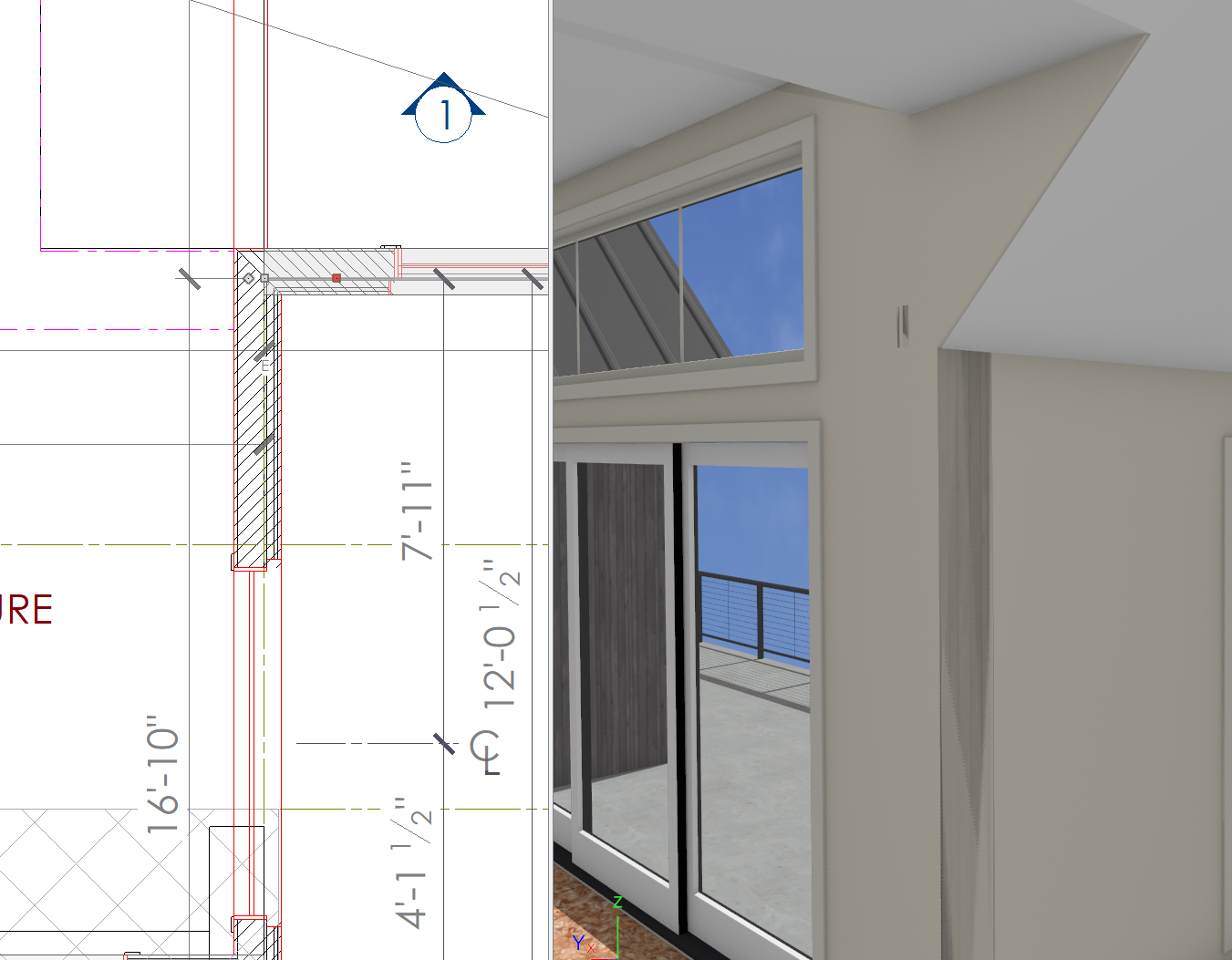

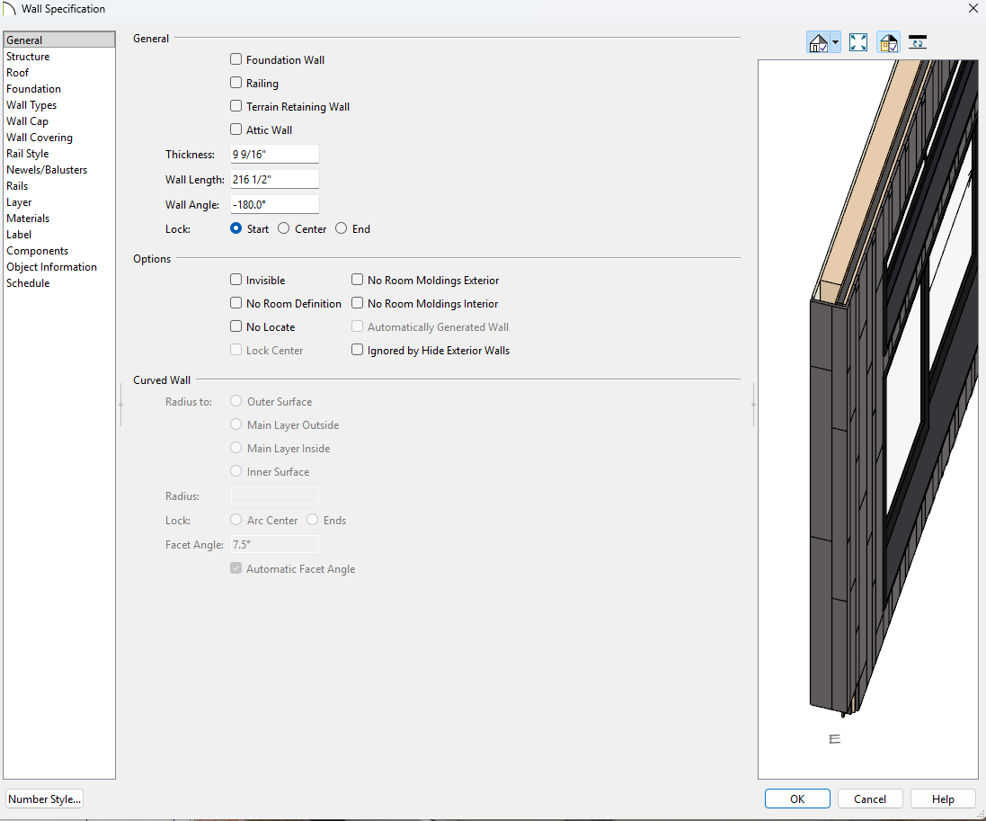

mholley Posted March 25 Share Posted March 25 (edited) So here's my conundrum: In plan the wall ends correctly, but in 3D I can see the exterior siding ghosting through the drywall. How can I keep the siding from wrapping the end like this? I even shows up in the wall dialog...Chasing this down seems like a huge waste of time unless it's something simple. Any help is appreciated. I'm on Premier X17 Processor Intel® Core Ultra 7 processor 265K (3.90GHz, Turbo 5.50GHz)System Memory 64GB DDR5-5600 MHz (2 - 32GB DIMMS)Expansion Card Slot(s) NVIDIA GeForce RTX 5080 16GB (3 Slot)M.2 Storage 1.0TB SSD NVMe/PCIe 5.0 M.2 DriveOperating System Microsoft Windows 11 Professional Edited March 25 by mholley added computer info Link to comment Share on other sites More sharing options...
Solution javatom Posted March 25 Solution Share Posted March 25 Use the edit wall layer intersections tool. Pull the siding back where it intersects the other wall 1 Link to comment Share on other sites More sharing options...
mholley Posted March 26 Author Share Posted March 26 Thank you so much! I knew it was something simple! Link to comment Share on other sites More sharing options...
