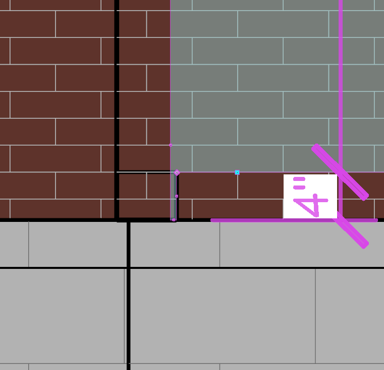

PitMan71 Posted March 11 Share Posted March 11 I have done several brick homes and for some reason on this one I am having some kind of strange thing happening at the corners. The brick wall is extending down into the foundation brick creating block looking artifact on my elevations. You can see it in the image I posted. the wall is set to not extend so I am not sure what's happening and I have checked other brick homes I have drawn with the same method and none of them are doing this so I am not sure what is causing this mystery. thanks in advance for looking. link to file --> https://www.dropbox.com/scl/fi/2e0rhz16wyi68ykdnuigw/260005-21A.plan.zip?rlkey=z1z8gw05omixm6e4yay0802d5&dl=0 Link to comment Share on other sites More sharing options...

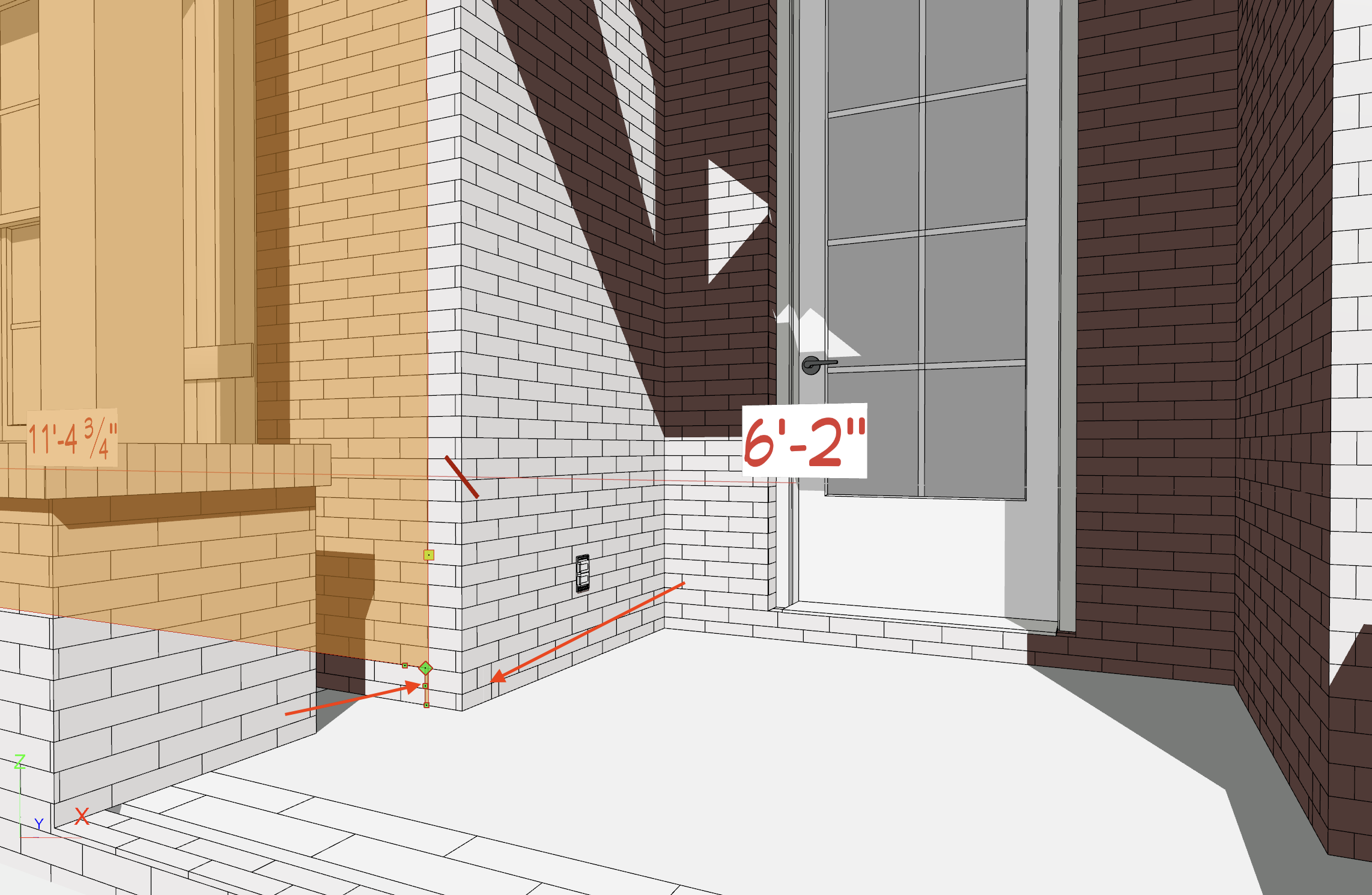

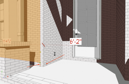

Chrisb222 Posted March 12 Share Posted March 12 13 hours ago, PitMan71 said: thanks in advance for looking. Shane, I didn't bother to track down the cause, I just went to fix it. If you select the wall in elevation or 3D, you can see the little stem projecting down. Just grab it and slide it up to align with the bottom of the wall: This cancelled "Default Wall Bottom" in the wall specification dialog under Structure, so something is wrong somewhere. But personally I don't usually fight the program on stuff like this, as long as it doesn't cause a worse problem elsewhere. I just find a fix and move on. Hope this helps. 1 Link to comment Share on other sites More sharing options...
