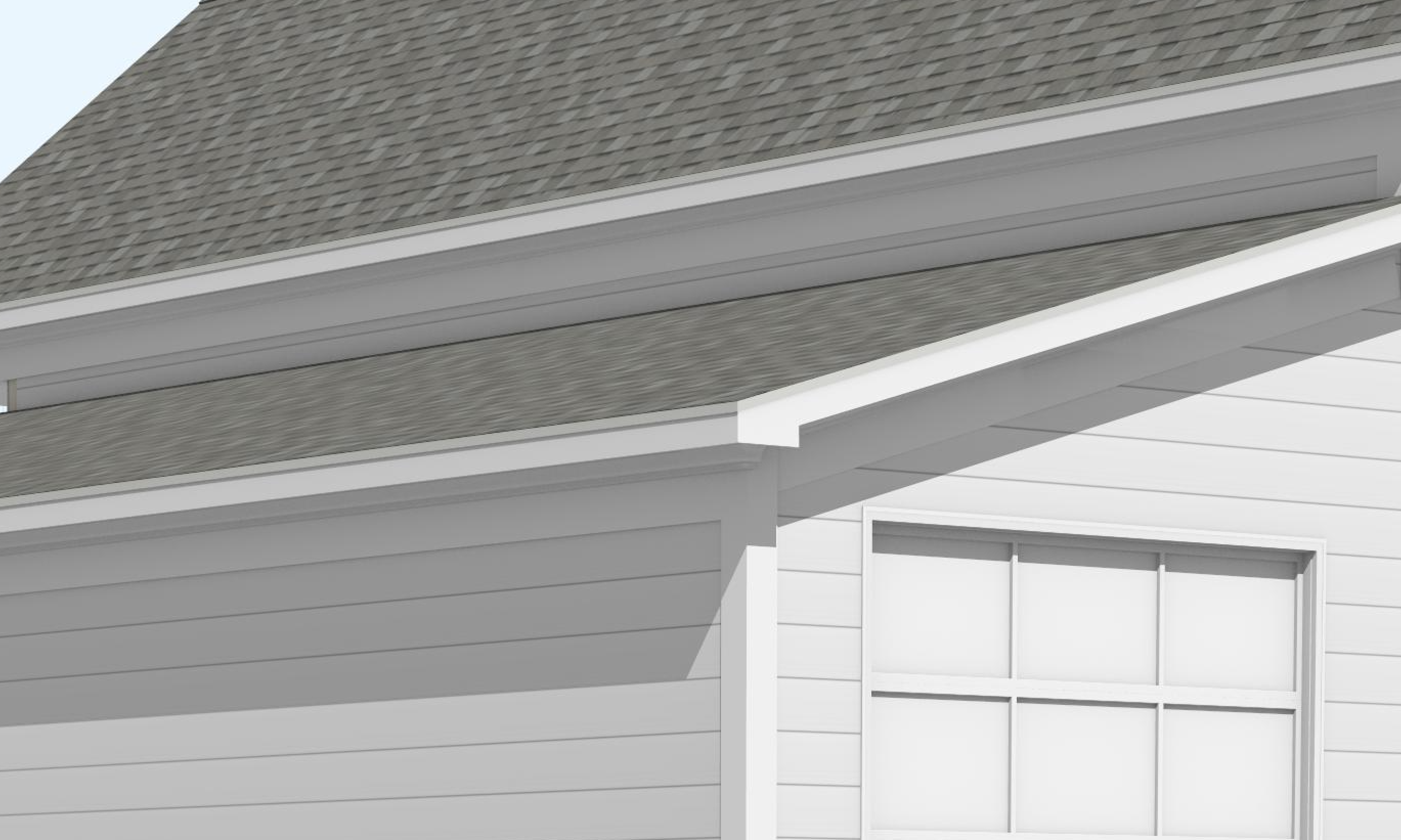

Steve-C Posted March 6 Share Posted March 6 Has anyone figured this out yet? I get super crisp images and shadows on both of my PC rigs but on my Mac laptop I get this garbage. Normally I wouldn't care but I'm going to be out of town quite a bit over the next few months and I would really like to get this figured out. My current Mac is a 15" Macbook Air but I got the same results when I had a Mac Studio with an M3 Ultra. Link to comment Share on other sites More sharing options...

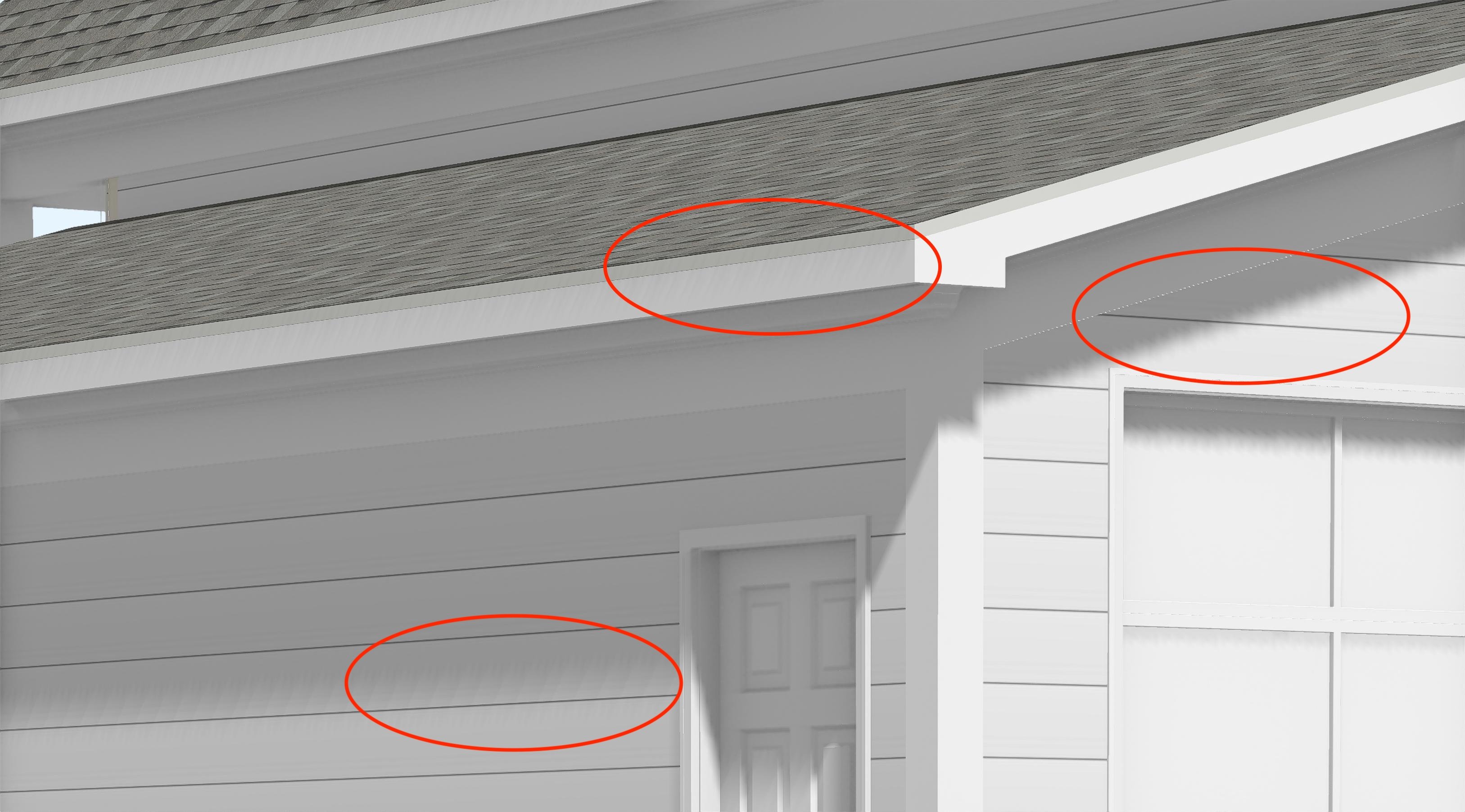

Steve-C Posted March 6 Author Share Posted March 6 (edited) To compare here is the same image from Windows Mac used to have a "sharpen image" option a few years ago but they got rid of it. I have messaged tech support about this a couple of times but they gave me some BS about having to create a new template every so often when using a Mac. I tried that and still had the same results. Edited March 6 by Steve-C Link to comment Share on other sites More sharing options...

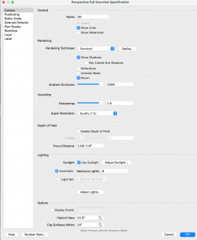

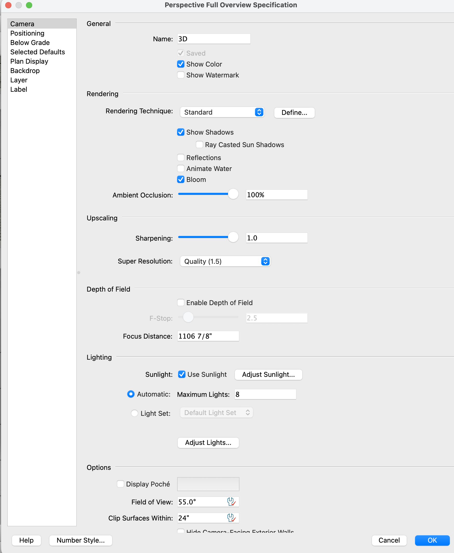

glennw Posted March 7 Share Posted March 7 (edited) Can you post a screenshot of the camera dbx>General panel. Edited March 8 by glennw Link to comment Share on other sites More sharing options...
Steve-C Posted March 10 Author Share Posted March 10 Settings are the same for Mac and Windows Link to comment Share on other sites More sharing options...
