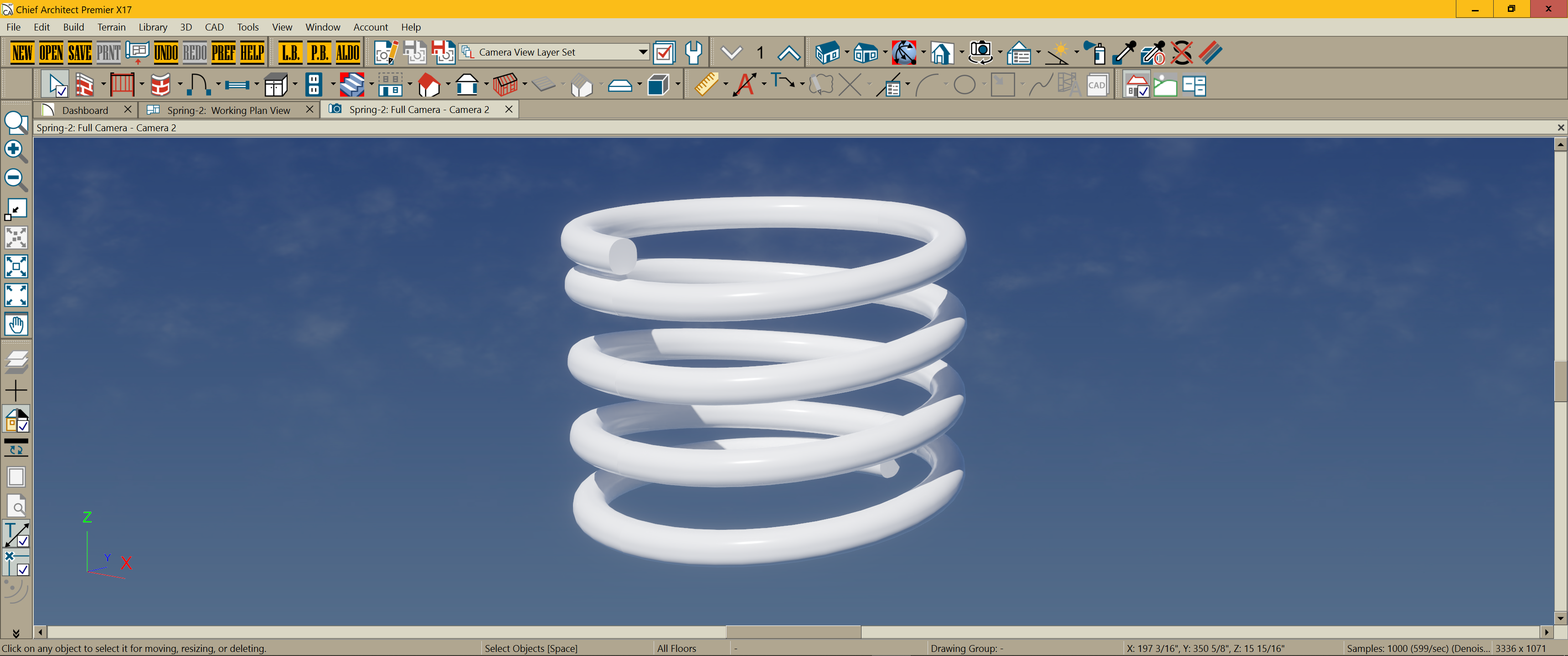

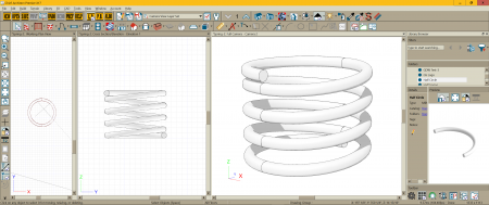

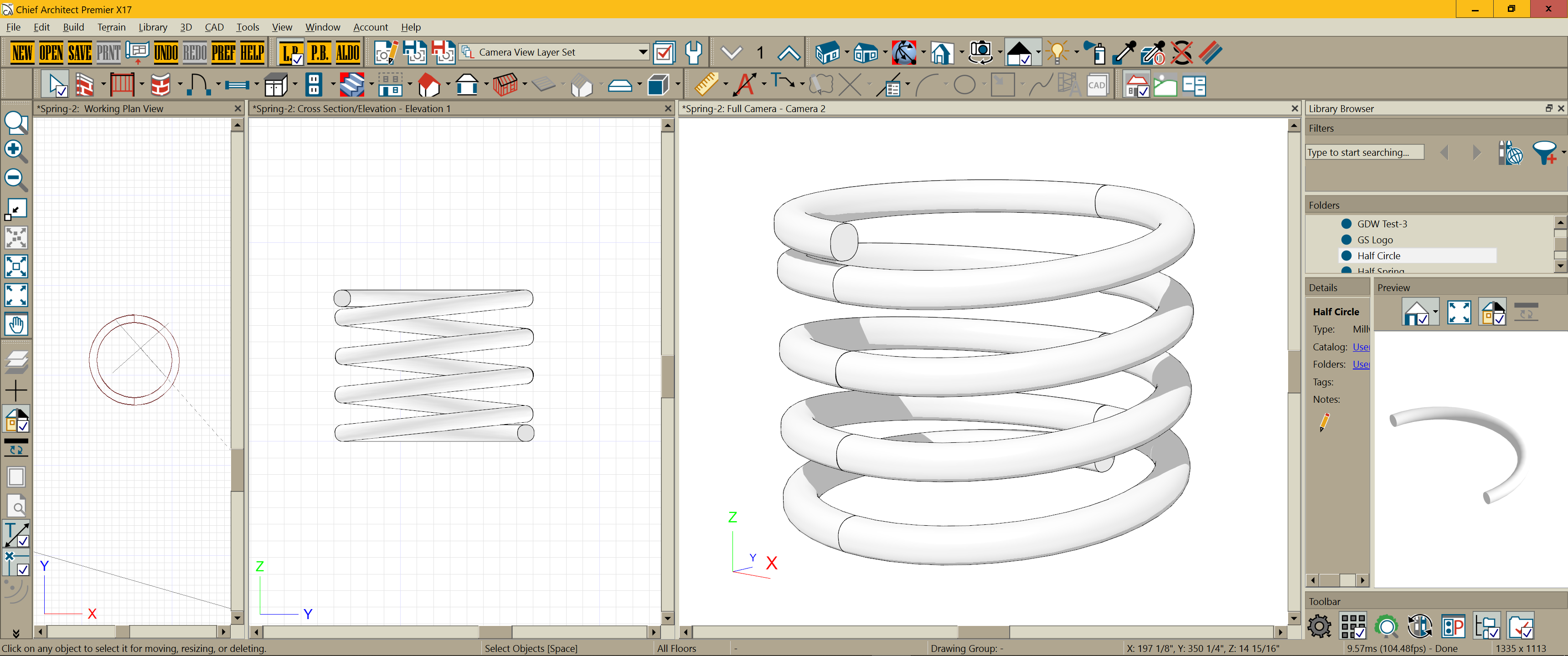

Rich_Winsor Posted March 2 Author Share Posted March 2 (edited) So I wanted a realistic looking spring for a model of some equipment we are looking to purchase. Apparently I’m not smart enough to create a helical 3D polyline molding and to prove it I frittered away a couple of hours trying to make it work. Finally I gave up and packed it in for the night. Now I’m not saying that I had a Keith Richards (Satisfaction) moment but when I woke up in the morning I had an idea of how to build a helix out of 3D solids. I built the spring in about 15 minutes out of 9 identical 3D solid half rings. Edited March 2 by Rich_Winsor 1 Link to comment Share on other sites More sharing options...
