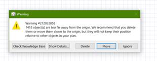

timelliott Posted February 20 Share Posted February 20 Hi there, I'm a new user looking to make sure our 3D topographical survey will load into Chief before I sign up. I'm having a couple of problems I'm wondering if any users or admins can help with. I have followed the videos for importing a .DWG file. There is no site boundary on the drawing, so I drew one with a polyline and tried to convert it to terrain perimeter but the radio button in the dialog box is greyed out, I couldn't find any article on the knowledge base that would help with this: Firstly, I did get this warning when importing the file, but pressed ignore as this seemed to be the only way that the CAD would import Then this is the polyline I drew for the terrain boundary: But when I press the Convert polyline button at the bottom the box doesn't allow me to set it as a perimeter Also, when I did the import I selected Contours - Primary (from the DWG file) and mapped to the Terrain, Primary Contours layer, but the actual contour lines from the CAD disappear even though the layer is visible. I'm not sure if this is supposed to happen or not, but it would be helpful to see them. Some help would be appreciated as I need to make sure this CAD and terrain mapping etc can be done before I would purchase the product. Many thanks Tim Link to comment Share on other sites More sharing options...

JiAngelo Posted February 21 Share Posted February 21 You already have a terrain. Look at your layer set image. The Terrain Perimeter has a plus sign indicating this is so. You can either delete it, then try converting the polyline, or break the edges of the existing terrain and drag them to each polyline point location until you've matched your desired shape. The error message is to let you know the surveyors file is based on real world dimensions. If you choose "ignore", any work you do will be at the real world location and can be exported back to your surveyor or any gis devices you may have for immediate use. When you chose "move", everything is relocate to the origin. Any work you do would require the surveyor open your export, then cut and paste your changes to his real world location to use with his devices. Link to comment Share on other sites More sharing options...
