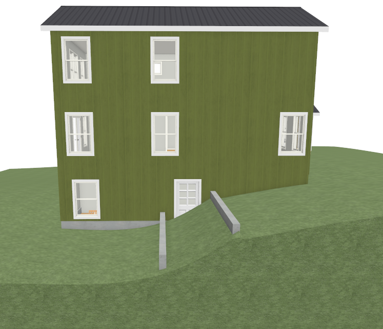

Jambruins Posted February 19 Share Posted February 19 I have a sloped site and I am trying to get a door with retaining walls on each side of the door. I have a terrain line with elevation 0 at the high side of the house, an elevation line with elevation -72 at the low side of the house and an elevation line with an elevation -48 in the middle of the house. This may not be the correct way to start so please let me know if I should be using a different method. How do I get the grade to be flat and at the bottom of the foundation (-72 elevation) between the retaining walls for the door? Thanks for the help. Link to comment Share on other sites More sharing options...

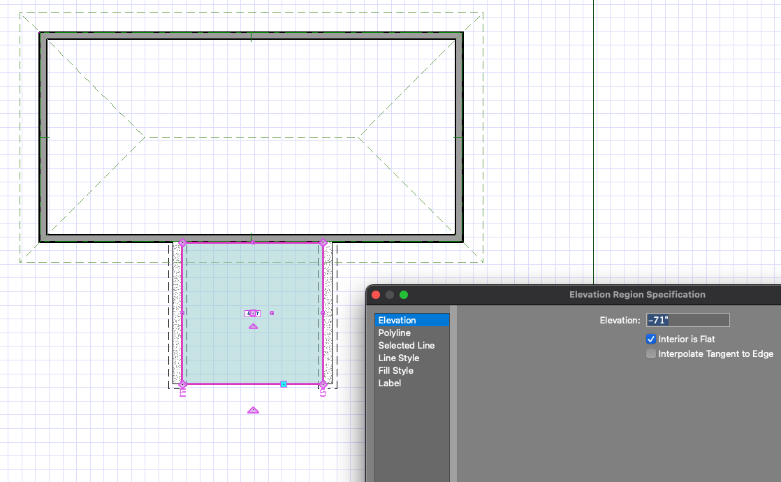

Chrisb222 Posted February 19 Share Posted February 19 (edited) 1 hour ago, Jambruins said: How do I get the grade to be flat and at the bottom of the foundation Try an Elevation Region: Terrain > Elevation Data > Elevation Region Edited February 19 by Chrisb222 Link to comment Share on other sites More sharing options...
