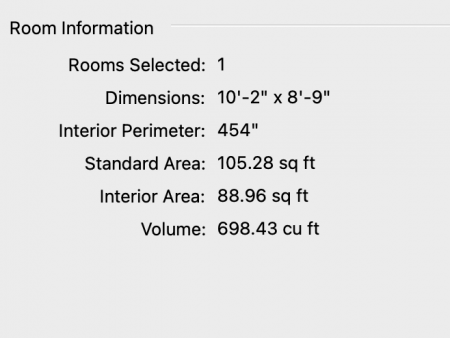

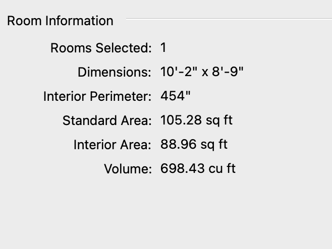

TressaDesigns Posted February 14 Share Posted February 14 Can anyone advise on whether to use the ‘standard area’ or ‘interior area’ for permitting? Thanks in advance Much appreciated! Link to comment Share on other sites More sharing options...
para-CAD Posted February 15 Share Posted February 15 Standard is what is used for the government taxing purposes. 1 Link to comment Share on other sites More sharing options...
Gawdzira Posted February 15 Share Posted February 15 Ask your planning department that you are submitting to. Most of the AHJ's i deal with are measuring the outside layer of the siding. 1 1 Link to comment Share on other sites More sharing options...
