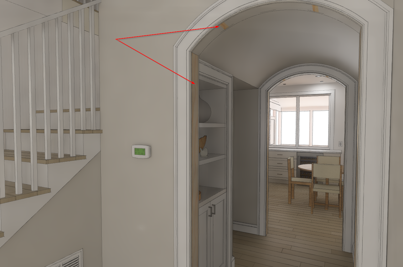

ClassicBob Posted January 13 Share Posted January 13 Is there a way to not have the wood stud showing through the casing on these arched openings? X17 - Windows 11 - RTX3080 1 Link to comment Share on other sites More sharing options...
joey_martin Posted January 13 Share Posted January 13 Is the Jamb turned off? Did you increase the size of the opening and not re-frame the wall? 1 1 Link to comment Share on other sites More sharing options...
PitMan71 Posted January 13 Share Posted January 13 Turn off the framing layer in that camera. 1 Link to comment Share on other sites More sharing options...
