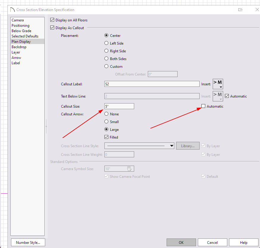

How can I change the size of the text in an elevation label? image.png.4aef63e2693341712658efbbdf1c8e33.png The text is too large for the size of the call out - I would prefer to make the symbol smaller and the text even smaller and can't figure out how to do it.

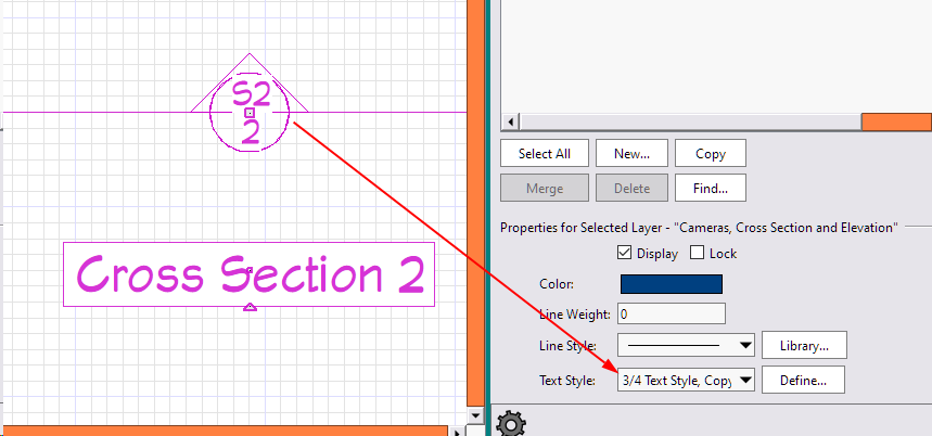

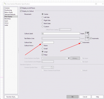

To make the symbol smaller open object, plan display, uncheck automatic, type in size

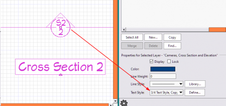

The text size is controlled by the layer. Change it there.
