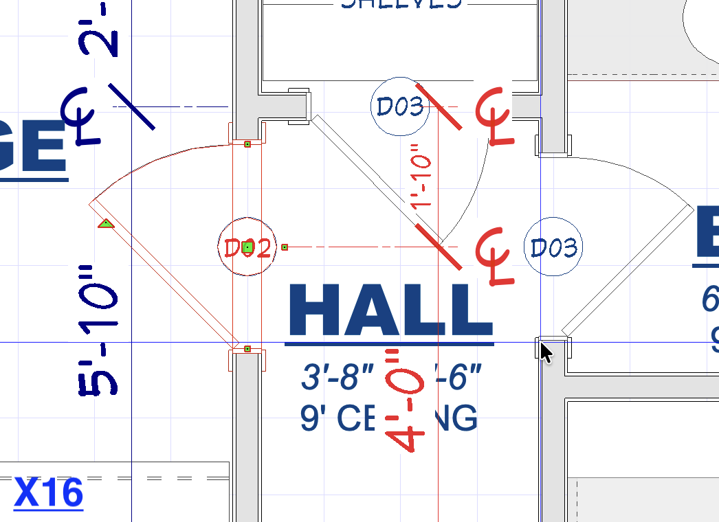

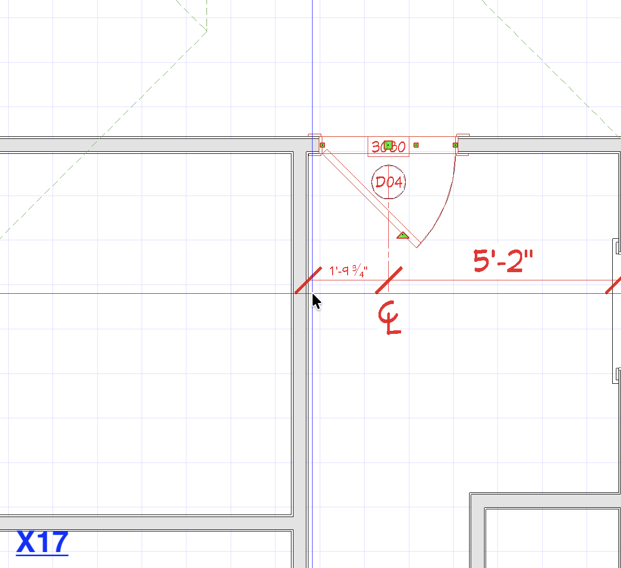

PitMan71 Posted January 6 Share Posted January 6 I just changed over to X17. When click on a door or opening, I noticed that my temp dimensions now go to face of wall. Before they were in the center of the wall. I know temp dimension settings are in the dimension style now. If there is a setting for this behavior, I am not finding it..... Note: when I click on a wall, the temp dimensions are to the center of interior wall so I am unsure what is different when click on a doorway. Thanks in advance. Link to comment Share on other sites More sharing options...

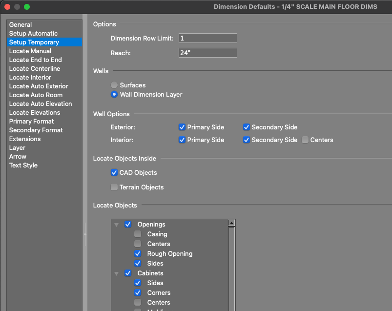

Chrisb222 Posted January 6 Share Posted January 6 19 minutes ago, PitMan71 said: If there is a setting for this behavior, I am not finding it Temporary dimensions now use settings in the current Dimension Default, under the Setup Temporary panel: 1 Link to comment Share on other sites More sharing options...
PitMan71 Posted January 7 Author Share Posted January 7 Yes. I have reviewed this panel in my dimension setup. BUT I can't find where I can set it to go to center of door to center of wall like it did in X16. As you can see the dim goes to the face of the wall to center. This even though under Wall Options Interior is set to Centers and nothing else. I can and will adapt. I just didn't know if there was a setting I was missing somewhere. Might be worth a support ticket to Chief to just ask. Thanks Link to comment Share on other sites More sharing options...
Chrisb222 Posted January 7 Share Posted January 7 39 minutes ago, PitMan71 said: Yes. I have reviewed this panel in my dimension setup. BUT I can't find where I can set it to go to center of door to center of wall like it did in X16. Ah. Excuse me for not experimenting before replying, I didn't check to see if there was indeed different functionality now. I couldn't recreate the old functionality you're trying to achieve in X17 either. It seems this might be a bug, otherwise why would Setup Temporary have a "Centers" button for wall locate? 1 Link to comment Share on other sites More sharing options...
