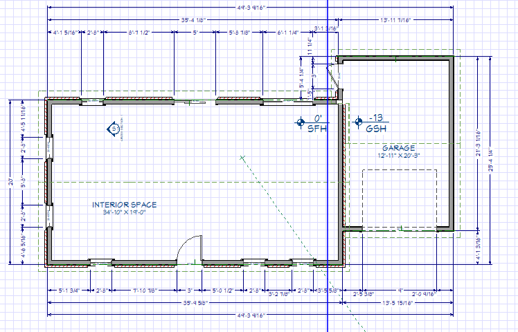

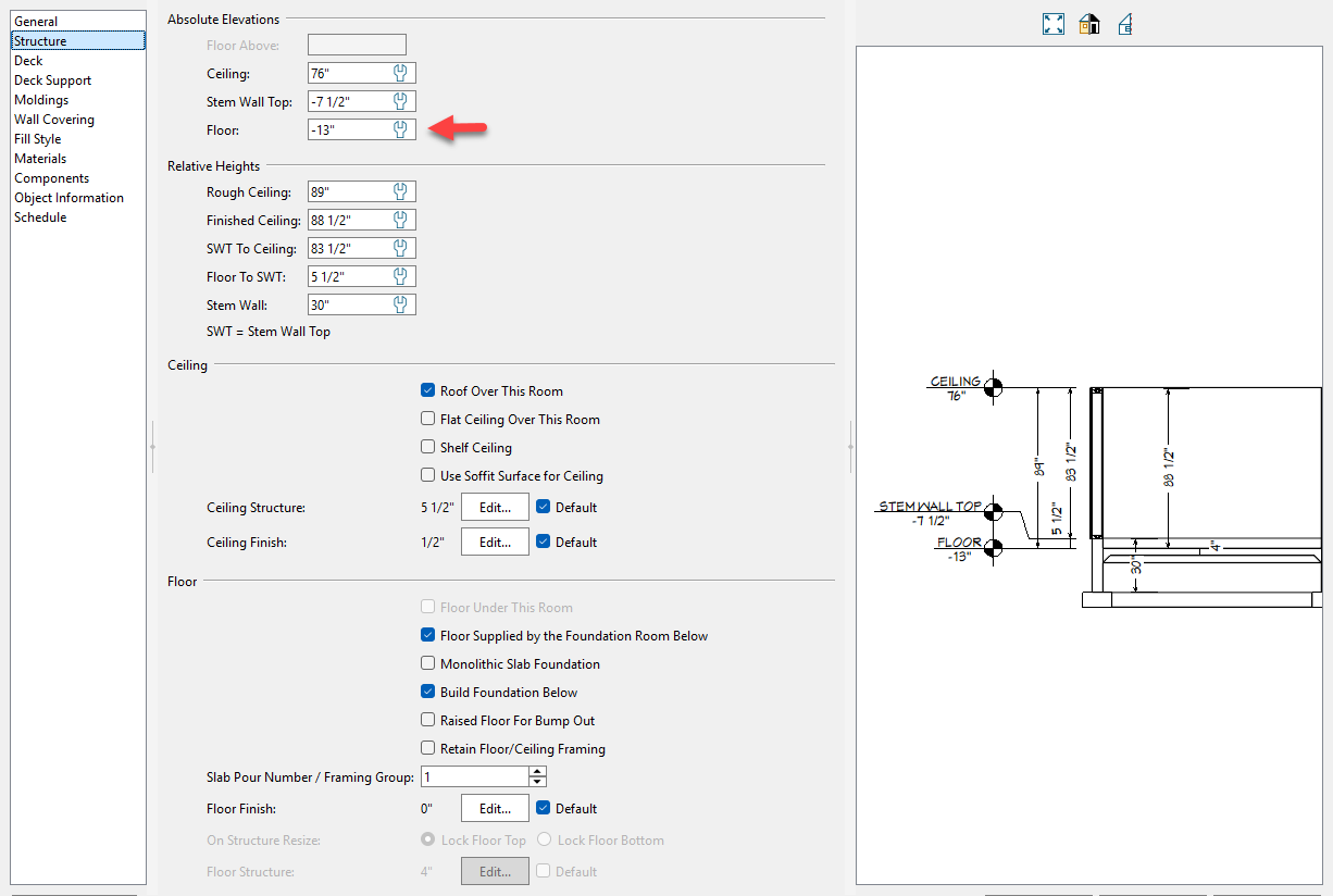

Doug_N Posted 2 hours ago Share Posted 2 hours ago This is an example of an as-built garage with the floor of the garage 1" above the grade and 13" below the floor of the house. v Link to comment Share on other sites More sharing options...
