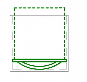

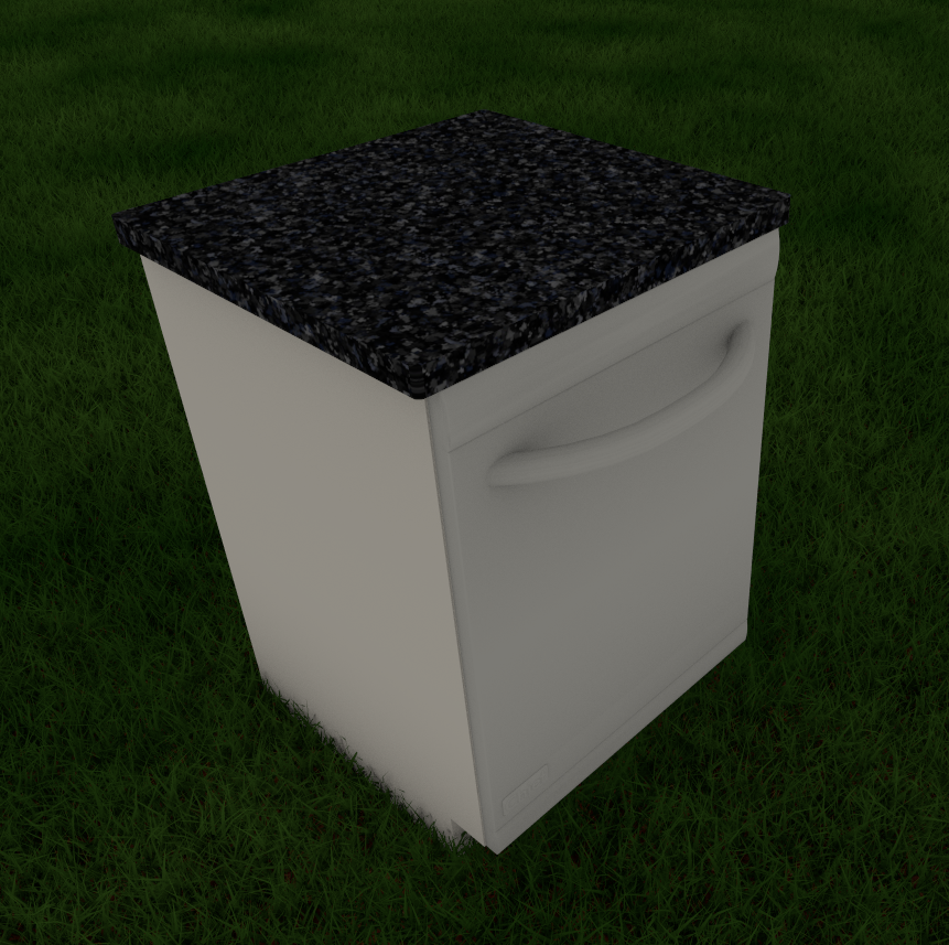

PhillipsPlans23 Posted January 5 Share Posted January 5 I have had this problem scence I installed X17. I called support and they were not much help. Has anyone else had this problem? Link to comment Share on other sites More sharing options...
DBCooper Posted January 5 Share Posted January 5 (edited) Are you using the new dishwashers from X17 (from your picture, it doesn't look like it)? If you just migrated your X16 libraries and never updated them, then you probably are not. You should make sure your libraries are up to date in X17. If you are using the new dishwashers, then the answer is that you don't insert them into cabinets anymore. Just place your dishwasher as a freestanding appliance next to your cabinets the same way you would a stove. You might then want to move it out from the wall to align it with either the front of the cabinet box or the door panels because by default they will be back against the wall. Edited January 5 by DBCooper 2 Link to comment Share on other sites More sharing options...
DBCooper Posted January 6 Share Posted January 6 Had another thought... Are you using the latest update (27.3.2.5)? If not, you should definitely install the latest update. I think they fixed a bug that was related to problems with dishwashers from legacy plans. If neither of these help, then you might want to post your plan or contact tech support again. 1 Link to comment Share on other sites More sharing options...
