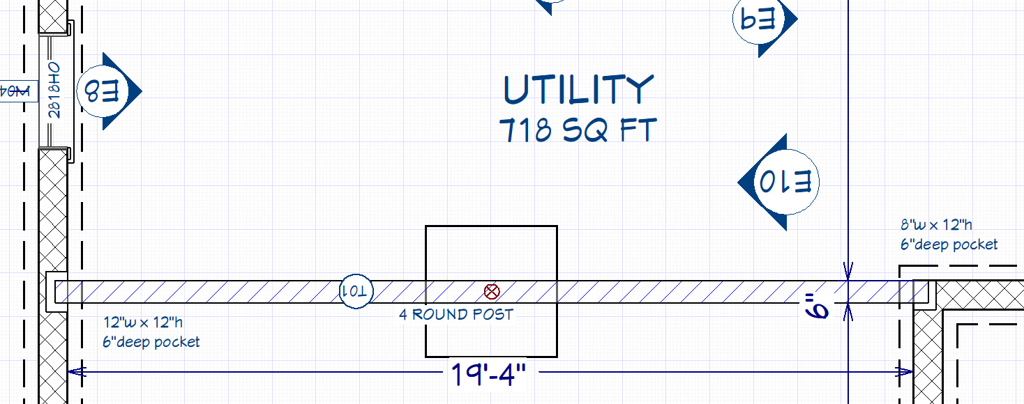

JiAngelo Posted December 22, 2025 Share Posted December 22, 2025 I'm still on X16. I have a house we designed that is across the street from another house in the same subdivision. Long story short, I drew this house upside down (front door facing north.) In plan view, I had rotated the drawing so that front door faced south and continued finishing the house plans. Whenever I created a new room, the label was upside down initially and I simply rotated it 180 degrees to match my plans orientation. Now that I'm finishing my layouts, I've noticed the callouts and framing labels are all upside down and there appears to be no way to rotate these. Am I missing something? Merry Christmas. Link to comment Share on other sites More sharing options...

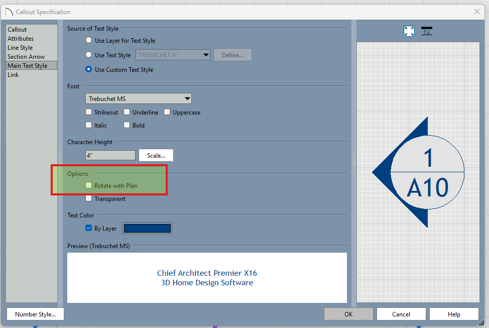

Solution robdyck Posted December 22, 2025 Solution Share Posted December 22, 2025 Callout / Main Text Style ...ensure Rotate with Plan is unchecked. You can edit the text style being used, or use a custom text style. 2 Link to comment Share on other sites More sharing options...

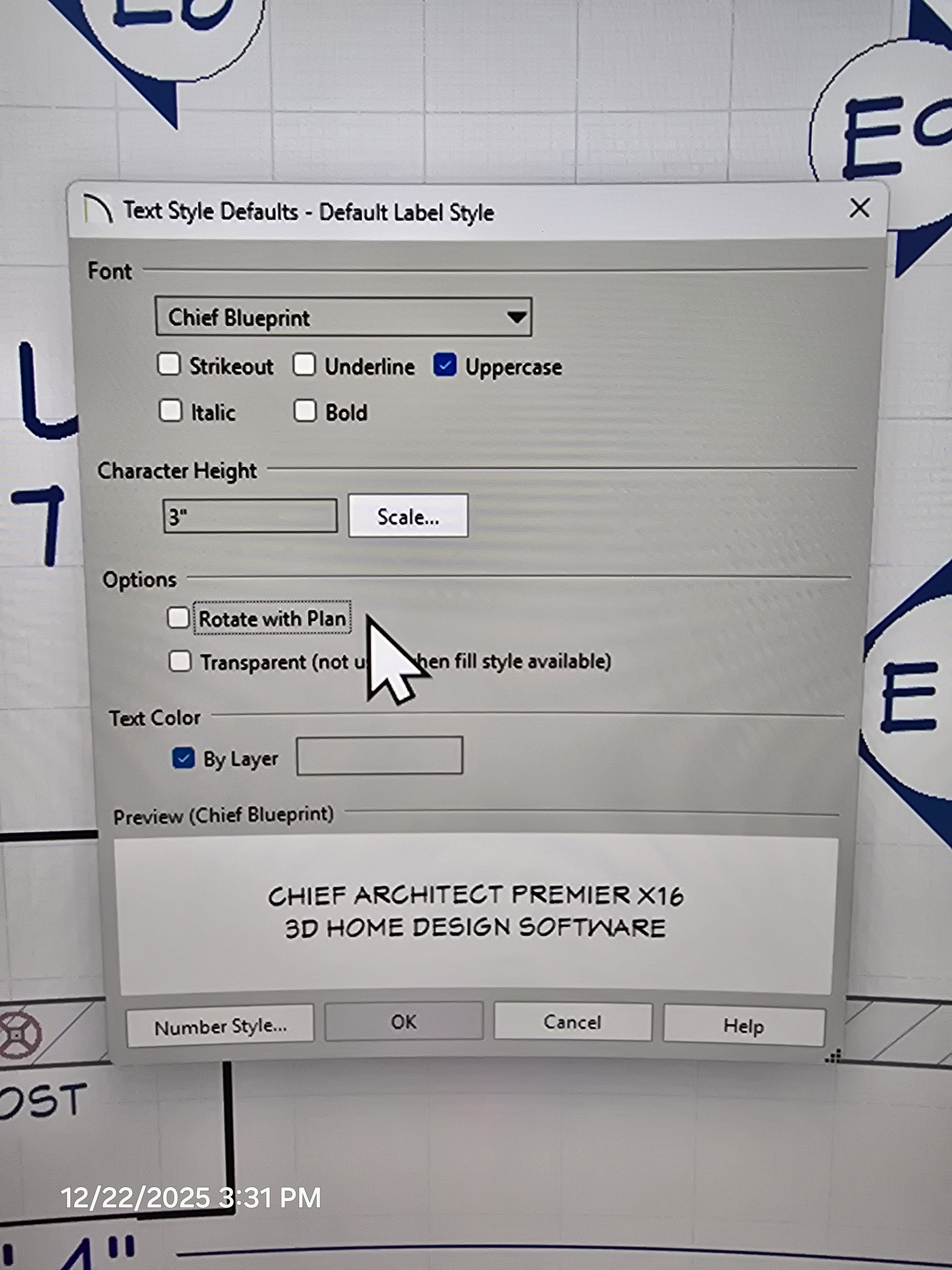

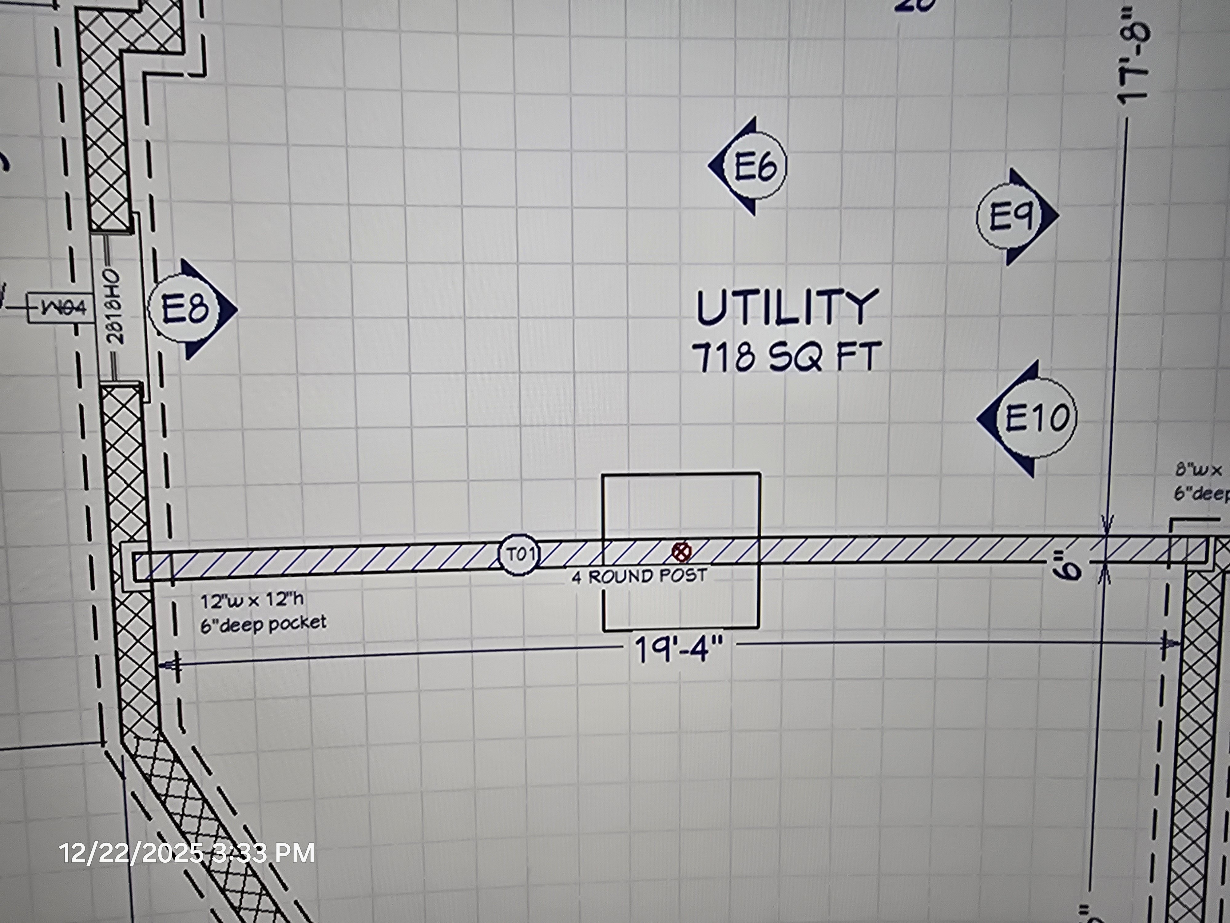

JiAngelo Posted December 22, 2025 Author Share Posted December 22, 2025 Thanks Rob. It was actually on the Layer Text Style for camera layer and on Framing, Labels for the beams. Thanks again, I'd have never found it. Merry Christmas. 1 Link to comment Share on other sites More sharing options...
