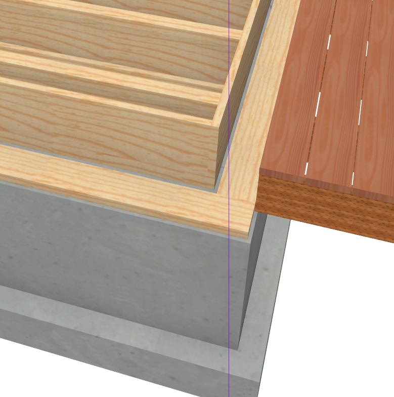

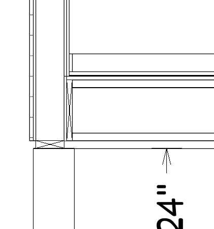

Artisan_TH Posted December 4, 2025 Share Posted December 4, 2025 Setting to land wall on top of floor See pic Link to comment Share on other sites More sharing options...

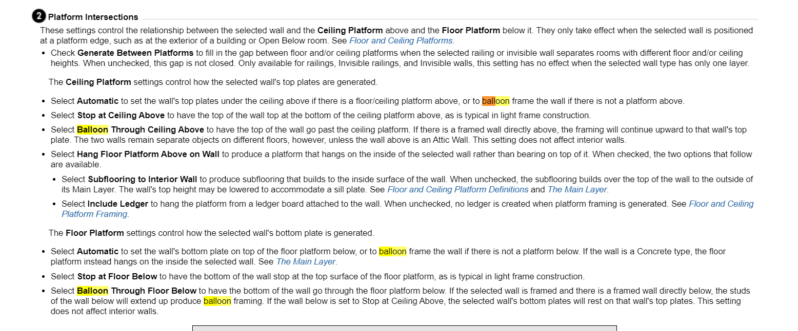

SHCanada2 Posted December 5, 2025 Share Posted December 5, 2025 did you check the wall settings vs the OOTB template plan ...almost looks like balloon framing with two different wall types. you could try checking that: Link to comment Share on other sites More sharing options...
